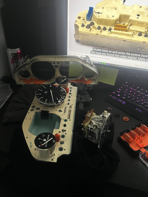

            Yea that was my exact plan.
            unfortunate thing is I cant sell off the coilovers or the subframes right now because the crashed car needs to remain a roller for the time being, unless I could somehow find some blown suspension and front strut assemblies for dirt cheap or out of a trash can lol.
            this weekend going to try and finish swapping the interior and wiring harnesses (new cars harnesses have some weird splices, eek. also not all the electronics work, so rather than diagnosis why not just take it all from the first car cuz I know it'll all work. Just my thoughts...) then hopefully overhaul the sunroof.
            other than that -
            fixed the odo gears after class the other day

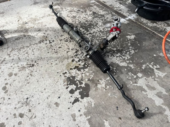

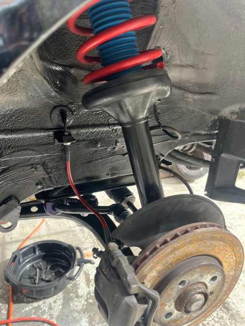

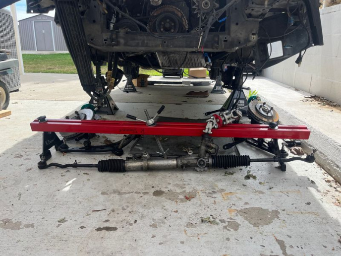

                        couple updates for yall
                        got the front and rear suspension swapped over
                        steering rack, lines, reservoir swapped
                        got the stainless steel brake lines in
ID:	10157925 Click image for larger version
ID:	10157926 Click image for larger version
