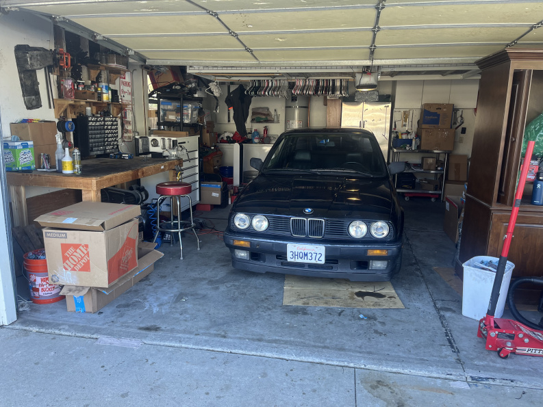

          Not having a garage at my finger tips (or in general) anymore FUCKING SUCKS... I don't know if I mention this already in an earlier post or not, but ,my family had to sell our house, and we all split up and are living in different places/states, this whole crash fiasco happened THE DAY BEFORE we had to be fully moved out.
          pic of the old garage set up :(
