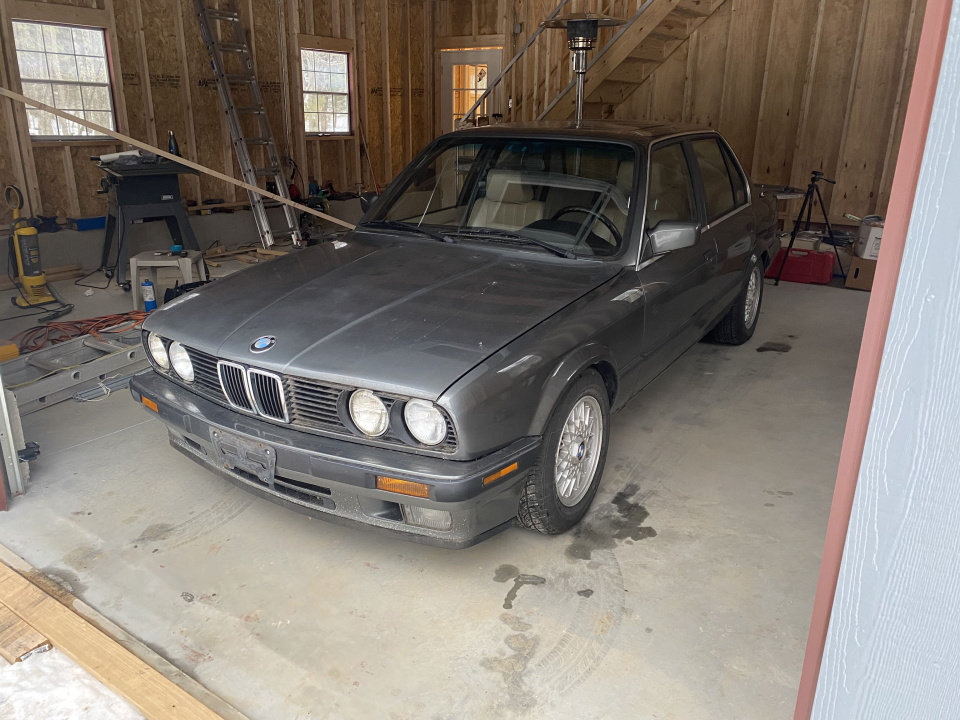

    After moving back home from grad school, I got bored of the LinkedIn 9-5 job search, and needed to find an out. One day, I wandered out to the barn, and there it was in all of its rusty dusty glory: my beloved E30.
    After giving it some gas and starting it up, it was immediately apparent why I had forgotten about this car in the first place. The engine knock was horrific. I never did figure out what the noise was, but there was only one way to find out.

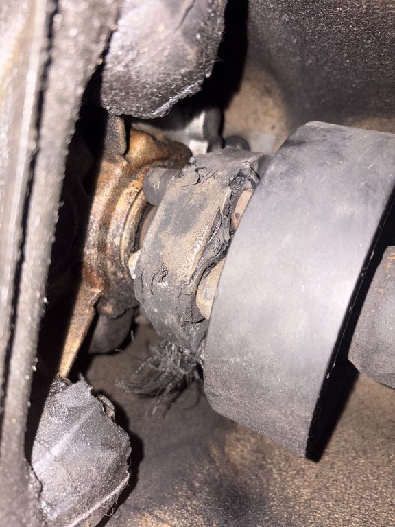

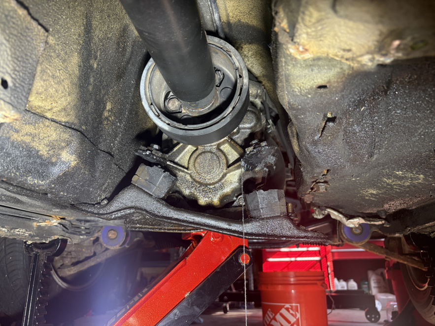

    After pulling the transmission brace, I was greeted with yet another pair of melted mounts! It’s a miracle the entire driveline hadn’t dropped out on its own accord previously. Also for some reason somebody had left a yoyo on top of my transmission?? (String shown in the pic below)

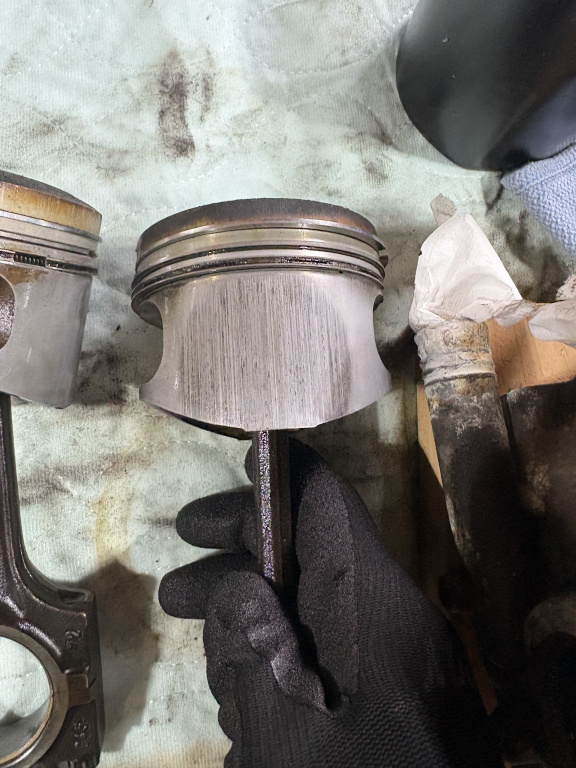

    From there, it was smooth sailing. Take the head off, strip the block down, and discover… pretty scored up pistons and cylinder wall. We found the culprit! It was piston slap all along. Unfortunately, that meant that I’d need to get some machining done, along with oversized pistons.
    Yeesh…

      That piston looks absolutely minty dude..
        Shoot, maybe I should have just shined em up and ran it would have been a lot less expensive. Jokes aside, I'm excited to show what I have in the works now. Cooking up some good updates, just tough with living in a new city and new job.

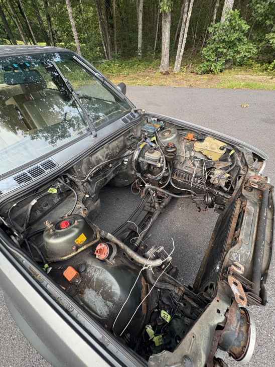

            Getting into the technical side of things, I started cleaning out the entire engine bay, because what good would a shiny new engine be if it was sitting in a dirty, rusty engine bay?
            It was hard to figure out where to start. Everything was on top of something else; bolts were rusty, connectors were stuck with the strength of 10 strongmen while also being as fragile as an ancient ceramic vase used to store dates (or perhaps wine ).
            I decided to tackle the driver's side headlight, as it was the easiest thing to get to (and the AC compressor was not budging yet). I found that the headlight wiring harness must have corroded pretty badly previously, as it was repaired by soldering the ground line onto a wire with a fork connector, which was then bolted to the rear driver's side hood bracket. Maybe this was the source of the incessant buzzing that played over the radio when I turned my headlights on??? Gotta respect the engineering; however, I’m going to replace the permanent temporary fix with a true permanent fix (as a child I always wanted to grow up to be a previous owner who left the car BETTER than he found it).
            From there, it started getting easier. The AC condenser and passenger headlight came out like butter. With a lot of Kroil and a big wrench and mallet, the AC compressor broke free. Next came the fenders and front valance. At this point, the engine bay was already looking a little less cluttered (and unfortunately the rust issue was progressively creeping out...).
            The ABS unit was scary. The screw securing the plastic cover felt super soft, and I thought it was going to strip even using the right allen key. Most of the nuts on the brake lines were stuck tight, and I didn't feel confident without having the right wrench. I sprayed everything down with penetrating oil in response and moved on.
            The airbag sensors, power steering pump and reservoir, and charcoal canister were all easy enough. After removing the AC lines and wiring, the passenger side was free!! I gave everything a quick vacuum to tidy it up and clear out some of the old acorns that some temporary residents had left. Needing some motivation, I sat in the driver's seat to visualize the end product and instinctively pressed the clutch in. The pop of my clutch slave cylinder exploding was accompanied by the splattering of all of my brake/clutch fluid ejecting over the floor of the garage.
            Whoops.
            On the bright side, the ABS unit came out pretty easily after that. Flared end wrenches were really helpful. The brake booster and master cylinder came out so easily too. I definitely recommend some extensions and swivels, especially if there is still an engine in the car.
            Fast forwarding as I’m getting tired of writing and the rest was all pretty self explanatory: The original rubber brake lines were shot and need to be replaced, one of the brake booster to ABS lines needs to be replaced, there was about a pound of rat poop and a rats nest under the cowl next to the AC fan(hey maybe thats why my car smelled so bad), there was a shop towel zip tied to the wiring harness coming off the fuse box/hood latch cable (hopefully not structural???), and I got the wiring harness free from the front of the bay. I tore off all the rubber sound deadening/heat shielding panels at the firewall and discovered original paint in mint condition!!! Even better was 0 rust under the fuse box.
            Finally, I yanked out the cruise control and airbag control harness, and with that, the engine bay was pretty much empty!!! The airbag module was cake, just dropped the kick panel (already down from the brake booster), took down the body ECU, and then pulled the SRS module and the airbag sensor wires.
