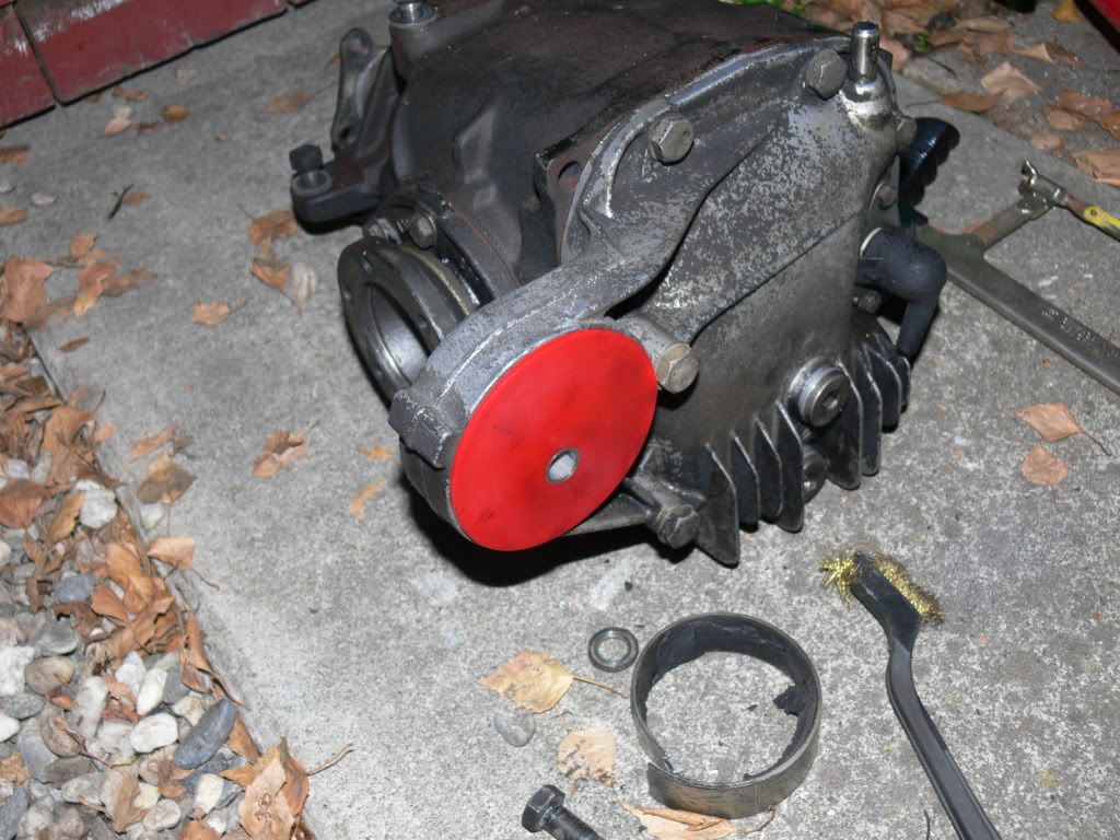

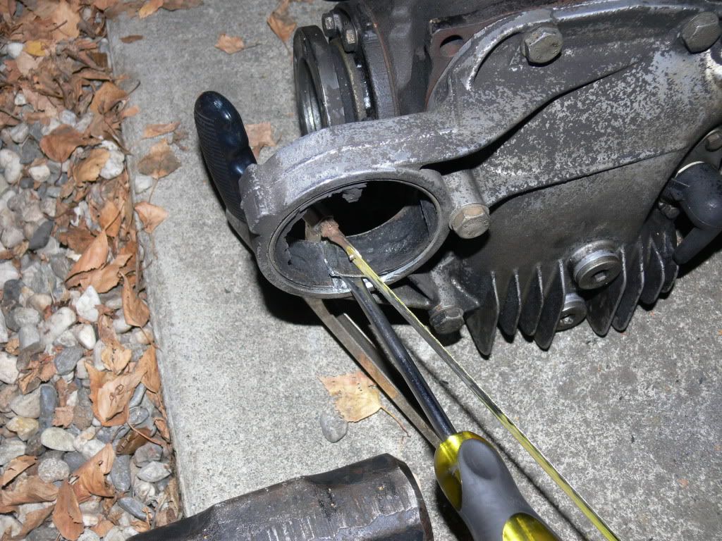

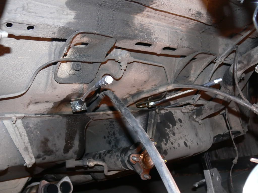

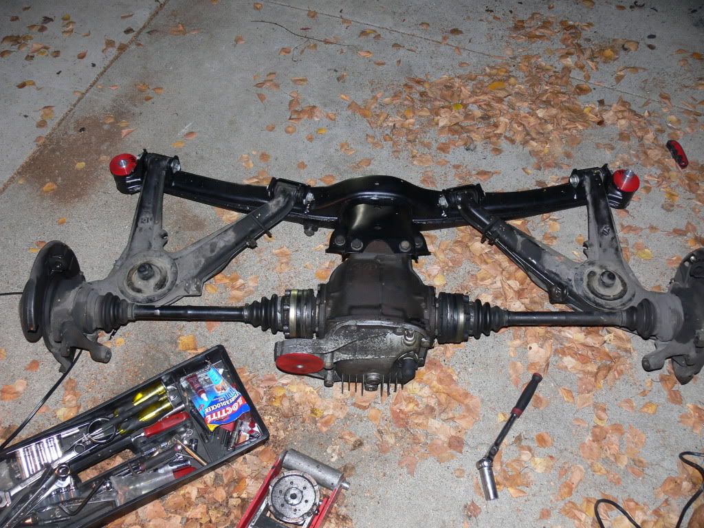

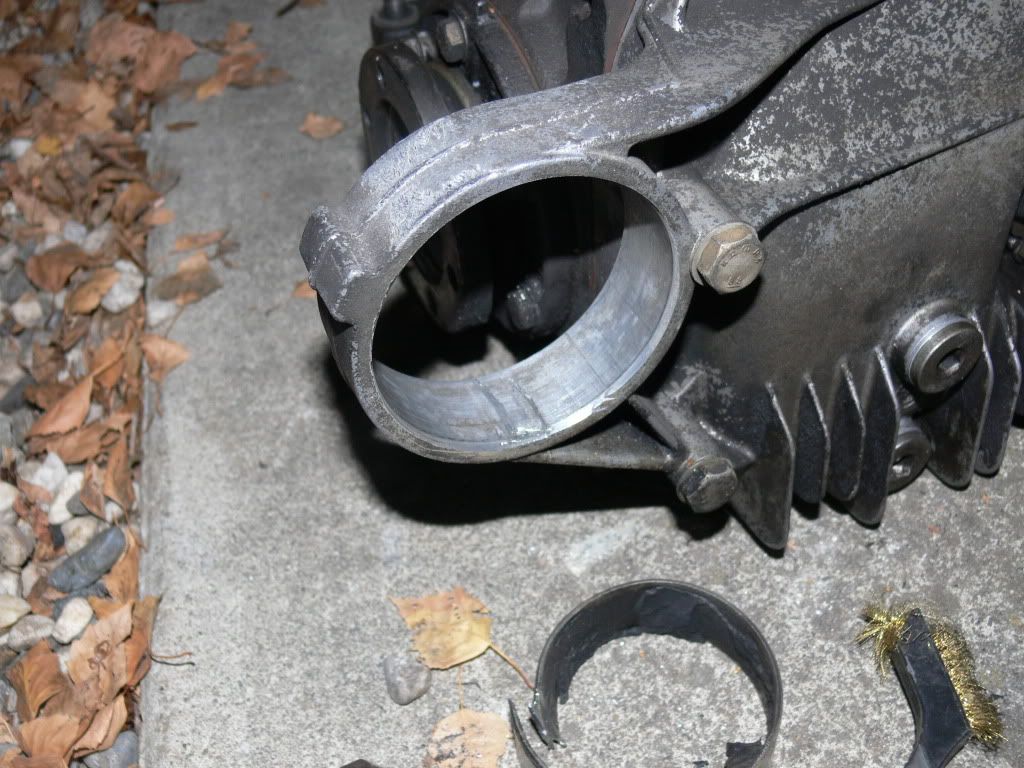

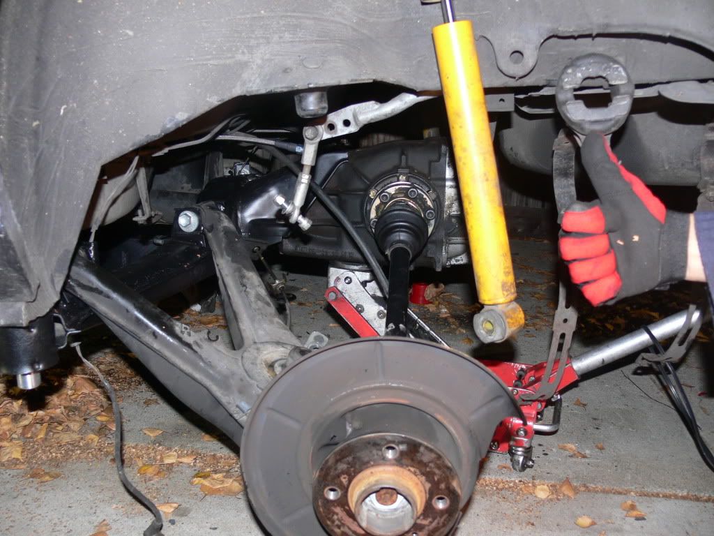

                  In order to get the bushing's leftover metal ring out of the diff, I threaded a hack saw through it, cut it and pried it up
                  Brush out the inner race--it's a little scored up from the hack saw but it'll do fine
                  Poly bushings go in nice and easy

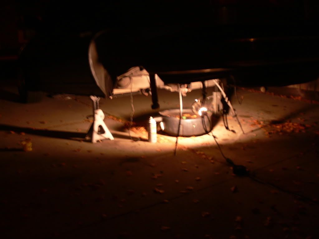

                  Oh and because I know some of you get a kick out of it, here's my workspace for tonight ;)

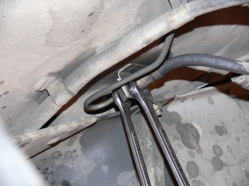

                  All brake lines are 14s on one side and 11s on the other. Pbblaster is your friend, especially on these
                  That's better :)

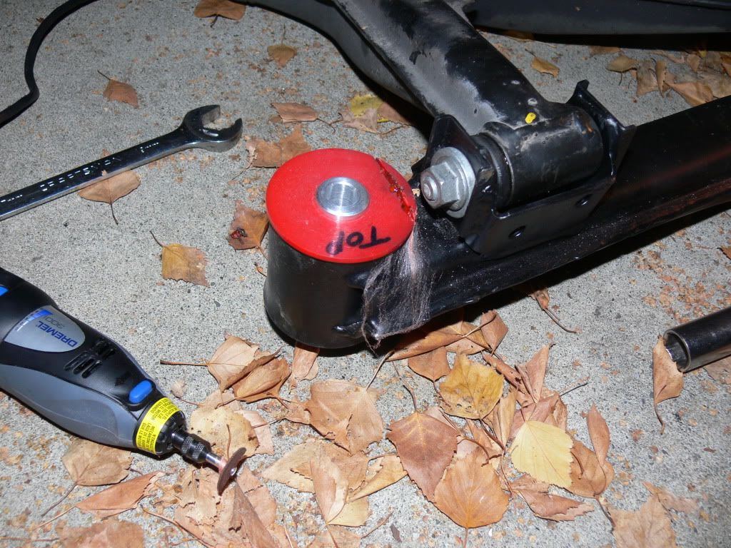

                  Poly does some weird stuff when you take a dremel to it

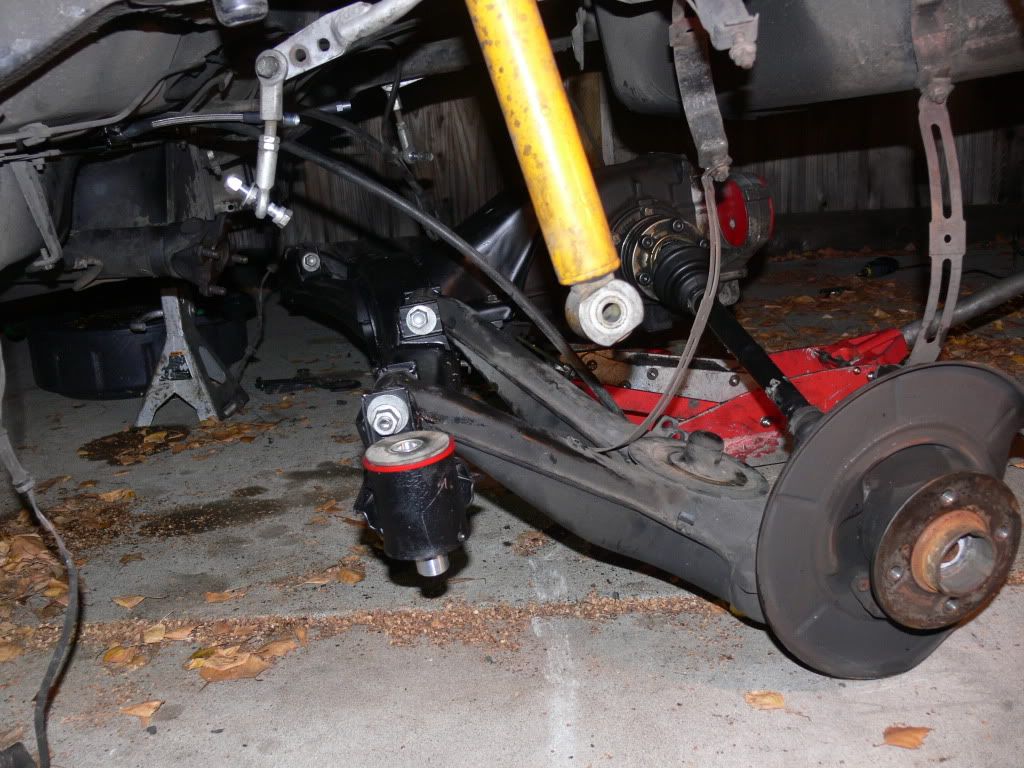

                  Everything all bolted up
                  Lifting it up
                  Fit in place! Done for tonight. Will pick up again tomorrow.
                  Side note: the bottoms of the subframe bushings fall out, so they're not installed in any of the pictures. I put 'em in when I bolted everything up.

                          To unhook the ebrake cables. I didn't want to deal with routing them through the chassis while I had the subframe in the air, there's already enough to worry about. So I just disconnected em at the ebrake. I'd done it before, pretty easy.
