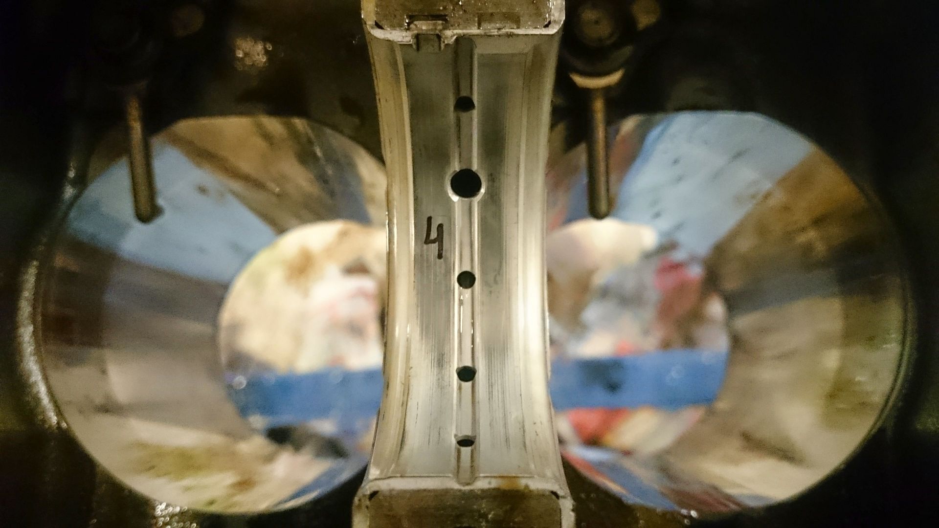

              Here is how each main bearing looked. I'm no engine expert, but there was only significant ware on the number 1 bearing.

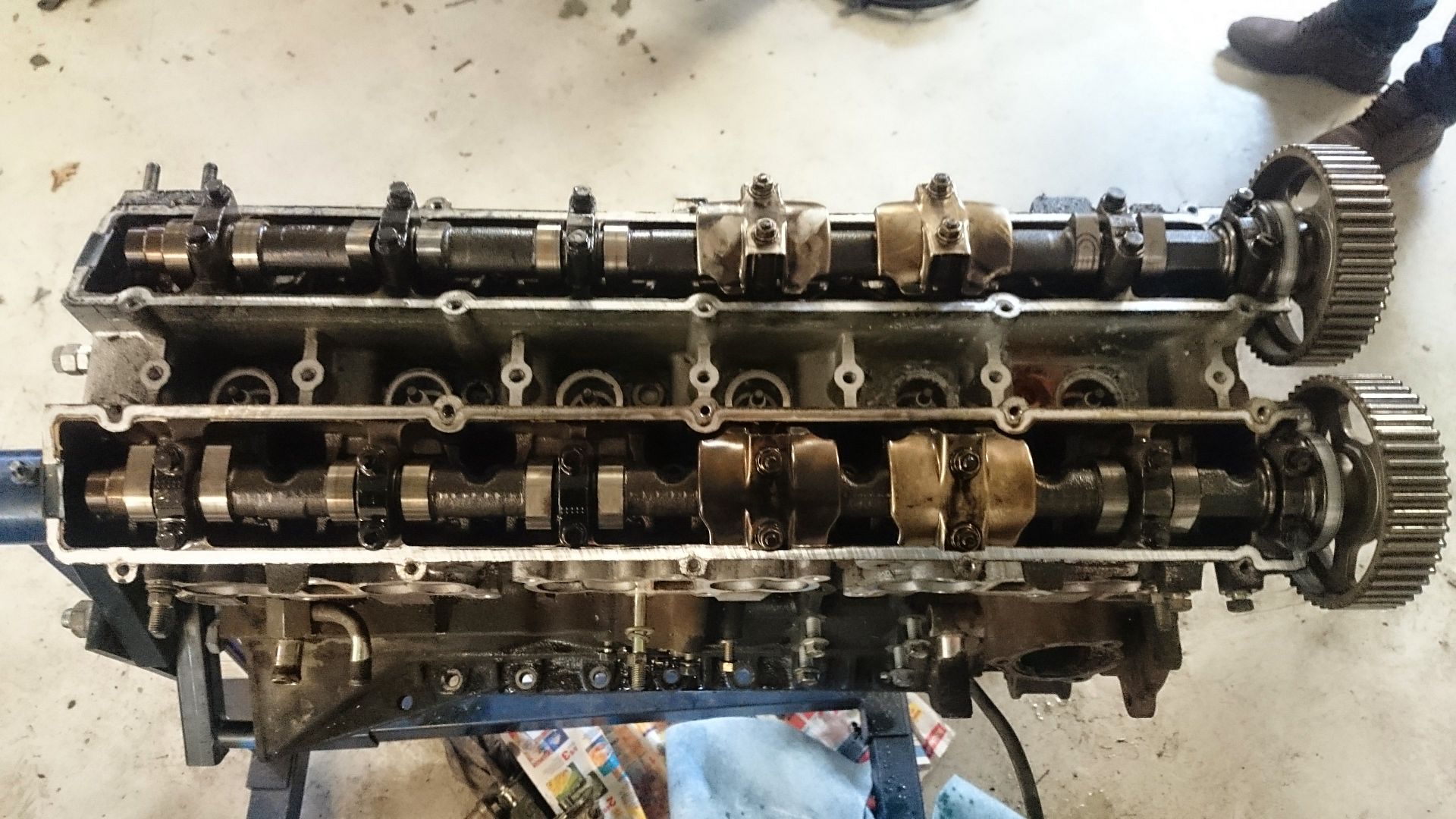

              Started to take apart the head and placed the parts in order on the bench. Rest is up to the engine builder to take apart.
