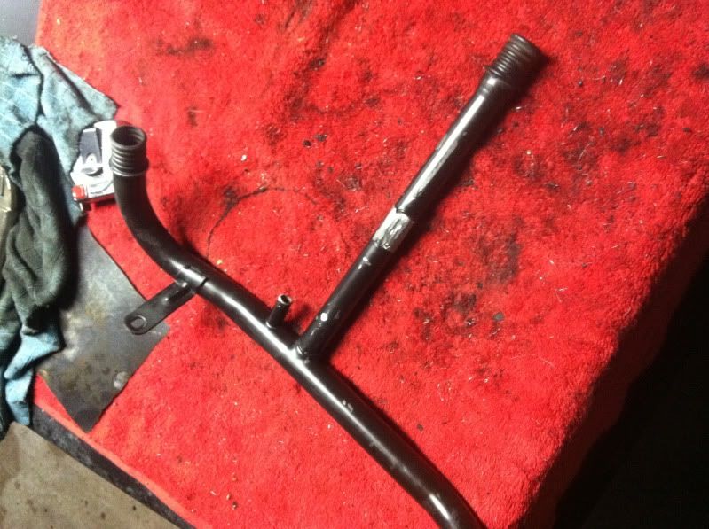

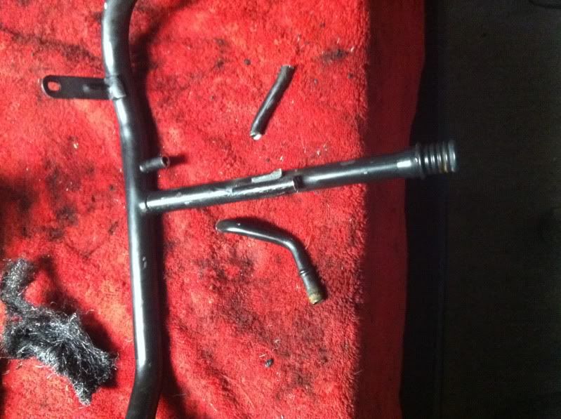

        Then I started on the modification to the spider hose. I am removing the tube that goes to the throttle body heater, as that entire loop has been removed from my coolant system.
        After the first couple of cuts.
        I wasnt too worried about removing the metal piece on the t hose, as it wont be visible when the car is assembled, and I didnt want to grind too far and damage the integrity of the tube that I wanted to keep. A fresh coat of black paint should hide it pretty well.
        After I finished grinding it I handed it to my trusty garage buddy to clean all the grime and grease off of it.
        He is the only one who never hesitates to join me in the garage, no matter what time of day it is. Haha
        I didnt remove the tube completely, as I still don't know how I want to close it off. I might remove it flush and weld a piece of metal over the opening, or I might crush, bend and heat the exposed tube shut. Decisions, decisions.

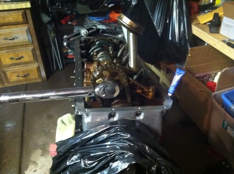

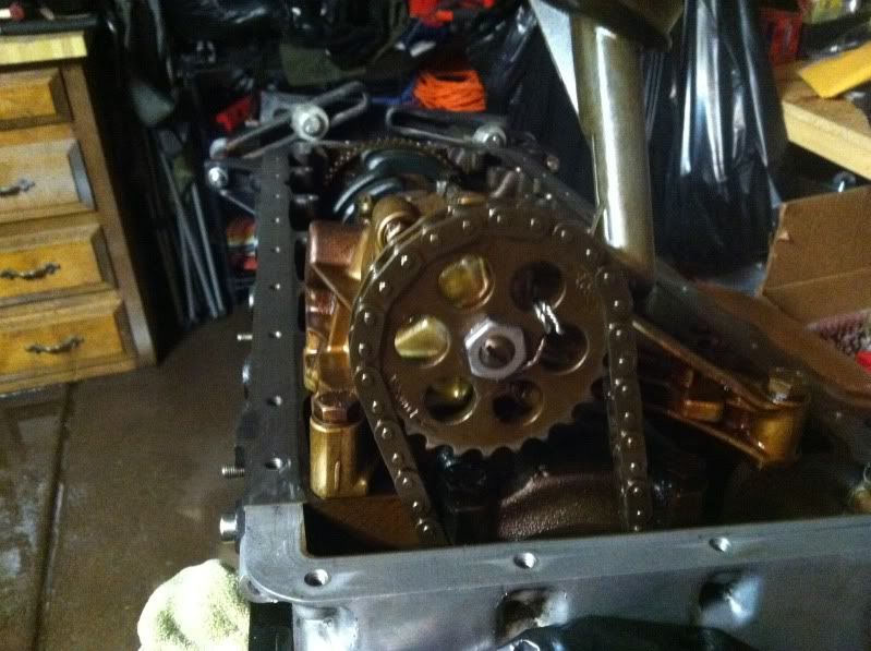

              Safety nut for the oil pump came in the mail a few days ago, and thats what was keeping me from reattaching the oil pan and flipping the engine back up.
              A quick search found that 17 ft/lbs is the necesary torque to properly install this nut on all M5x/S5x variants. This nut is reverse thread.
              Remember kids, a torque wrench and red threadlocker are your friends!
              All done. That nut is not going anywhere. I replaced the oil pump pickup tube gasket as well.

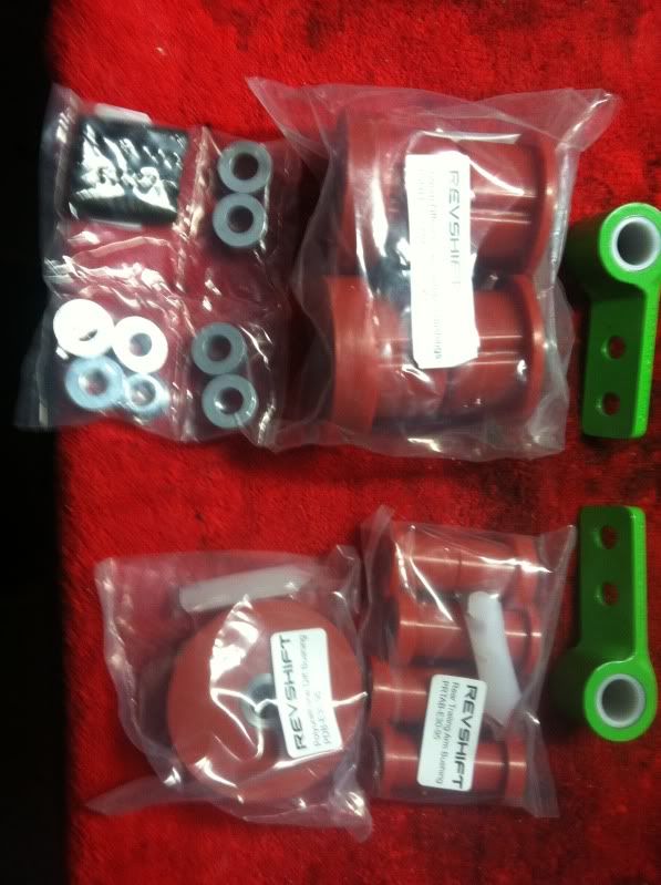

                    Ermahgerd, I just made a huge purchase.
                    When it arrives I will post pictures for your enjoyment.

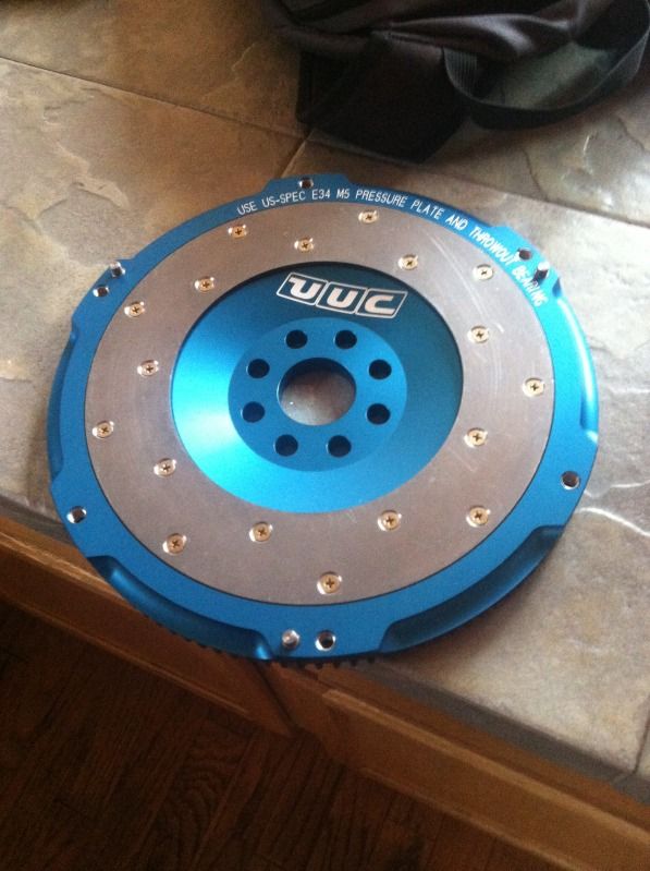

                        Here is the real deal. I worked many hours to purchase this amazing piece of engineering. Easily the most exciting part I will install the whole rebuild. Too bad no one will see it, because it is a thing of beauty.
                        Drum roll please..........
                        Badum! All 8.5 lbs of goodness.

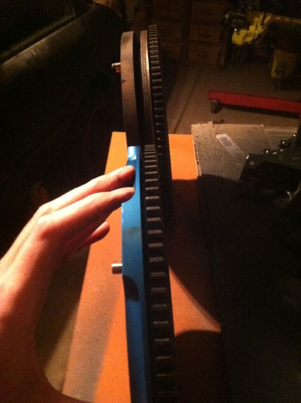

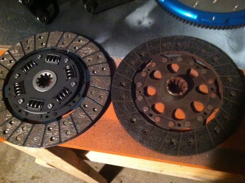

                        I bought the whole shebang. UUC E34 M5 adapted clutch kit with the 8.5 lb flywheel to be squished between my S52 and the ZF. Super excited about this set and its performance capabilities.
                        Badass clutch disc on the left, tired old piece on the right.
                        Side by side comparison of the old and the new. less than 1/3rd the weight. In fact, the entire new setup (meaning everything that will be rotating with the engine) weighs lbs less than just the flywheel from the old setup.
                        To all the naysayers who are going to naysay, idle has already been increased to 800 rpms with the TRM tune I have, to compensate for the decrease in rotational mass of the flywheel.
                        Legit packaging, rapid shipping times and very well written directions made my business with UUC a pleasent one.

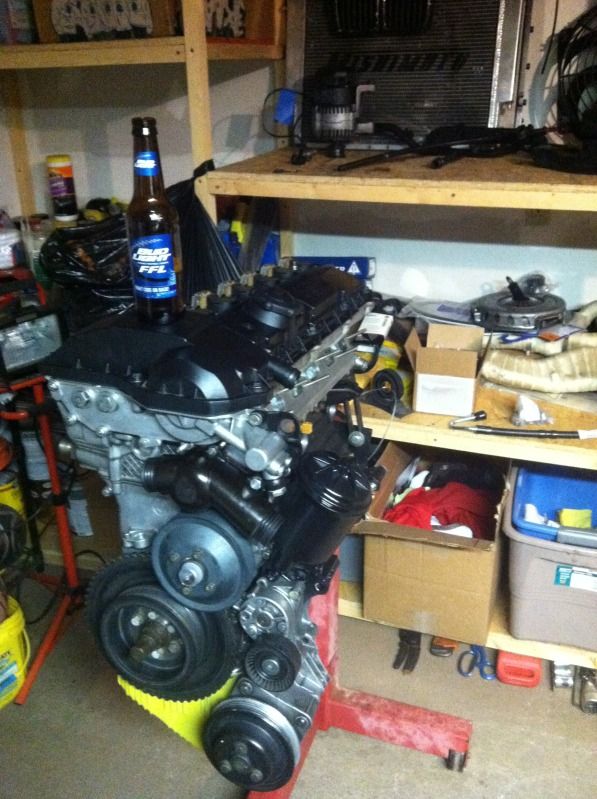

                        Here is an updated pic of the S52. Yes the oil pan is yellow. Because Racecar is my official answer. Plus it will be easier to spot oil leaks in the future.

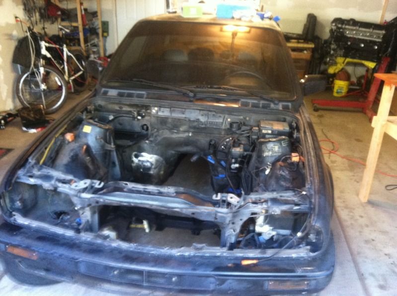

                            The engine bay is slowly getting emptied. I still have to figure out how stripped I want it to be, and exactly what to do to make it look all smooth and sexy-fied.

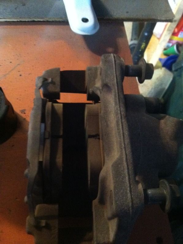

                            All of the revmatched downshifting I have been doing is really paying off. Not to mention that these are E36 M3 brakes, and my E30 is pretty light, relatively.
                            I havent replaced these brakes since I bought this beast back in 2009. I honestly cannot believe that they are still this fresh.
                            Thats all for now. Finals are this upcoming week so not much will get done here these next couple of days, but for winter break I am going to put the pedal to the metal and get a lot of work done.

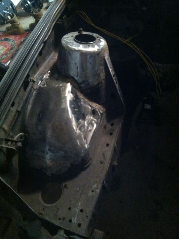

                              The engine bay shaving process has started!
                              Still on the hunt for a ZF as well.
                              I guess I pulled the subframe at the right time. This is the drivers side.
                              Thankfully I have another front subframe that isnt compromised that I can upgrade with my IE plates and more welds.

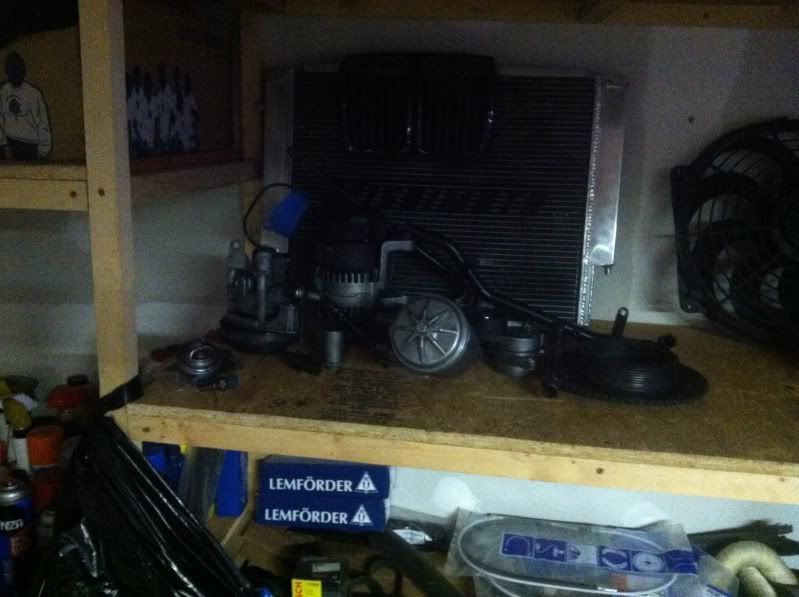

                              More work tonight. The 'clean and ready to reinstall' shelf of parts is getting more and more full. Still lots of parts to acquire before the winter is over.

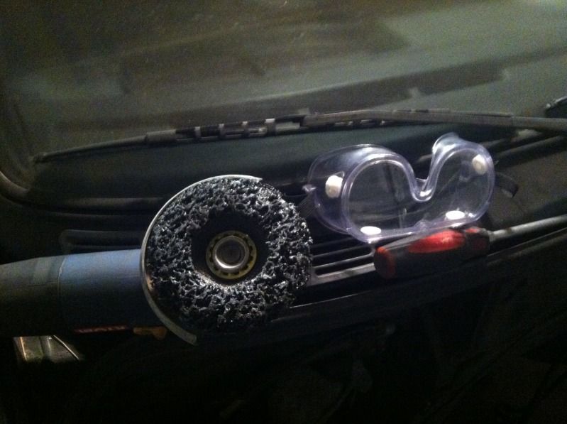

                                Removed all of the brackets with the grinder, and went at the paint with the grinder again, equipped with the paint removing disc I found at Home Depot. A lil expensive but it is well worth the money. You dont risk damaging the metal and it strips the paint away very quickly.
                                Heres what the paint removal disk looks like, in case you are curious.
