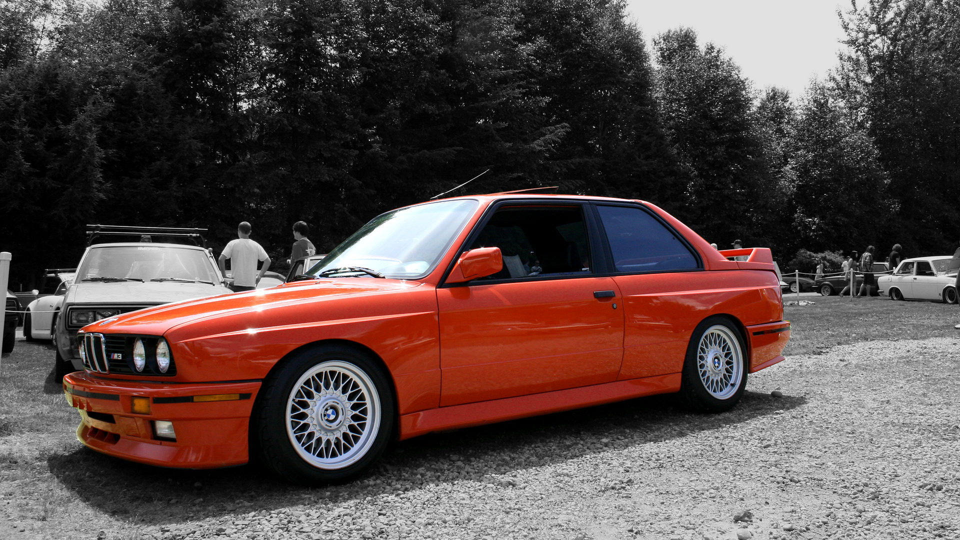

    Haven't made many changes to the car of late, just been driving and enjoying it every chance I get!
    I just cleaned it up a bit and yesterday I did some simple maintenance (plugs/cap/rotor) and it's running better than ever. I still kiss the redline every time I drive it!
    Car show season is here, so I'll be doing another paint correction detail in the next week or so.
    From last year's picnic:

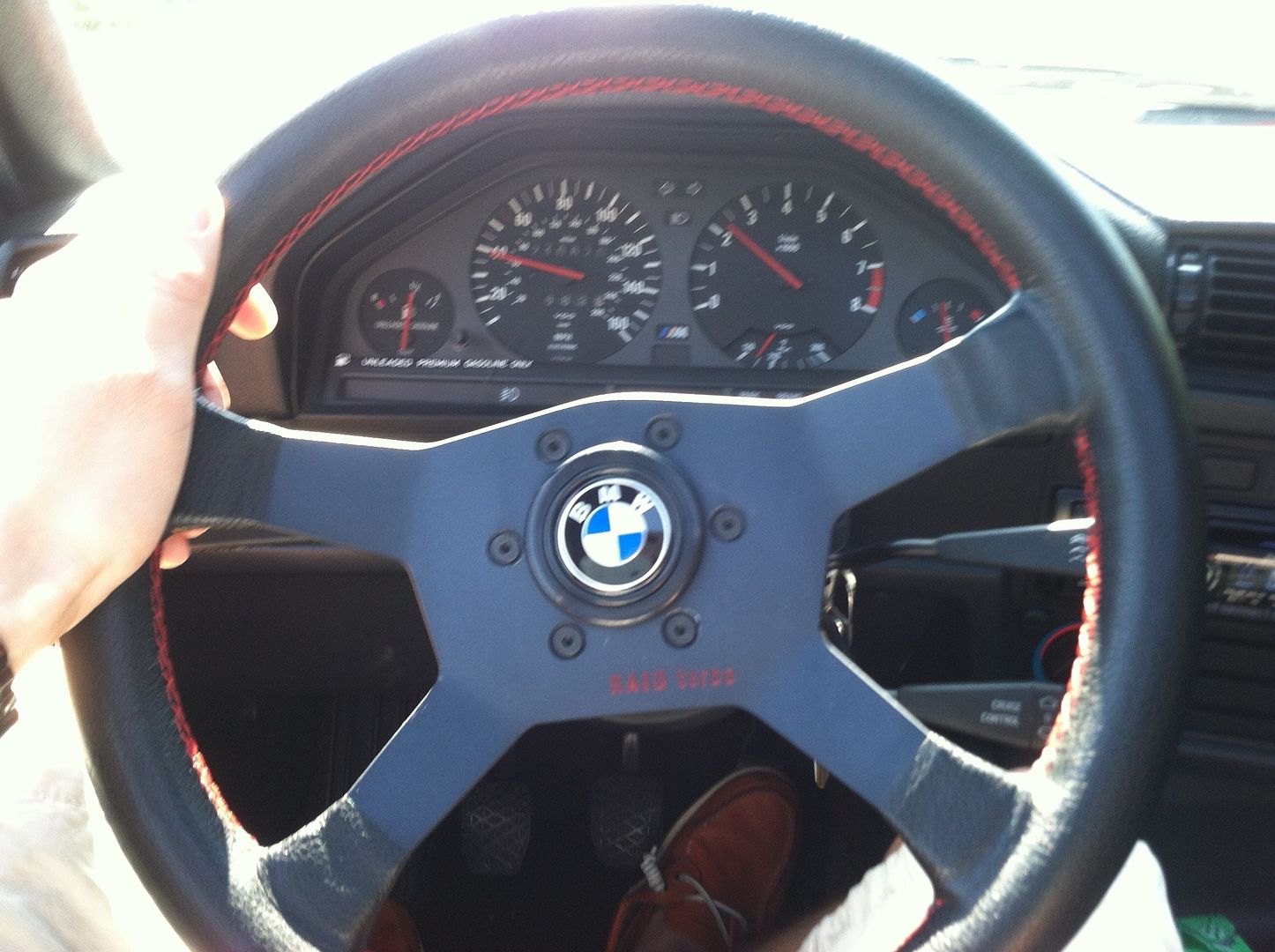

    Added a Raid Turbo steering wheel, black with red stitching.

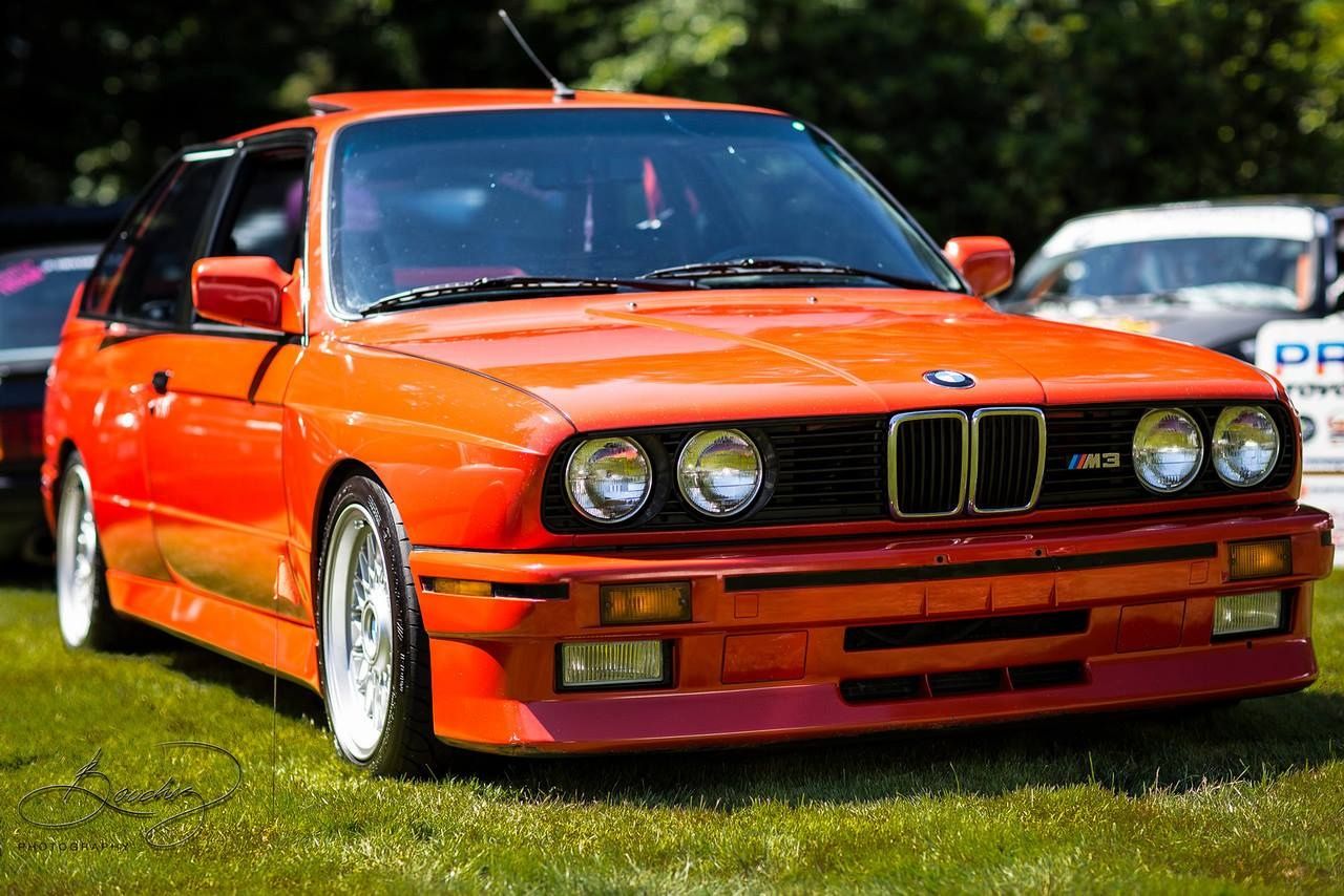

    From last weekend after a spirited drive, chasing an E93 M3 through the twisties:

      Did you get the wheel from that steering wheel whore Abe?

        Looking very pretty in the sun.

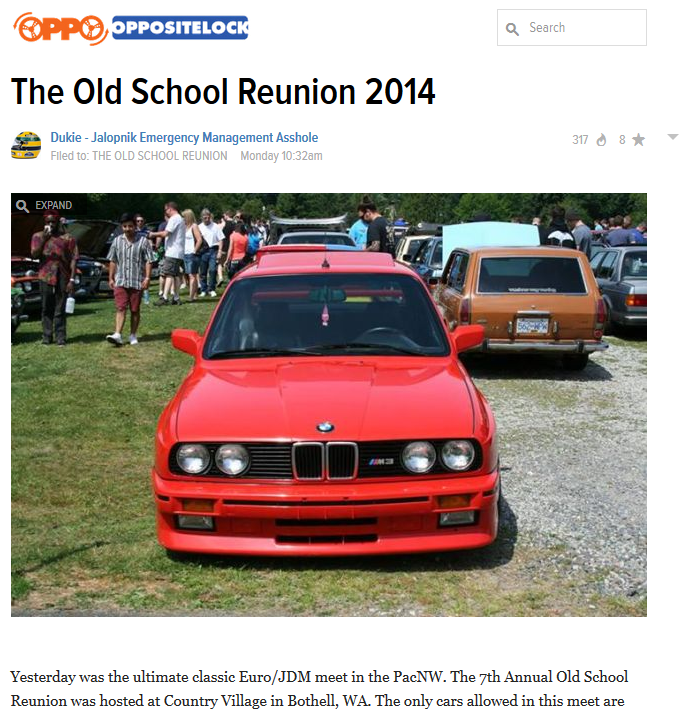

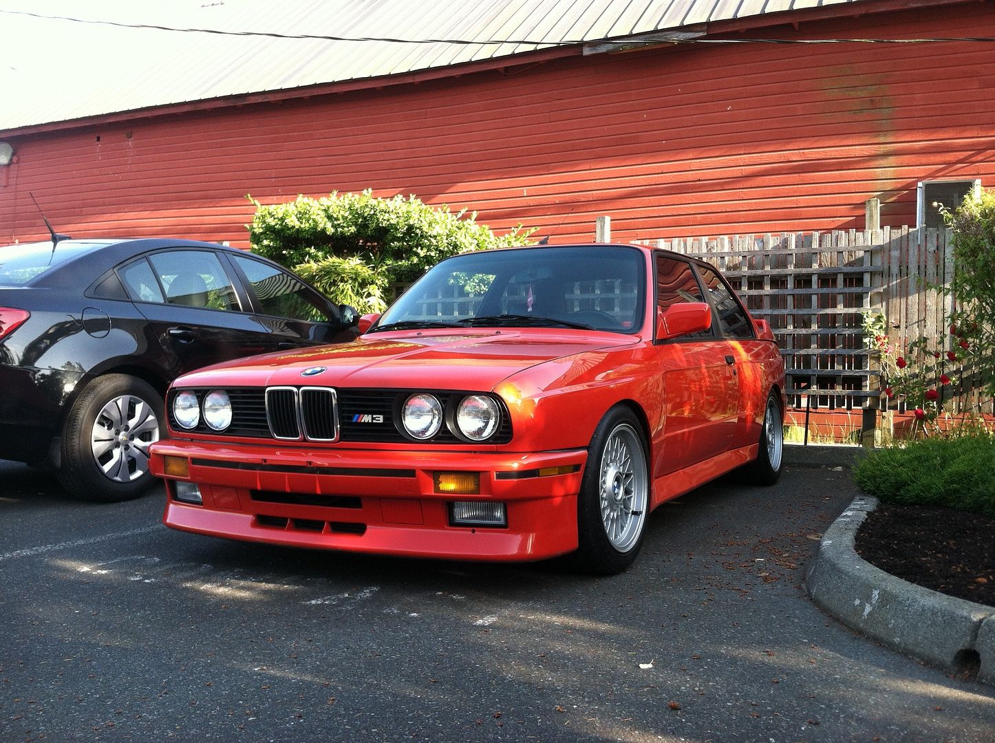

            Got a few nice pictures of my car from the Old School Reunion last weekend.
            And got some love on one of the Jalopnik Oppositelock sub-blogs:
            From cars to motorcycles, Jalopnik is your go-to site covering everything with an engine—including automotive news, buying guides, and expert commentary from our staff.
