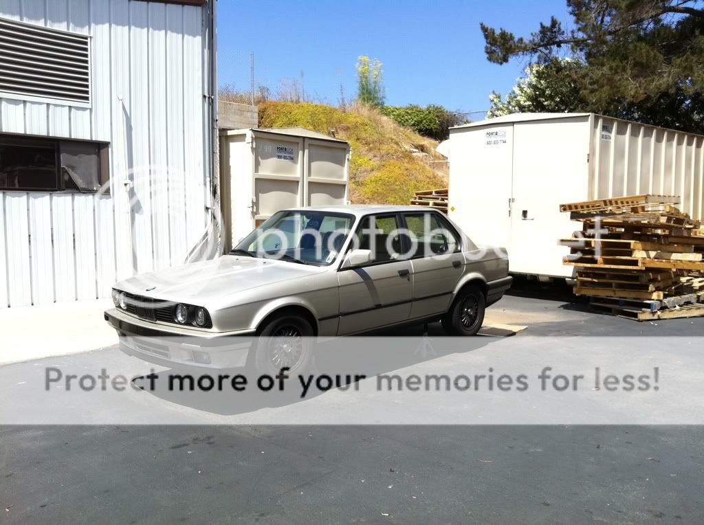

                #202
                Got my exhaust on order from summit/eBay. I got 10 assorted mandrel bends from eBay, and straight pipe/mufflers from Summit. All of which are 3". I got the turbo muffler, and a long glasspack. If it's too loud I'll order some more muffler, but for now I think I'll be fine. I also got a flex pipe, and other misc hoses for BOV/wastegate/boost controller. I ordered a new boost controller as well.
                Ohh yeah, and I got new headbolts, headgasket, throttle body gasket (mine was leaking), and oil pan gasket. I'm sure there's some other things that I'm forgetting, but I'll take LOTS of pics during the installation. I only have a few days to get this thing up and running, so I'll have to work pretty fast. I'm excited ;)
                Here's a picture because I hate when projects get updated with just words....
