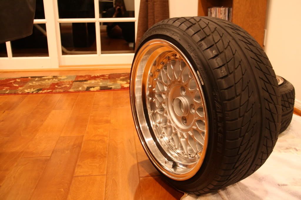

                Got some of these
                So I made one of these to fit them (fender roller!!!)

                Rolled the drivers side fenders today. It worked pretty well! Test fitted the wheels. They are 16x9 et20. I am using a 10mm spacer up front and an 8mm spacer in the rear. Converting the front to studs, and the rear will use extended lugs for now.
                Will have more pics tomorrow ;)
                  Originally posted by jaywood View Post
                  Got some of these
                  i just got the hugest fucking boner from this photo.
                  so looking forward to it.
                  i hope that you made sure those skate wheels don't have flat spots ;D
                              Got some of these
                              Real or reps?
                              Do Work www.sbeuroclub.com
                                Originally posted by rbartongrimley View Post
                                Real or reps?
                                Both... They are REAL ESM 002s and they are REPLICA BBS RS. :D
