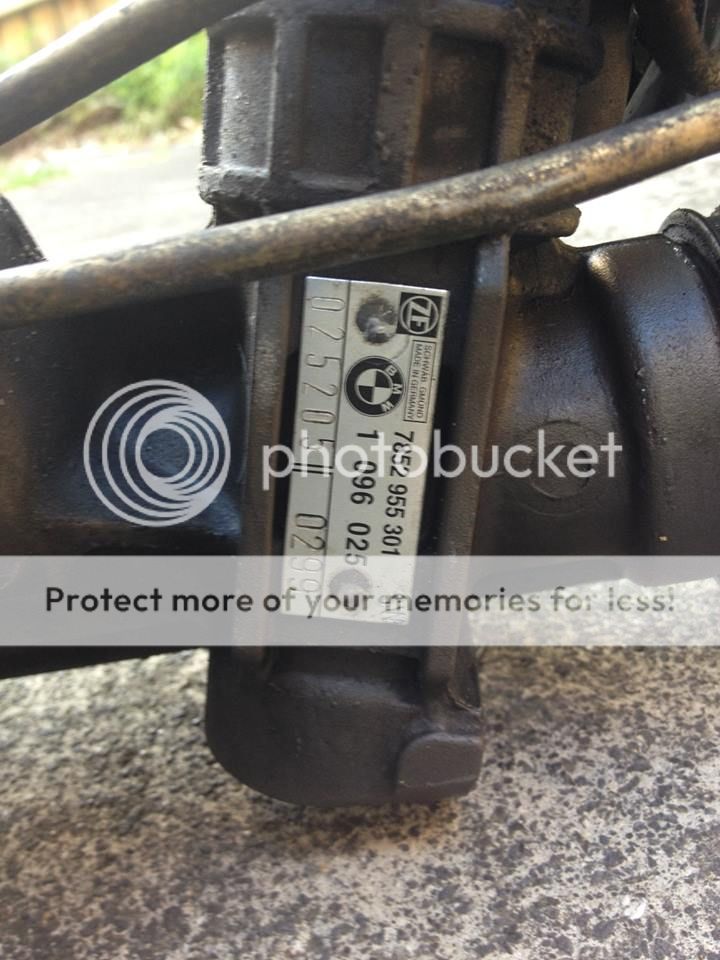

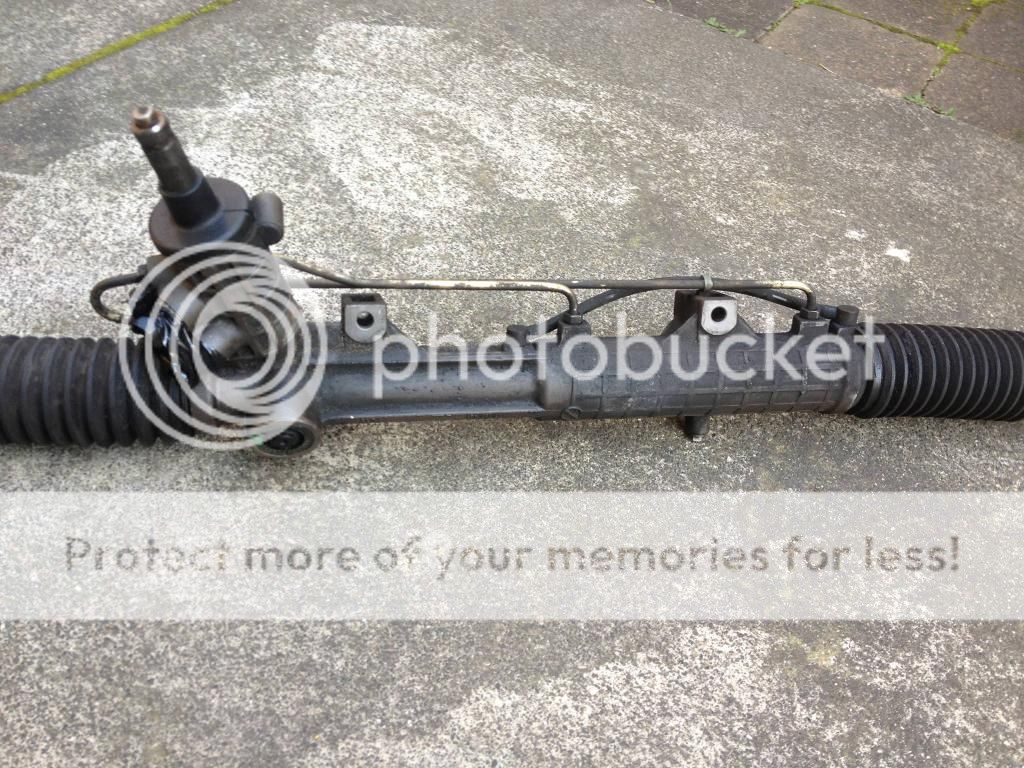

        Picked up a 99' E36 M3 EVO steering rack for a very cheap price (24% faster/3.2 turns to lock Vs E30 4.0) just need to find a E36 coupler to match.
        Looking forward to this as the factory setup in E30's is terrible.

            Travis, you can use the E30 coupler to join up to the E36 Rack. I replaced the guibo with a piece of 12mm plate and it all worked out nicely.
            - Chris

              Chris:-
              Any pictures of the piece you made?

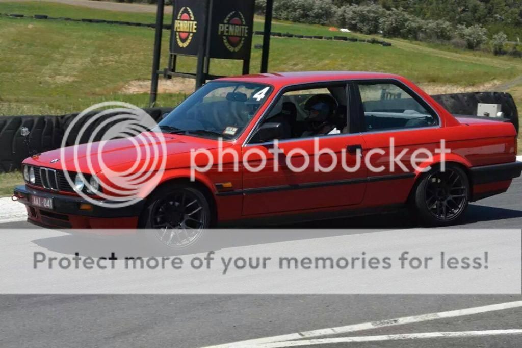

                      Not much happening besides daily driving the car and having fun.

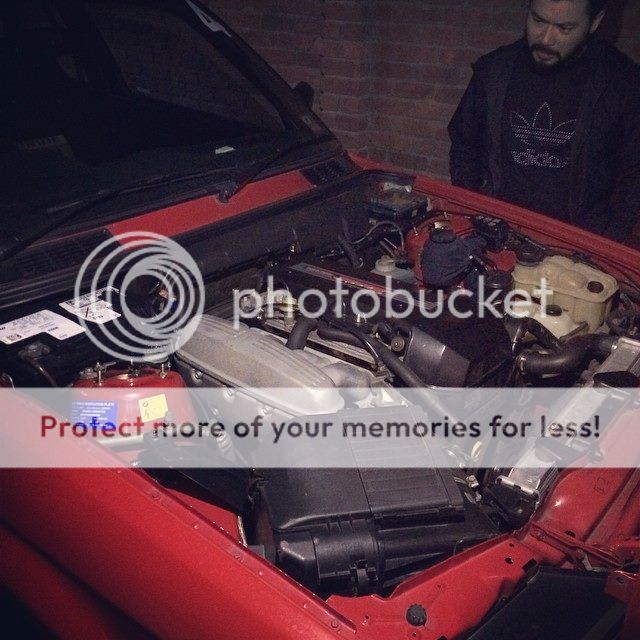

                      Boys went over the car again before a car show i attended on the weekend.

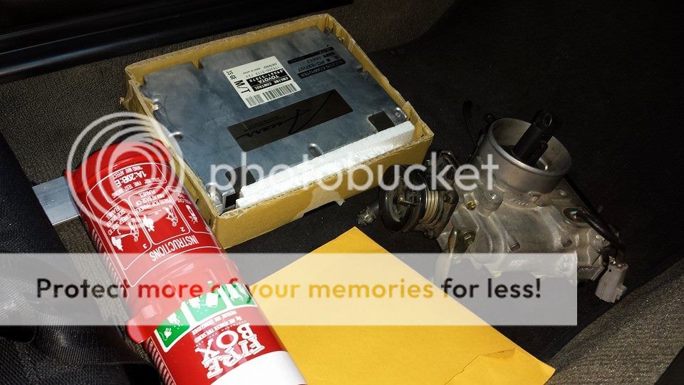

                      Currently testing a "tuned rom" Blitz access computer for the car and WOW big difference.
                      Dyno day coming up in a few weeks so we will finally see what DIRK makes power wise.
                      Also purchased these track decals of the tracks this car has raced at so far. i Hope to fill this window in the future :)
                      Sandown/Phillip island/Calder park to name a few.

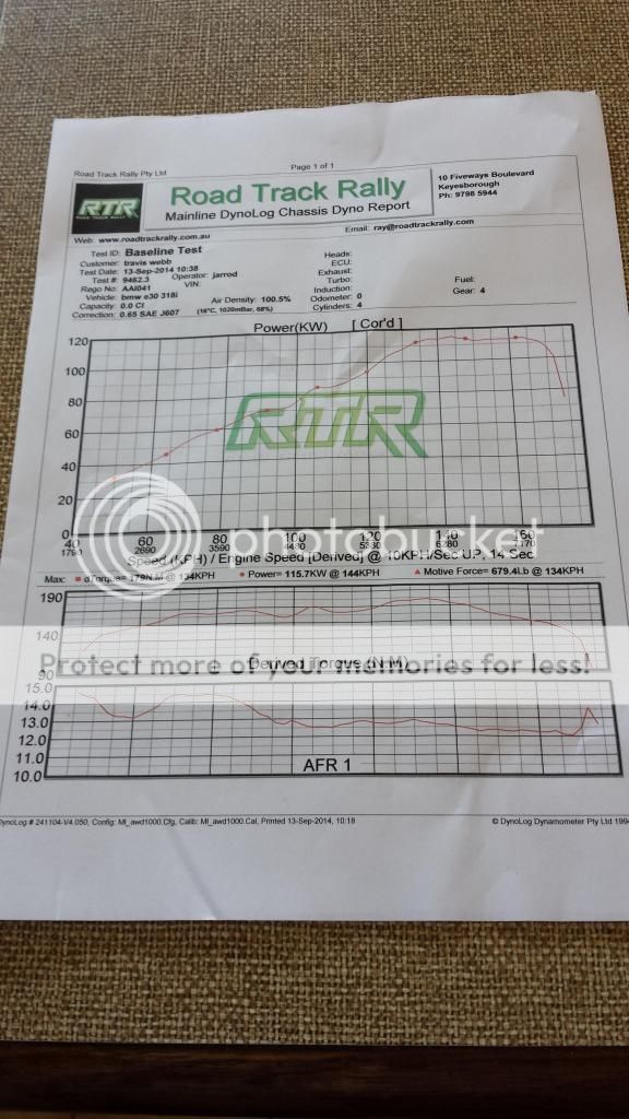

                        Dyno result was a little disappointing for me. Power plateud earlier than on a stock BEAMS, and you could see the ECU started to fuel dump shortly after.
                        The car has started to feel quite dull up top as well (engine health completely fine, still revs out cleanly as well)
                        So rethinking where i may have gone wrong i did change the throttle (half electric throttle) and AFM the day prior. The way Toyota have made the inlet side of these engines is very fine tuned. If you fit a pod filter to a BEAMS on an stock computer you will have hesitation issues and the like which is one reason i retain the stock air box albeit cut away underneath.
                        So i will be reverting back to the original AFM and throttle body i had which i hope will remedy this.
                        So here is the graph. You can see the power plateu. As i said the BEAMS in stock ECU form makes power higher than this. I was hoping to see over 120RWKW as my friend has a stock standard BEAMS that has made this in the past. Another similar Altezza made a few RWKW less than me on the day in comparison.
