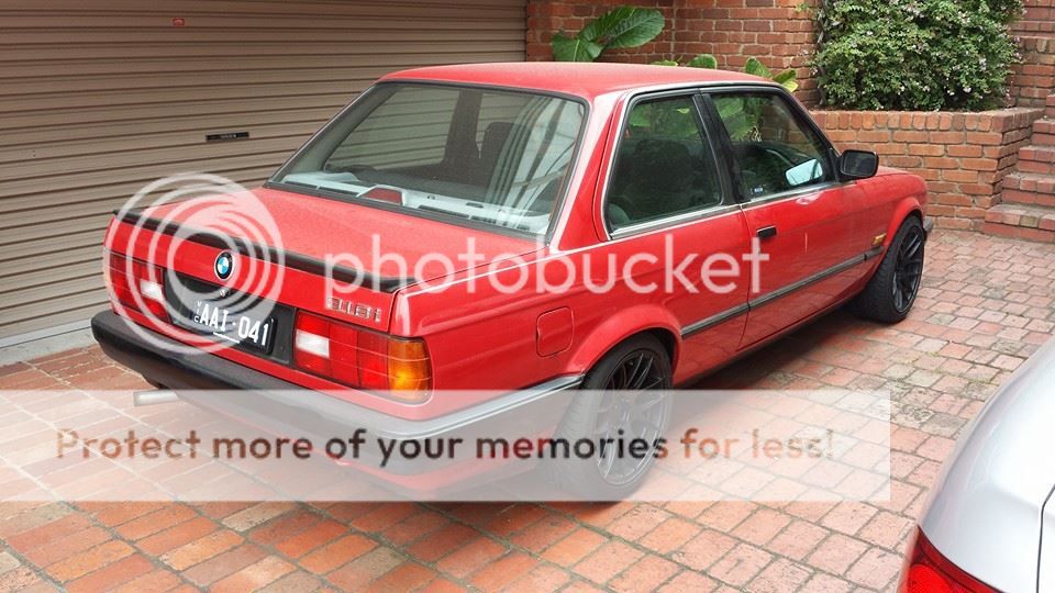

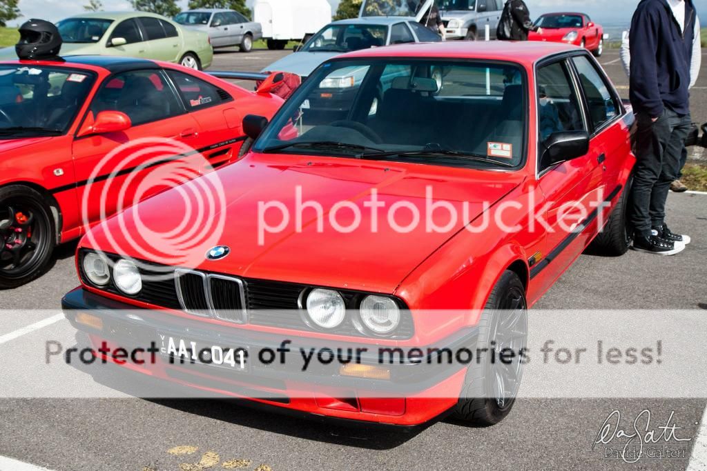

      Parts boys were late to open the doors this morning so took the time for a happy snap. Looks a million bucks in this photo. If only the car actually was

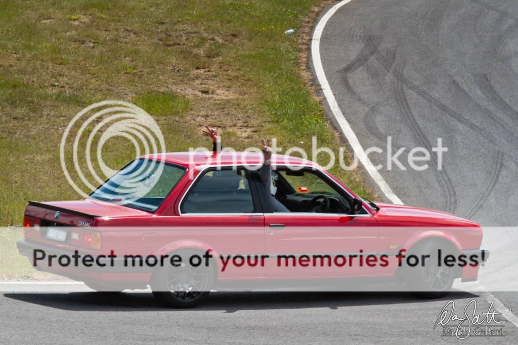

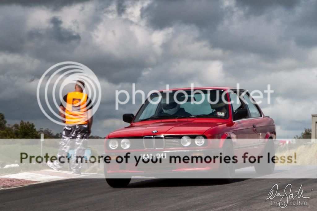

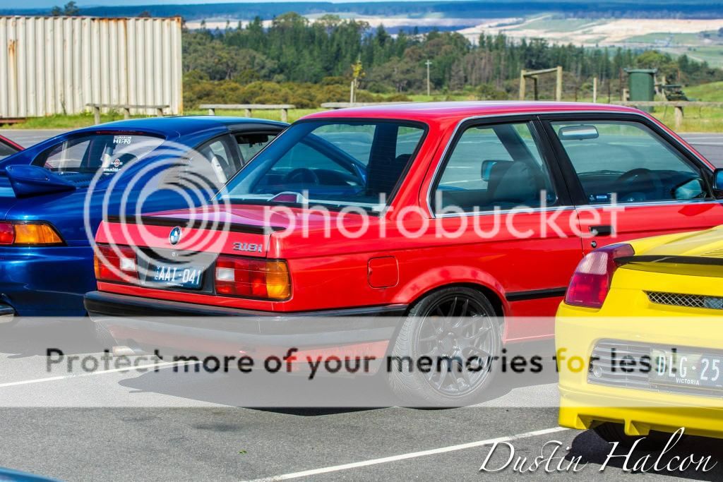

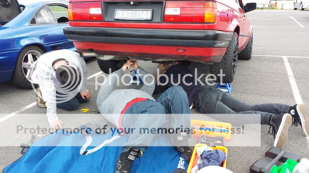

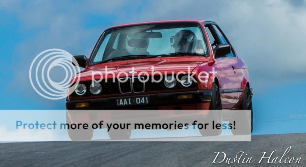

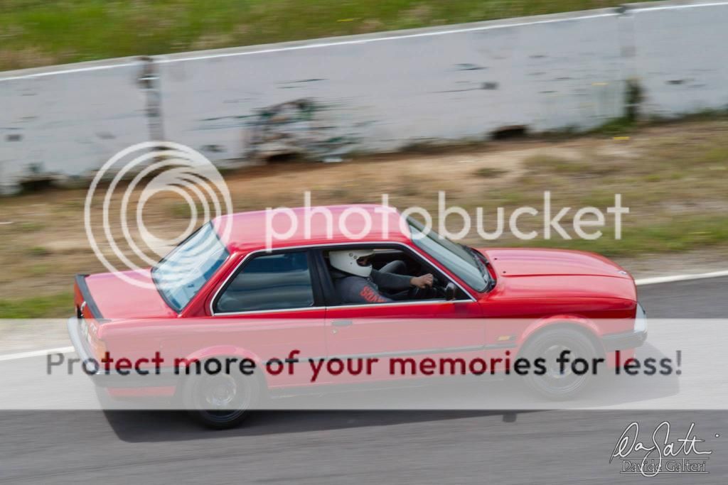

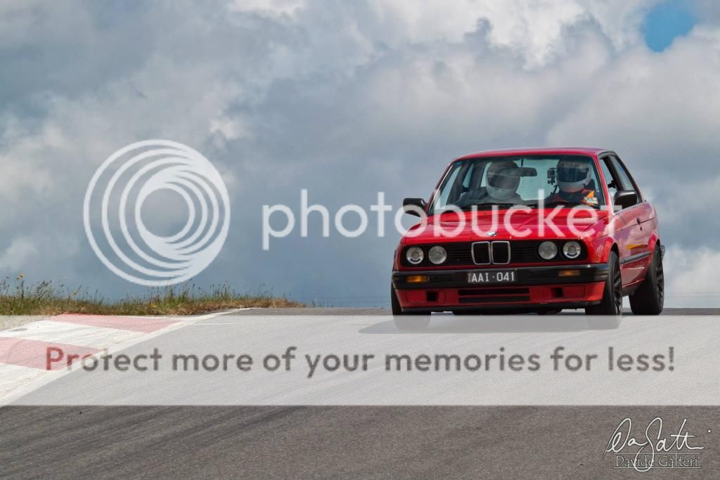

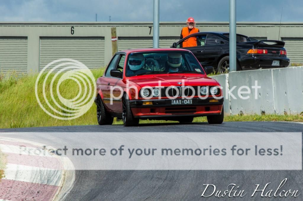

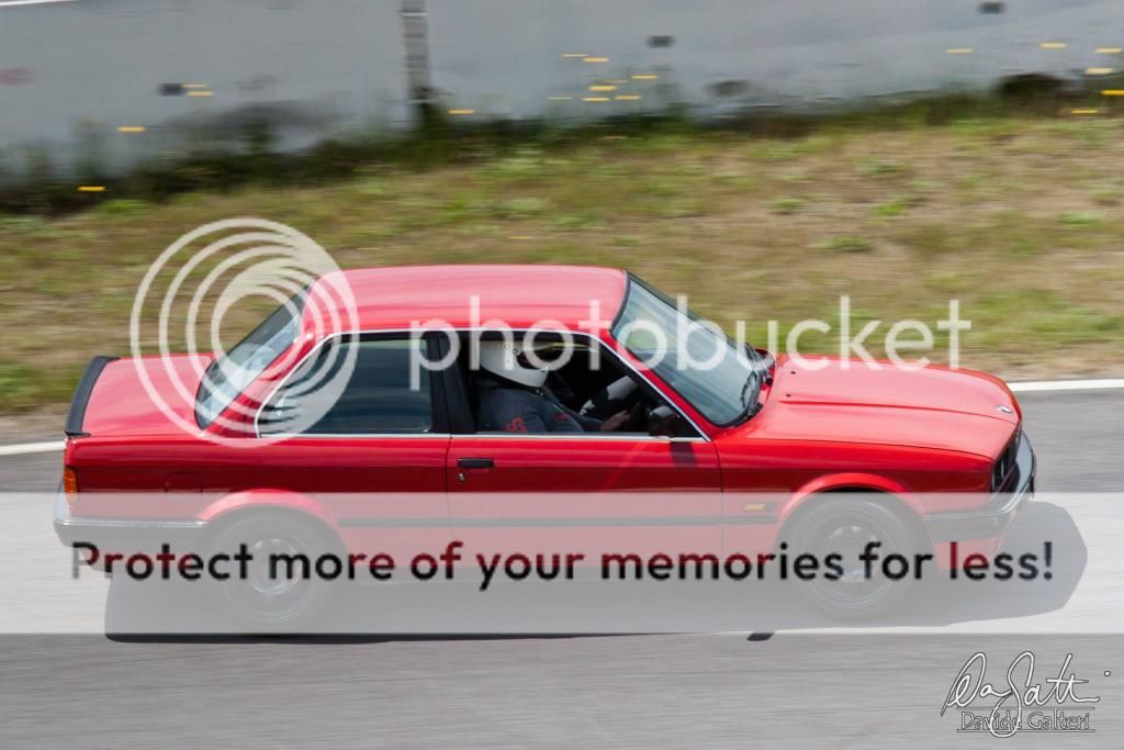

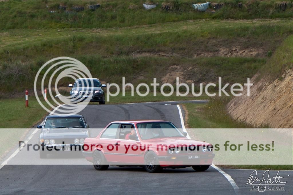

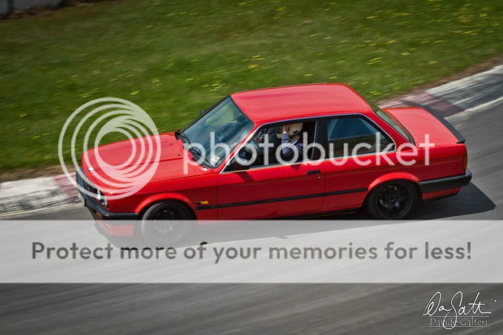

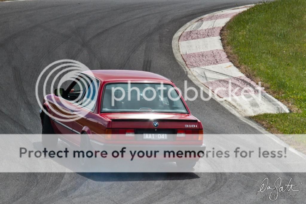

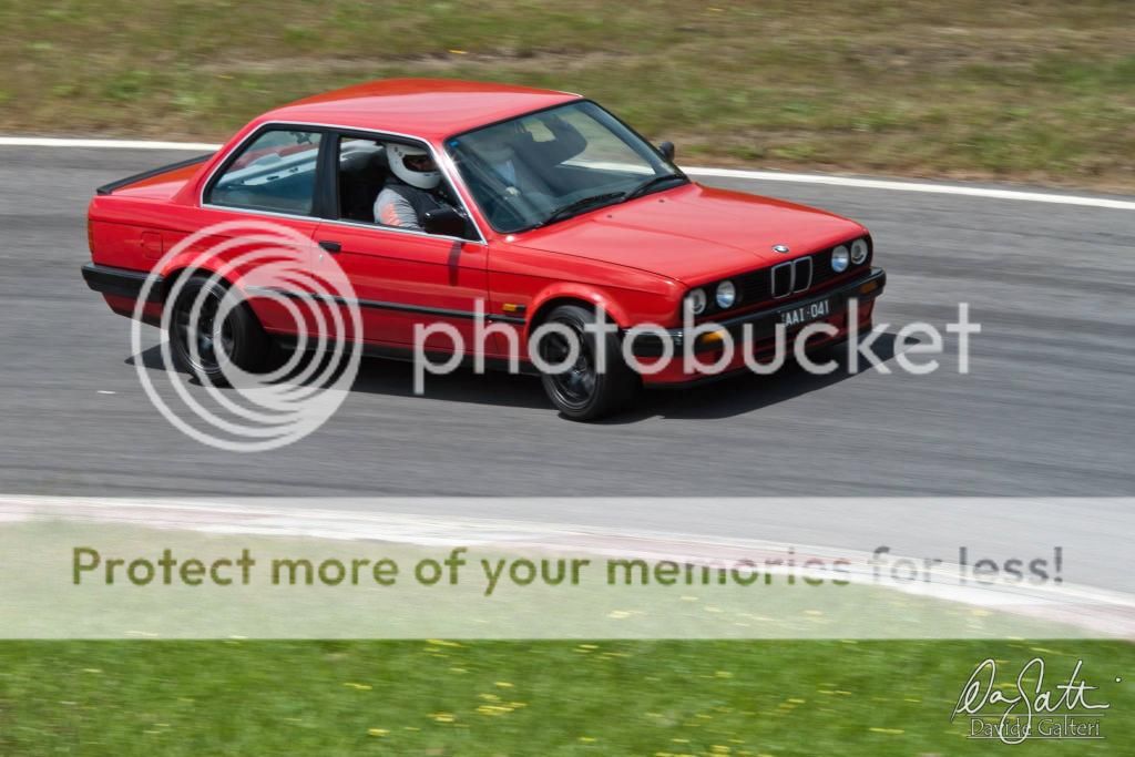

        Long time no post.
        Well i changed the diff for a 3.9 plate LSD as i was not happy with the gearing with the Torsen 4.1, the car has transformed. A much better ratio.
        The Whiteline rear sway bar....... what a joke! a straight fit part that hits the chassis cross rail is unacceptable! so we had to modify the bar itself. Luckily it works best on the stiffest setting anyway.
        The front sway bar was another debacle as well.... had to be changed twice even after supplying a shape.
        Chose to have the suspension set at 2.5 degrees camber all round, zero toe front and .1mm toe in at the rear.
        Took the car to a Hillclimb event to check everything out on the car for it's first shake down.
        Quite happy with the result, exhaust still needs to be changed for something that actually suits the Beams (2.5 inch is what these engines require) and a few other bits and pieces need to be done (custom front sway bar is touching the front tyres on full lock :( etc etc) but i was only 4 seconds off my best time in a MR2 and with a passenger in the car that was great.
        Here are some pictures.

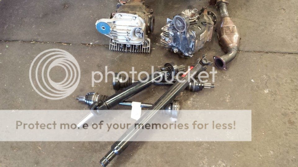

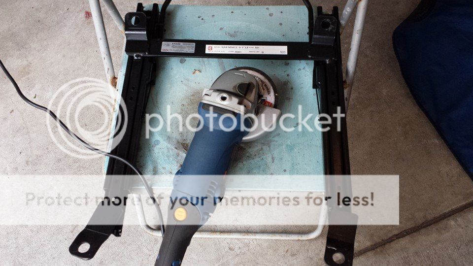

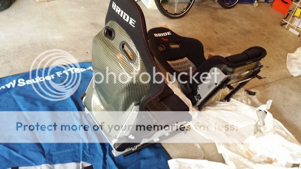

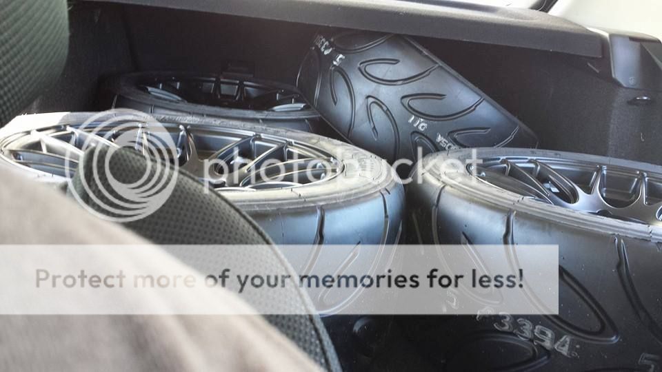

            Fixed some niggling issues (universal joint on the rear of the tailshaft was stuffed and very noisy on the freeway)put the driveline back in the car.
            Decided i am going to take Dirk to Wakefield early January instead of the MR2 i normally i use so the race is on to get the car complete.

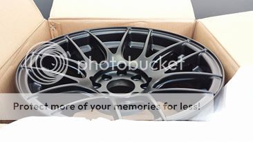

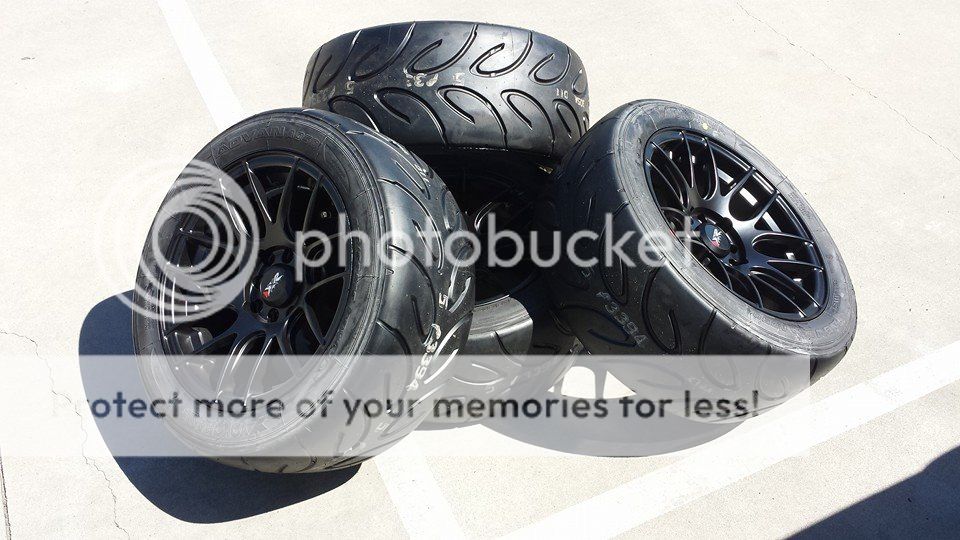

            Received my track wheels (same design but 15 inch) and will have some A050 Advans this week i hope.
            Issues still with the custom sway bar..... which needs sorting before Wakefield.

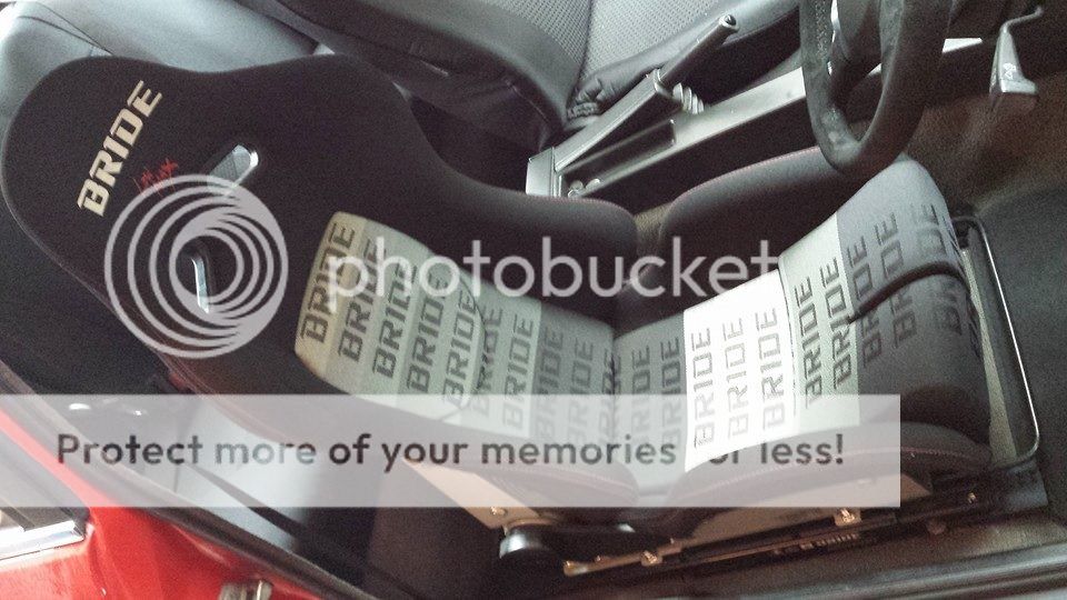

            And started fitting my Genuine Kevlar Bride LowMax Stradias today.
            I still have not edited the video from the Hillclimb so i will add that here later too.

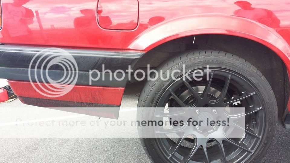

                  Brake pads and tyres done now.
                  Wheel centre caps are not staying, i hate them. Just fitted by the tyre place.
