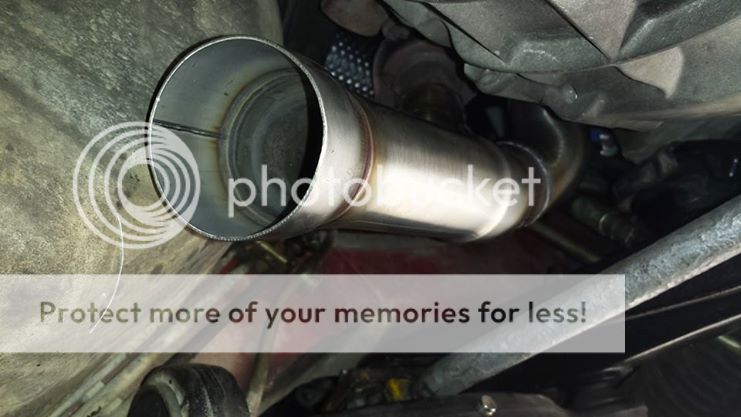

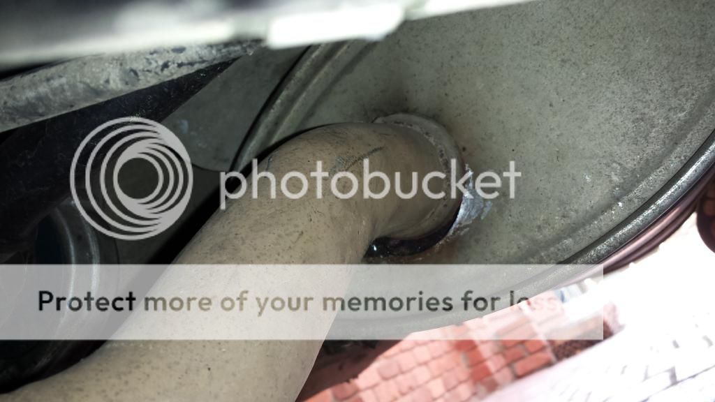

          Well after trying to keep up with my mates well modded MR2 turbo this happened....
          So time to finally sort out the exhaust (well the rear at least)
          Soooo many things to do before the track day in under a month, not looking good.
          (the exhaust is completely blown apart at the weld seam)

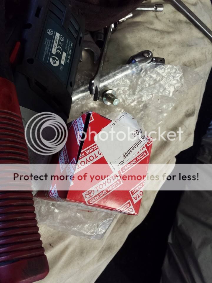

            * Fluid changes for everything (only genuine Toyota filters for your BMW haha) and trying some different gearbox fluid this time.

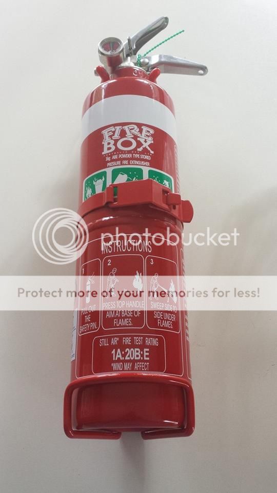

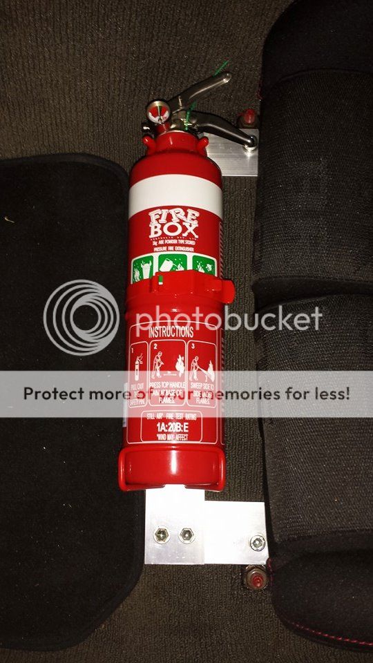

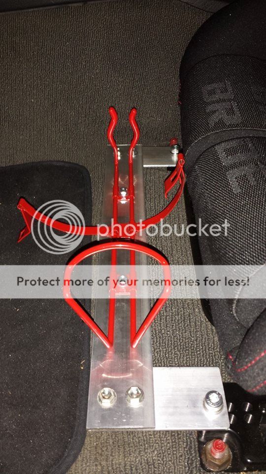

            * Having to fit a fire extinguisher for the racing rules

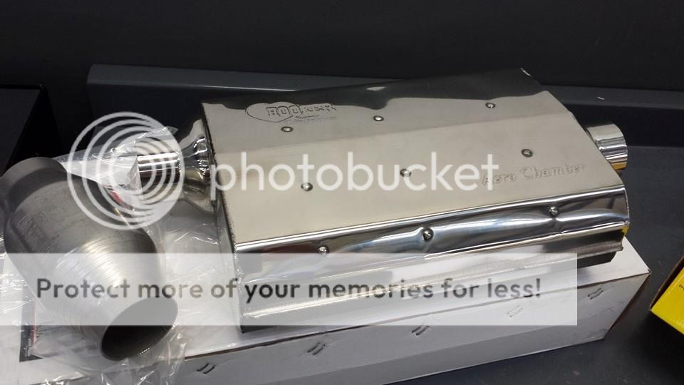

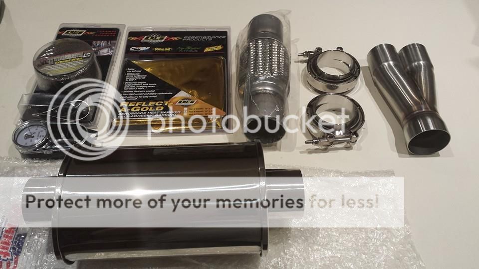

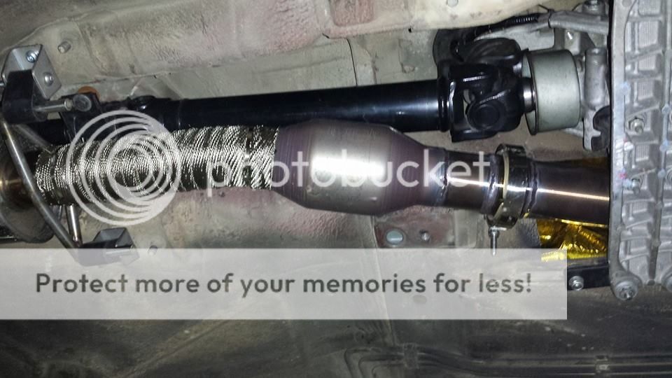

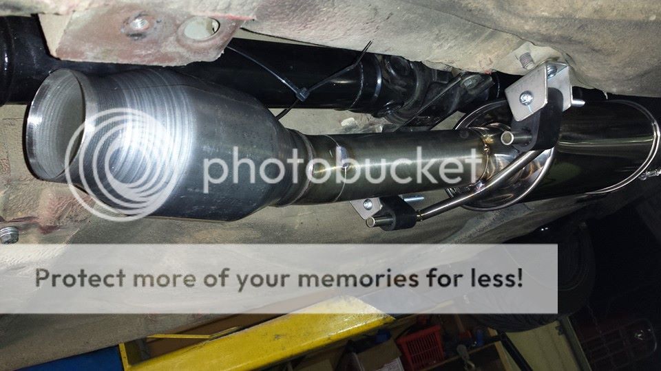

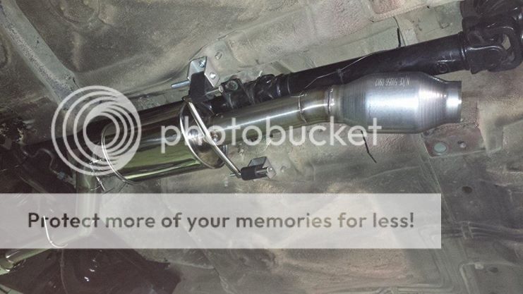

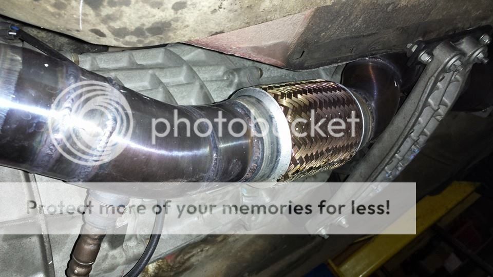

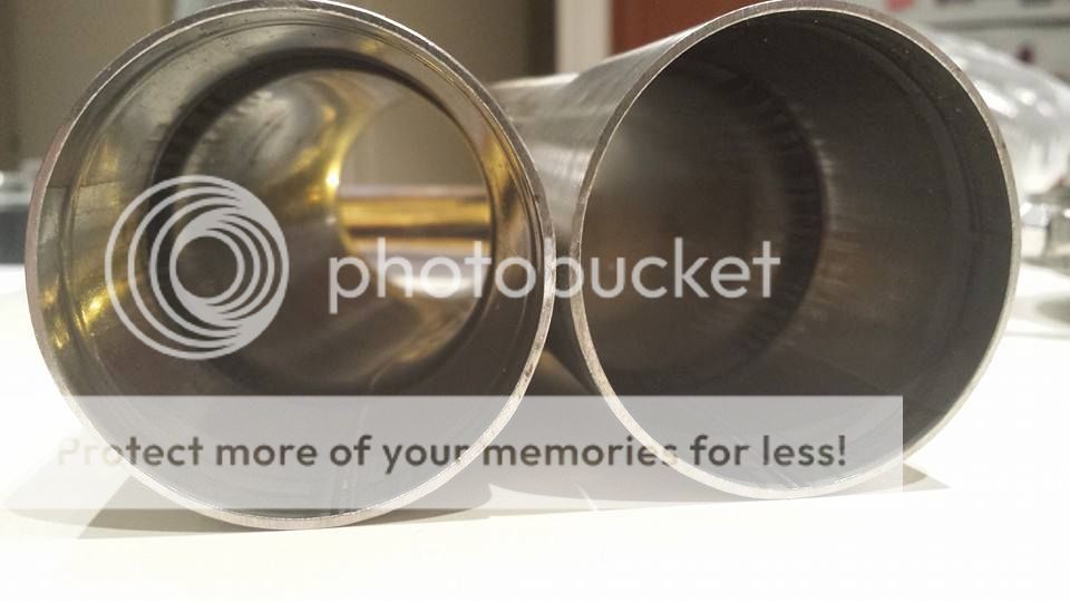

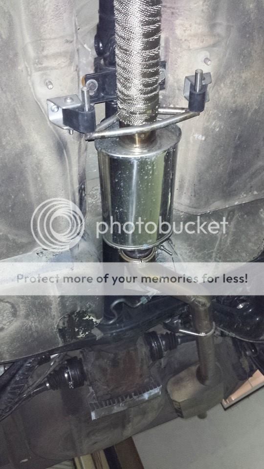

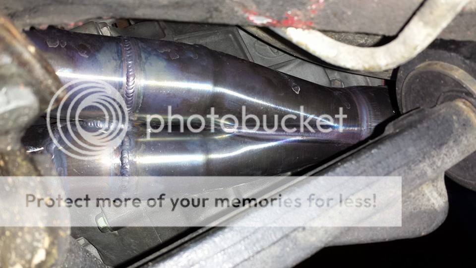

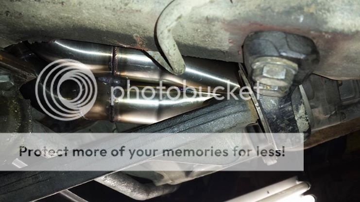

            Made some purchases for the exhaust too and will be making a new setup from the primaries back (reducing the secondary length and making the exhaust to suit the current and future setup when a new extractor is made along with the ITB's)
            So used Summit for the first time. Great service and will definitely use them again. No wonder they are so well known and successful at mail order!
            Will post pictures of when the exhaust is done this week. Track day is next weekend and i am now doing both days not just one.

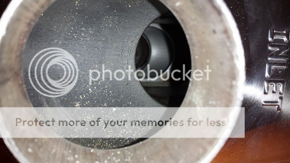

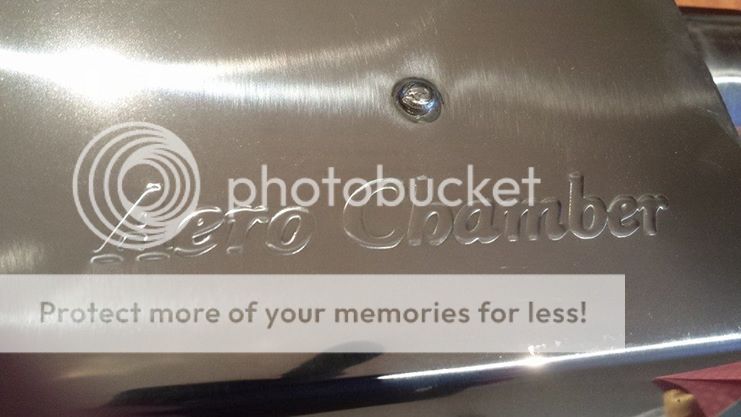

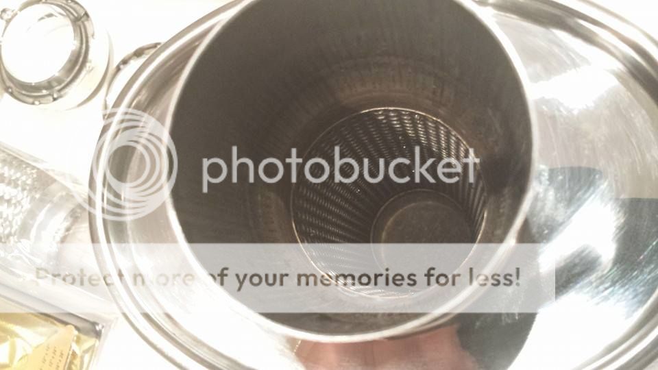

            Exhaust will now be:- 2 inch secondaries (350mm long) into merge collector (2x2 inch to 2.25 inch short reverse cone to 2.5 inch), flex, ovaled pipe near gearbox, high flow magnaflow cat, vibrant resonator and into a Hooker Aerochamber muffler (especially looking forward to using this as the flow/noise is so much better than anything else at the price point)

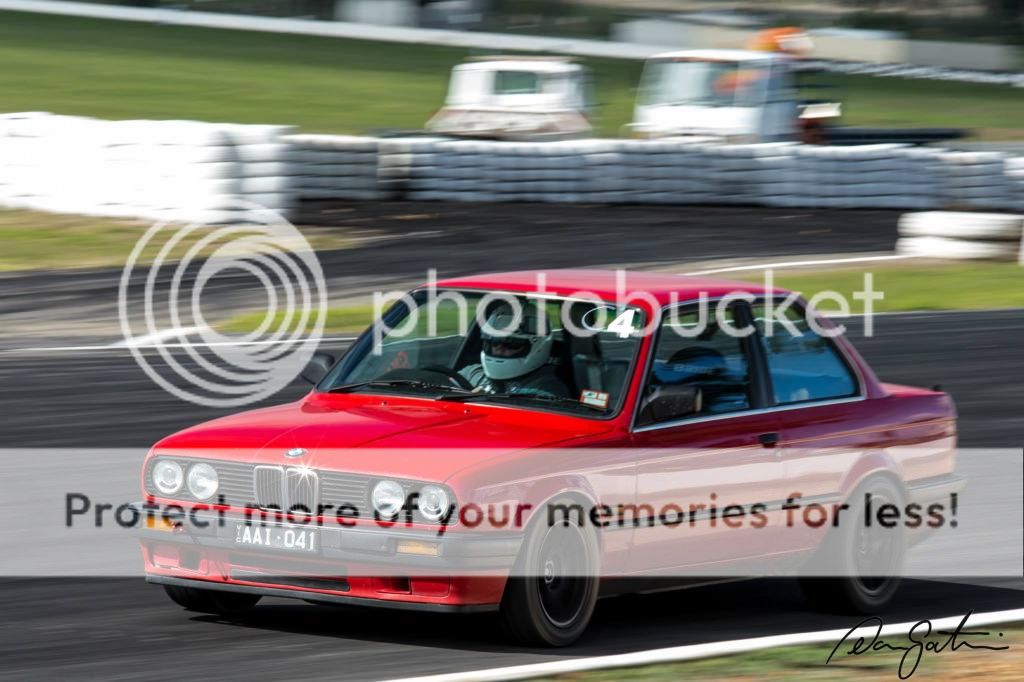

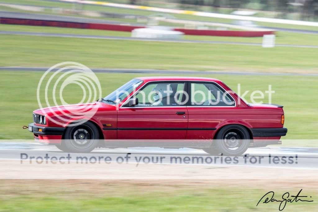

                      Well i attended the 2 day track day and got a great time on the weekend.
                      Drove the 2.5hrs up, raced for two days straight then drove home again (what a street car is all about)
                      Full weight besides removing the spare wheel i was able to get a 1:43.03, which is great for the racetrack i was at for a low powered N/A streeter.
                      There were two other E30's there too which was good to see.
                      As the gearbox was still iffy shifting down into second from third at high RPM, it eventually gave up the ghost early on the sunday so i could not better my time and only managed a 1:43.08
                      Regardless this car will do 1:43's all day long.
                      The differential....... well the car has one but lets just say i afraid to open it up and see what it looks like inside to be honest!

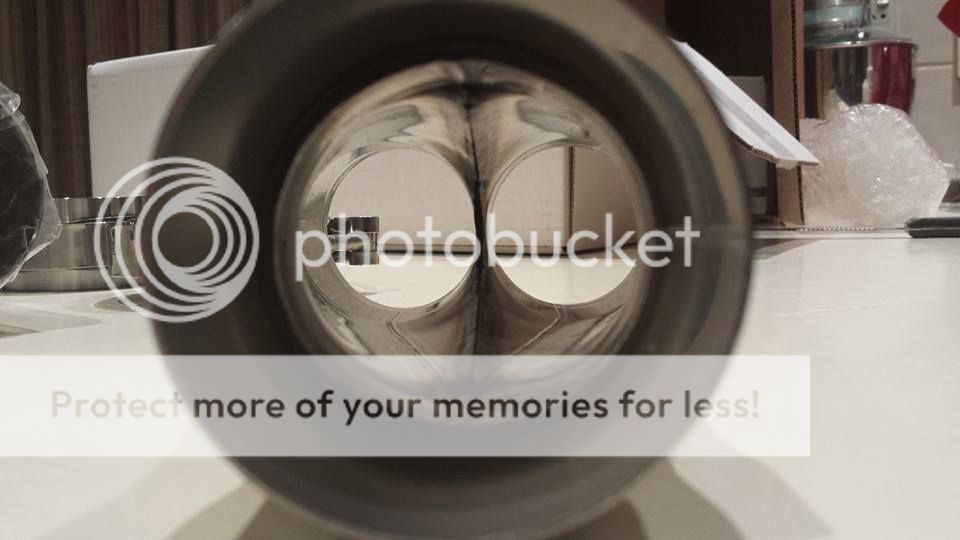

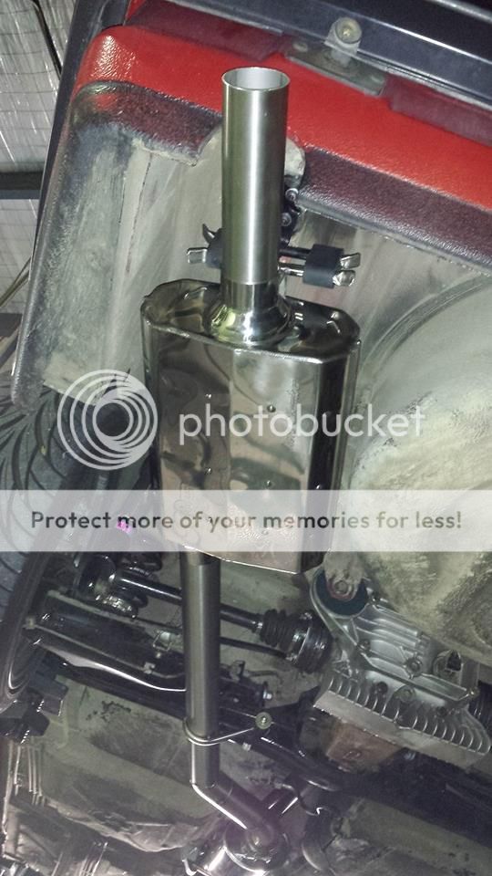

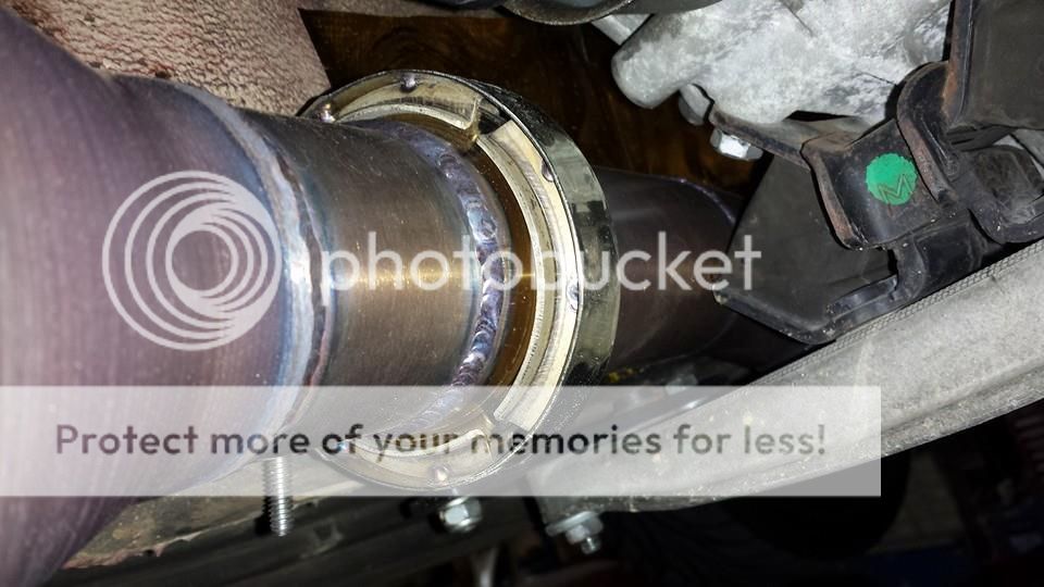

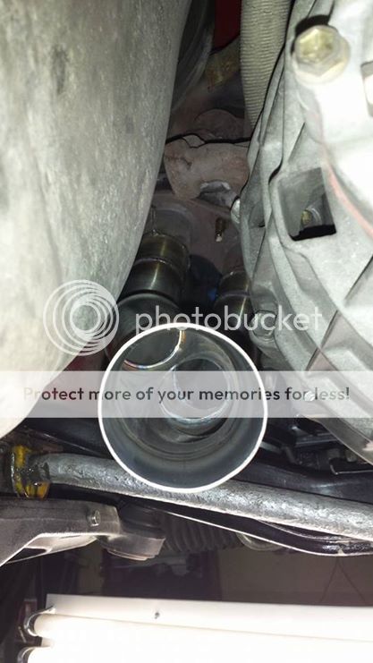

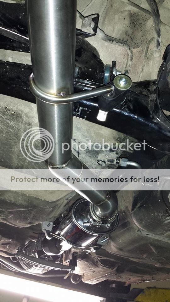

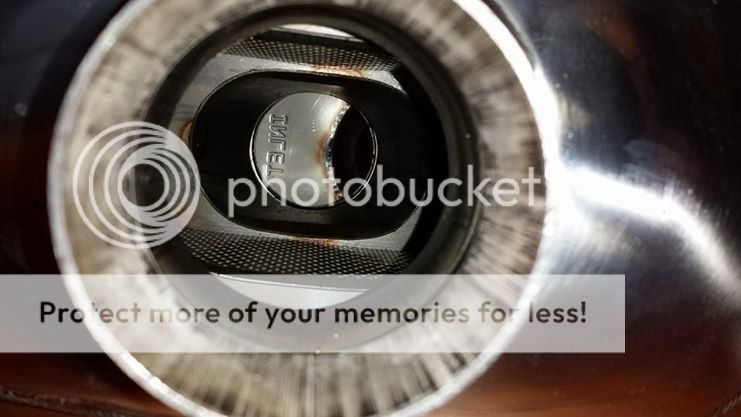

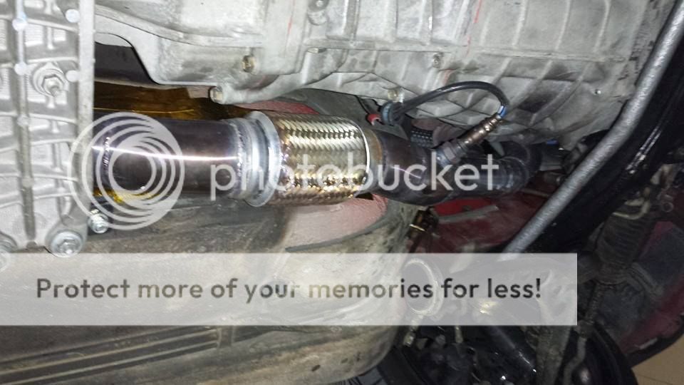

                      The new exhaust worked great, and lost no power over the straight pipe. Changing the design and having someone fabricate it the way i would makes a huge difference to the outcome. I love the sound of the Hooker and think i made the right choice. Having the ground clearance i do now is great too.
                      A few pictures, i will get some more on Thursday when the car is back on the hoist.
                      • kameleon
                        • May 2011
                        • 288
                        #251
                        More pictures of the exhaust and from the track day.

                            Great job on the car, that exhaust setup looks sweet
