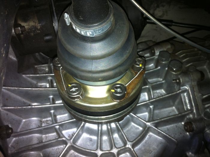

      sorry to hear about the axle bolts coming out,
      i wanted to share a trick that may help,
      i drilled all of my axle bolts to accept safety wire,
      all drilled,
      i dont have an installed photo but this one is from a fellow member on a porsche project where i got the idea from. photo credit LJ851
      for one bolt to come loose it will tighten the bolt that the safety wire is attached too.

        ^Came here to suggest this and that picture looks really familiar.....:-D
        I would recommend pretty thick safety wire, like .032 diameter. On a fastener that is highly stressed and fails spectacularly when loose, this is a great solution.
