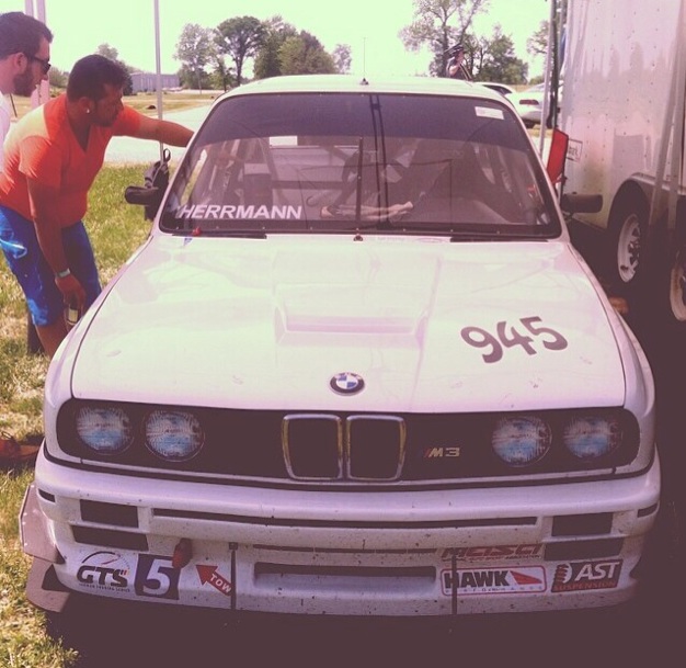

            #1760
            Scoop
            DREWLIENTE
            1$ PShops PM me
