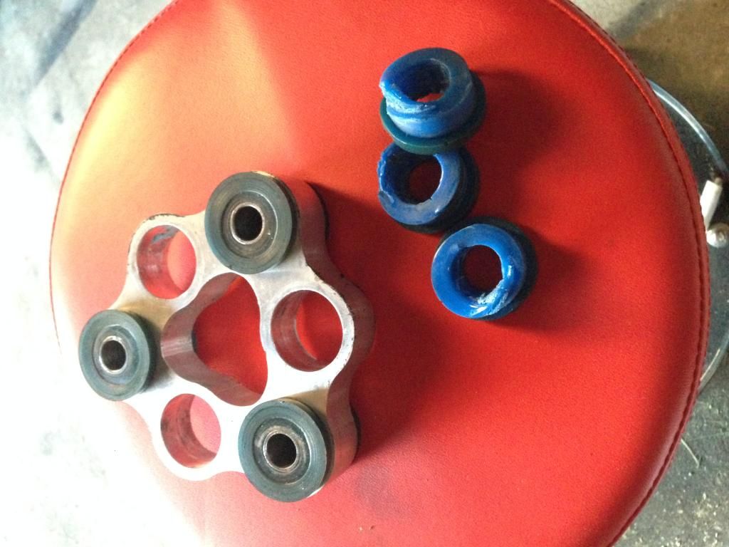

        wait why cant I just use this swap guibo that converts from the 96mm/12mm ZF transmission flange to the 78mm/10mm E30 driveshaft?
        that way I keep my nice perfect condition driveshaft, save money, and get a nice guibo.

          #1774
          That would work too! Good way to test the quality of Revshift's stuff too.

            #1775
            A friend of mine tried to use one of these and it either didn't fit or fell apart, maybe both. I can't remember though

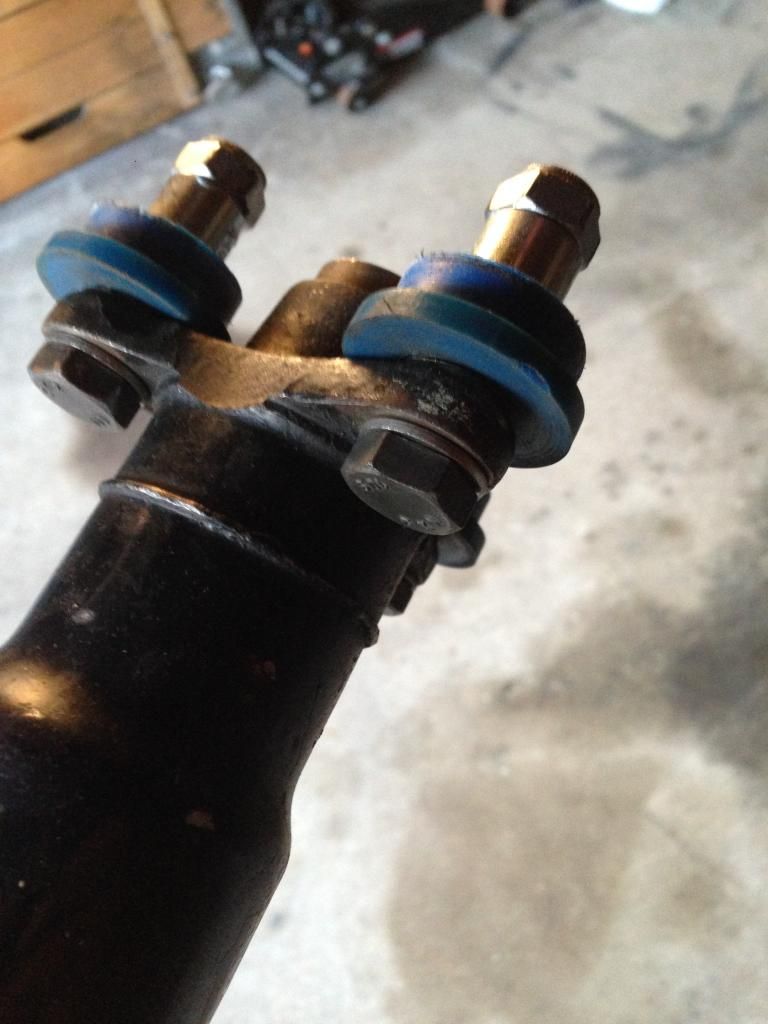

              #1776
              Something to consider
              you'll end up twisting the drive shaft with that guibo. You need some kind of flex in the drivetrain.
              I ran the one with red urethane bushings, which were hard. If the blue ones are softer that might help. Mine would twist at the splines, went through two driveshafts then switched back to a stock one.

                #1777
                Yep I'd not run the solid guibo either.

                  #1778
                  Ive been running a solid guibo for a couple months with no problems with stickey tires and some hp, last driveshaft however did have a crazy amount of play in the u-joints.

                      #1780
                      Revshifts guibo is a strong piece, no doubt. Survived countless launches with over 600ftlbs to the wheels. With an after market driveshaft it would make sense, but with a stock DS and the torque a turbo M30 makes the DS will fail.
