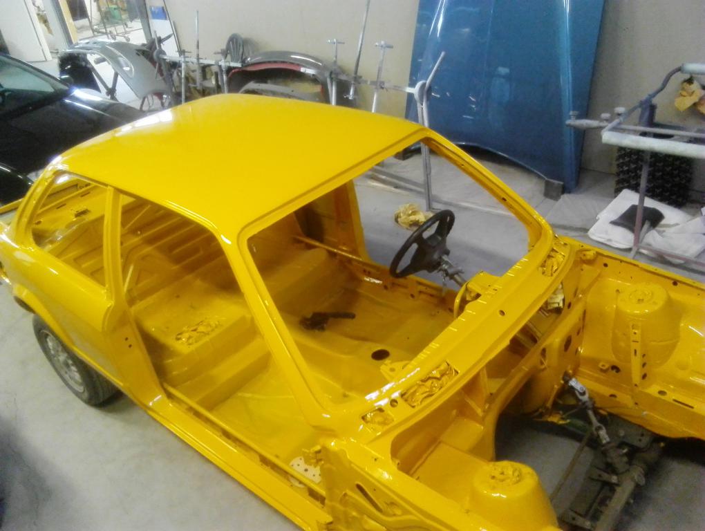

    Better pics later.

      Yes to me those links are working nicely, wow that color is mint, dude..I like it

        That's really going to stand out!

          Different lighting, different camera. Really changes how the shade looks. One of those color you'd have to see in person I guess.

            I actually kinda like it. Keep up the good work!
              Thank you.
              You know the color divides opinion. Divides as in I like, and the rest of the world doesn't :D. There are still enough brilliantrots, cirrusblaus and alpineweiß E30s in the world. Looking at it I haven't had a "Oh god what 've I done" moment so I guess it's OK.
