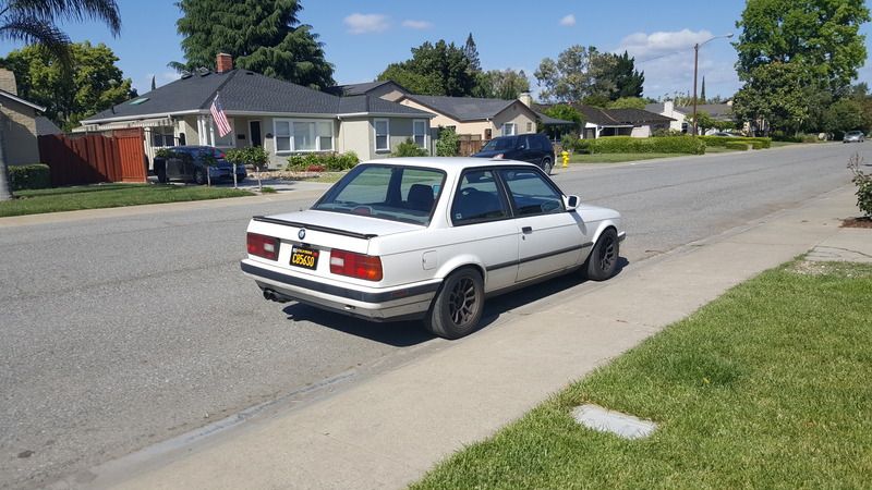

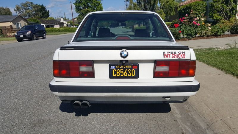

        I got Black and yellow plates a while ago. I dig em

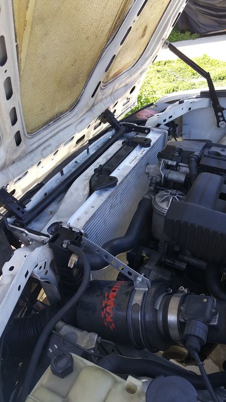

        DO NOT USE E36 MISHIMOTO RADIATORS. I went through two during a 4 year period. They leak at the rows on both sides due to poor engineering and I have heard of people having the same problem. Use a Z3M radiator instead!

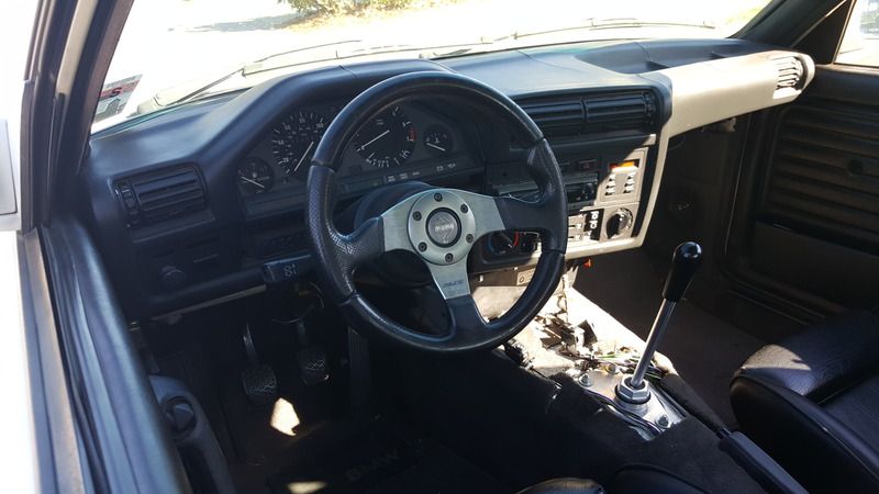

        Finally got my Momo race wheel on. It's small, but I enjoy it.

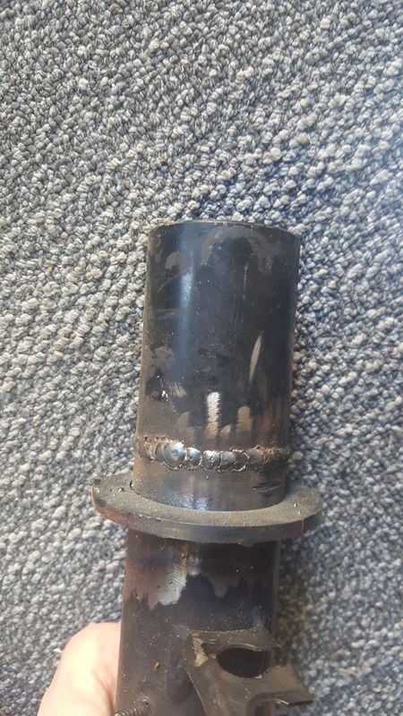

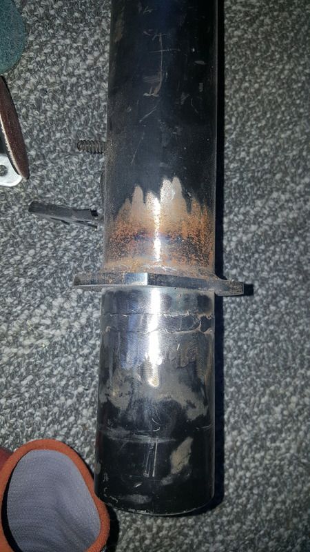

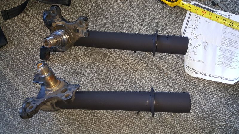

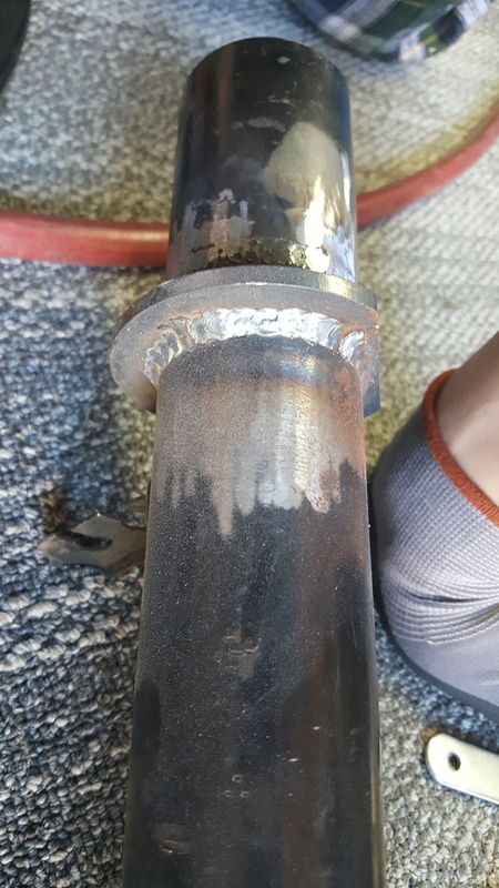

        Tried getting my strut housings ready for the GC conversion kit. I bought them already welded up, but I needed to do some grinding
        Having a hell of a time trying to figure out what shocks to run with shortened strut housings and 550 front and 700 rear springs.
