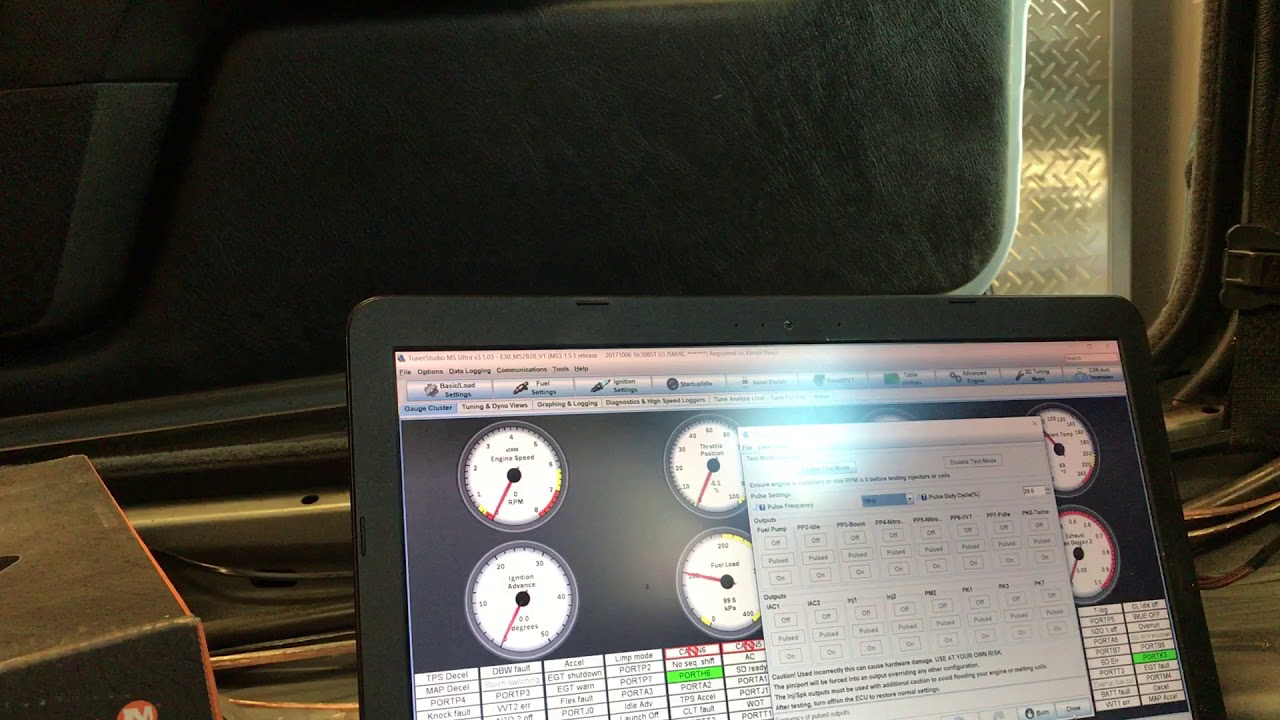

                  • Found that triggering O2 and Main relays from the Fuel pump output of ECU would not work, as I'm using +12v from one of them as a pullup for the crank sensor. Wired an additional output from the ECU to control these relays separately.
                  • Successfully test fired the motor!
