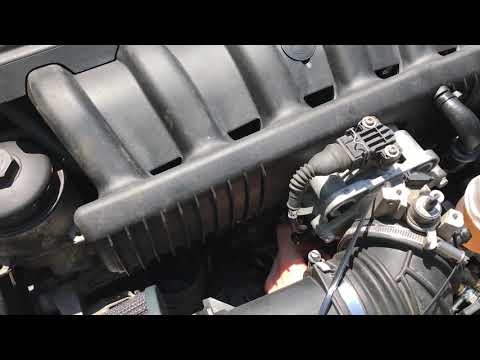

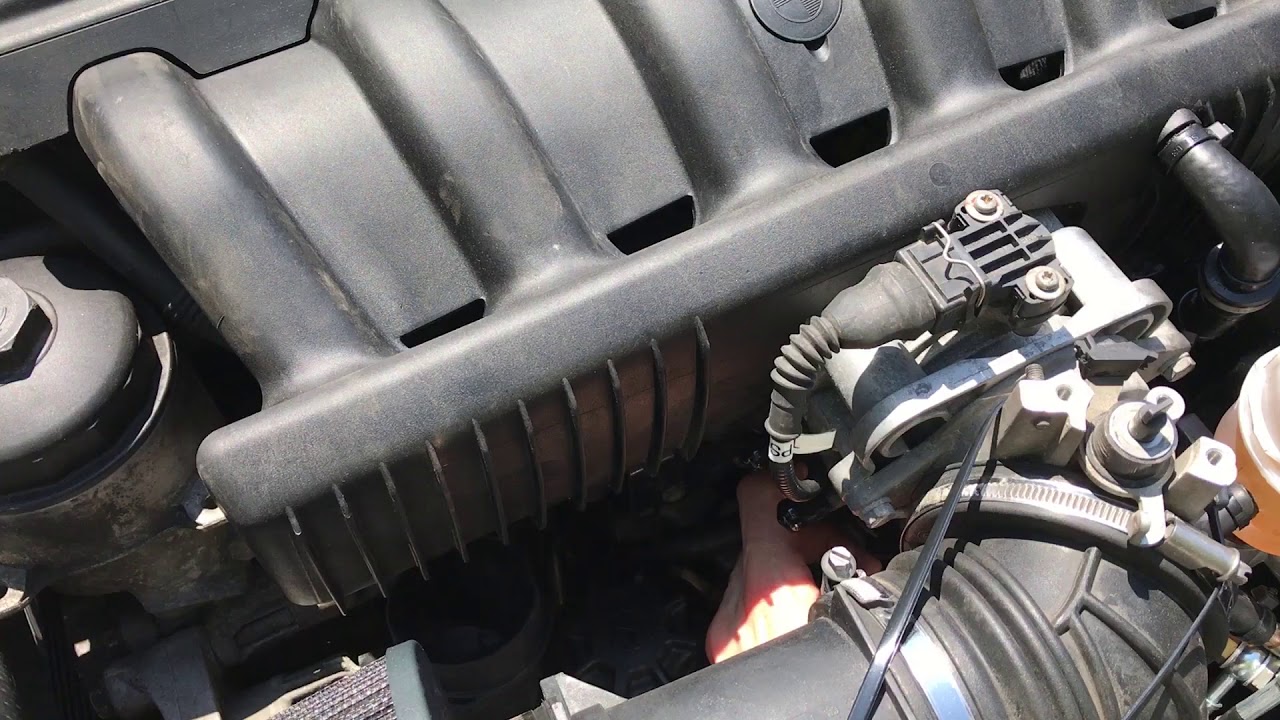

      Motor is Running!
      • Installed heater hoses (heat not blowing hot now, will need to investigate)
      • Added heatsink to LED flasher resistors.
      • Sorted out vacuum lines from intake manifold. (Dedicated vac line to ECU)
        • Ran vacuum line to ECU through grommet on driver's side.
      • Deleted throttle body coolant loop
      • Cleaned/degreased/painted removable core support
      • Cleaned & mounted intake manifold.
      • Test fit M42 radiator & made radiator hoses. (Is there a better/OEM option for these hoses?)
      • Heat wrapped custom harness & tucked behind motor.
      • Wired and plumbed engine.
      • Calibrated Wideband O2 sensor.
      • Started. Tuned idle fueling and ICV duty, bled coolant, filled power steering res.
      • Fixed coolant leak inside car at heater core.
      I found my idle fueling to be quite different then when the motor was on the wood blocks. I'm sure now that the 3/2 way valve (E36 FPR) was not working previously, and needs the +12v I've now supplied to function properly.
      Would like to get a fuel pressure gauge mounted on the rail for reference.
      Also, I had to give the brake booster a few love taps with a hammer to clear the intake manifold. Hopefully I didn't damage anything. STILL waiting on my 2002 brake resovoir, so I can't bleed/test the brakes.

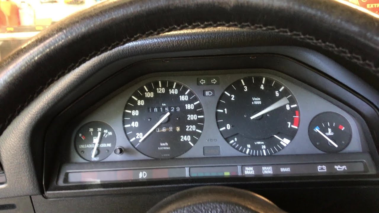

                                Turned on Accel Enrichment (AE), and got some base settings for the Accel-Pump mode from someone on Boosted E36 World facebook group.
                                Turns out his curve of fuel vs TPSdot is completely different then what I would end up using, but at least it gave me a starting point.
                                Here is a video and corresponding log of some revs when I first turned the AE turned on.
                                You can see the big knock spike on the first tip-in from idle, and see the CEL flash in the video at the same point in time.
                                I found that the wideband can't respond fast enough to see fueling changes made by AE in real-time, so a lot of the AE tuning was done by trial-and-error, making changes and feeling how the motor responds.
                                I know there are better methods to tune AE, but I've now got it in the ballpark.
                                Here is the curve I'm currently using. No more tip-in knock, throttle response and drivability are both good.
