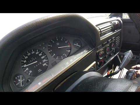

                  2-Step Launch Control
                  Learning about 2-Step Launch Control available on the MS3X, and playing with the Advanced Limiter Settings
                  Video speaks for itself!
