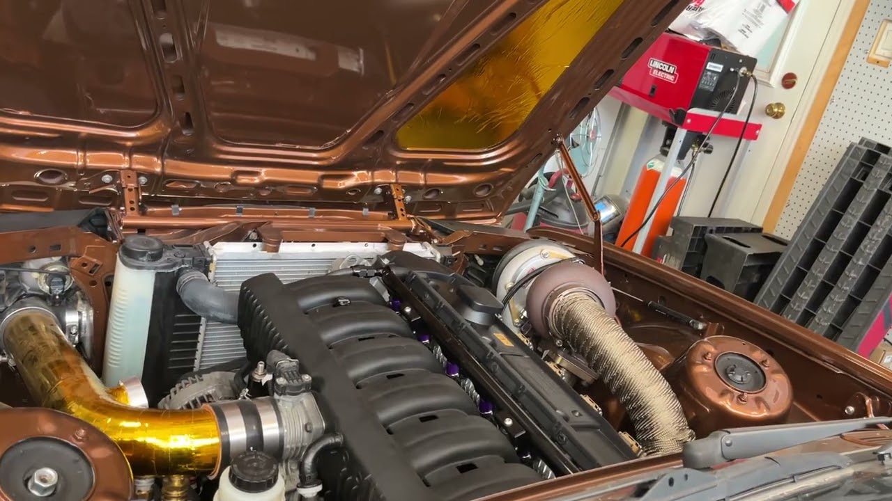

                  First fireup in two years!:
                  • Extended fuel return line to drain two year old gas into a 5L jerry can.
                    • 6 feet of Gates fuel line costs over $50cad now. 💀
                    • Old fuel had Stabil 360 Marine but I didn't want to take a chance, since all gasoline here has Ethanol now.
                    • Cycled the fuel pump from the laptop. MS3X Test Mode screen is pretty handy!
                    • Got 7-8 cans out of there and into the Mercury daily driver.
                  • Eliminated extra fitting on return side of fuel rail that was previously used for pressure gauge.
                    • Less failure points and more clearance to remove oil filter housing.
                  • Found no spark on Cyl #5.
                    • Was fine when parked.
                    • Turns out that channel is bad on the #2 Quadspark module.
                    • Swapped to spare channel and verified spark in Test Mode.
                    • Had to drop the glovebox and part of the harness to troubleshoot and make the change. Still need to button things up.
                  • Changed the oil with Rotella T6 15w40.
                    • Only bought 5L for whatever reason but it was enough to fire it up while the engine was still warm.
                    • Need to buy more oil for the additional 1.5L
                  • Found an exhaust leak on the vband turbo outlet to downpipe.
                    • Have the car on jackstands now, will have to loosen the downstream clamp and see if I can get things lined up better.
                  • Found the turbo oil feed line is just starting to fray through the outer jacket near the oil filter housing. Need to address before I drive the car.
                  • Going to need to do some retuning for the 93 (with ethanol) gas.
                    • I previously wrote this tune on E0 91 octane.
                    • Specifically I want to address the idle fueling, vanos at idle, add closed loop IAC valve control, and perhaps add some timing across the map for the extra octane.

                    Originally posted by varg
                    I know the feeling. I hated having to cut a bracket off of my E34's strut tower and pound on it with a hammer to provide clearance for the turbo. If I didn't have solid UHMW engine mounts it would still have contacted.
                    I wish I had test fit the turbo kit before painting the bay. I could have done a nice job adding clearance with bodywork hammer & dolly.
                    Originally posted by 2mAn
                    Hope its not too much of a pain... That shiny paint looks great right now
                    Thanks, yeah it does look good. Could use a wash for sure though!
                    It is what it is. Once it's done self clearancing I can touch up the paint, assuming my batch of colourmatch is still liquid.

                              Took the E30 for it's first drive in nearly 3 years today!
                              But first had to take apart three v-bands to get the exhaust all lined up and sealed.
                              Got the set of Yokohama ADVAN FLEVA V701 (205/55R15) that I bought in 2023 mounted up to the euroweaves yesterday.
                              Have only taken it on a brief test drive, but it appears the vibration from my right front wheel is gone with the new rubber!
                              Took off the 20mm rear spacers and swapped to 15mm while I had the wheels off. Centercaps went back on after test drive and retorque.
                              The car is SO DUSTY. You can see from 6 feet away in the front gas station shot. Wheels need to be detailed as well.
