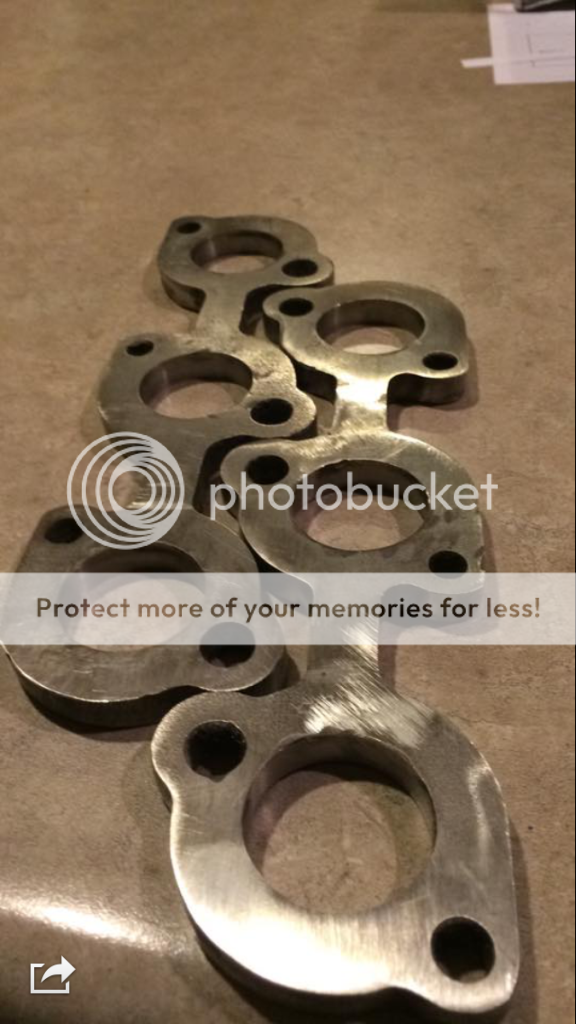

            Busy weekend was busy.
            Got me some stainless flanges cut :o
            Also got me some BimmerHeads ported head action with HD rockers and a 280/274 regrind. Picked up ARPs as well.
            And threw a fresh Gates Racing belt on the Forester!
            1989 Hooptie 325iS Build Thread
            1989 Zinnoberrot M3 Build Thread
