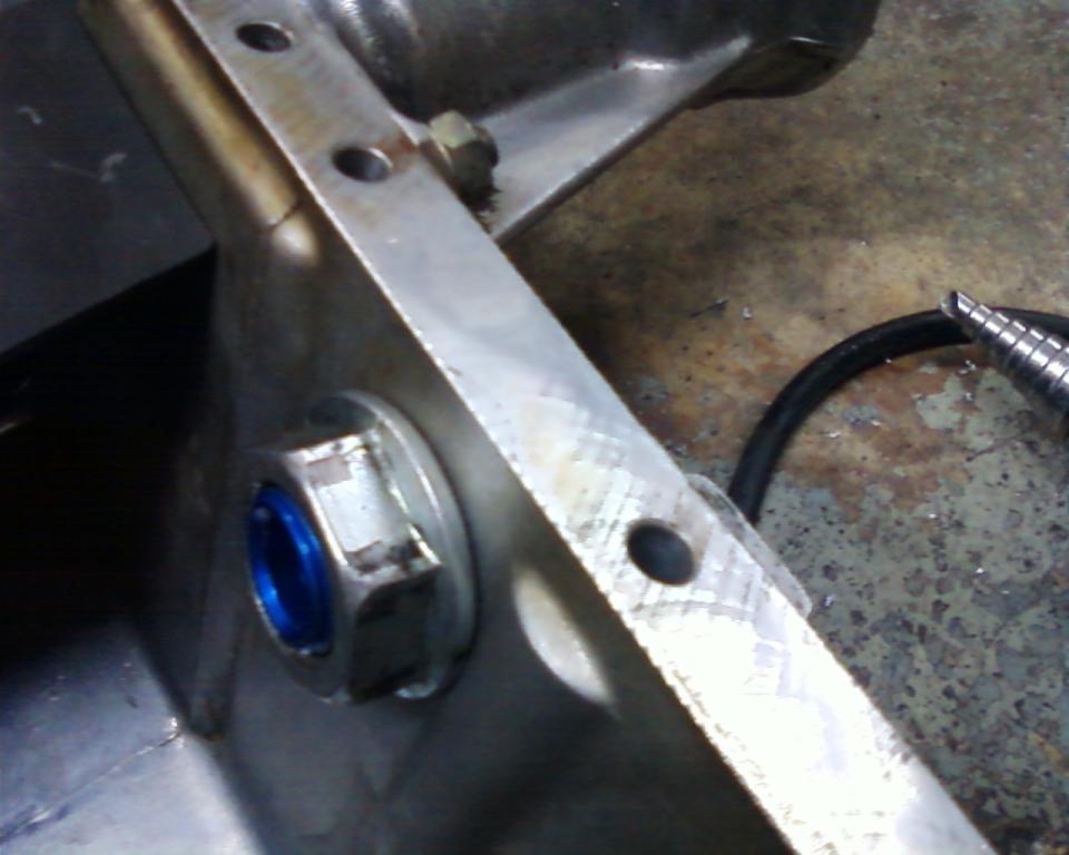

        Got the bottom end back from the machine shop yesterday and got it painted up. Hopefully I can get it all put together this coming weekend.
        IX being restored here
        Ix turbo build here
        • nomansland92
          • 1657
          #49
          Picture time!!!
          Built everything so I could just drop the car on to it
          In its new home
          Is almost done, I have to finish up some little things before I put the hood back on.
          I started breaking in the motor, I have about an hour on it so far and it seams to be running pretty good.
          Next to come is the turbo!
