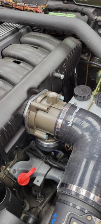

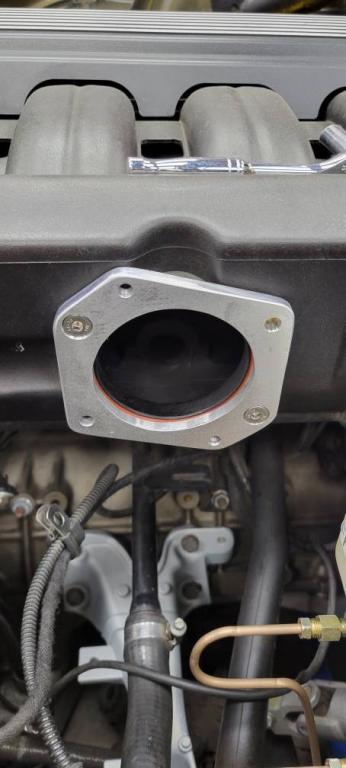

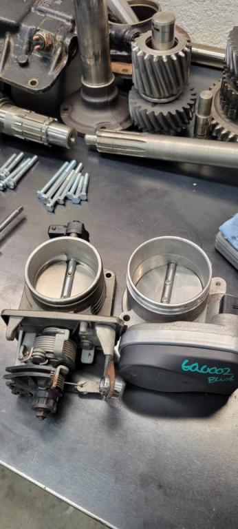

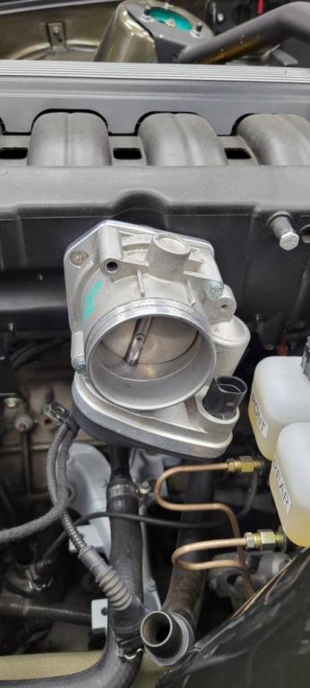

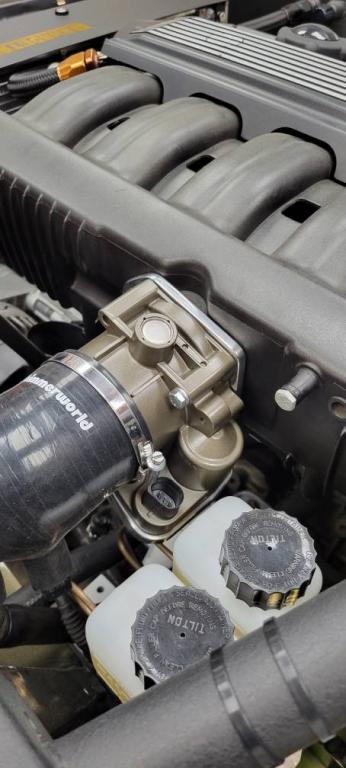

                    Anyway. What do we have going on here? That's an electronic throttle body from an M54 and homemade adapter plate. It also serves as an "oem" bbtb upgrade. I mightve gone a little excessive refurbishing and finishing the parts, but it looks awesome imo. E-throttle pedal is on the bench to be fitted next.
                    I am transitioning to standalone link ECU g4x xtreme with a custom dyno tune. Also working on getting modern wheel speed sensors adapted so we can do cool things like launch control, traction control and eventually modern ABS. This is a project I've looked forward to for a while.
