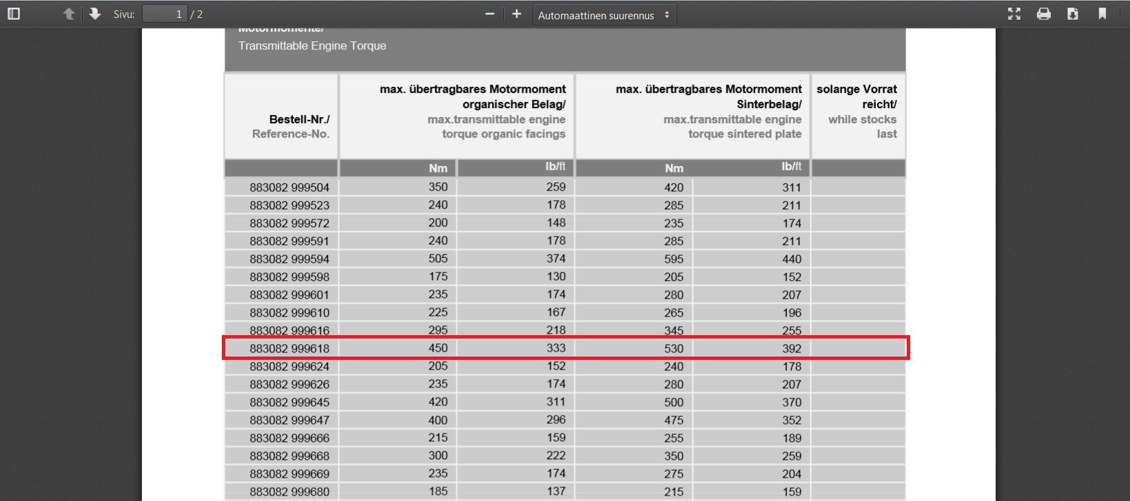

        Upgrading my clutch. About to buy Sachs SRE 618 pressure plate with SRE disc. Should handle the power well
        stock ix clutch kit

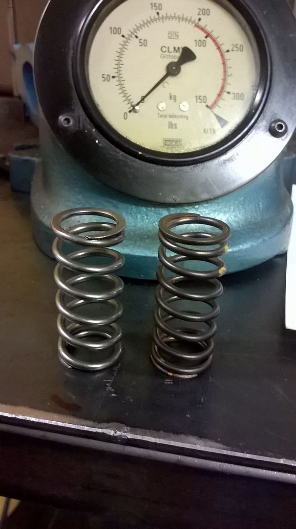

          Did some research through web for couple late nights. I didn't find what I was looking for. The pressures for the valve springs that I'm aiming is 45-50kg seat pressure and 95-105 at 12mm of lift.
          Today I went through my own spring collection and found out that fiat 8v twincam inner springs share same dimensions than m20 inners except they have thicker coil.
          fiat twincam left, bmw m20 right
          Measured with m20 outer spring

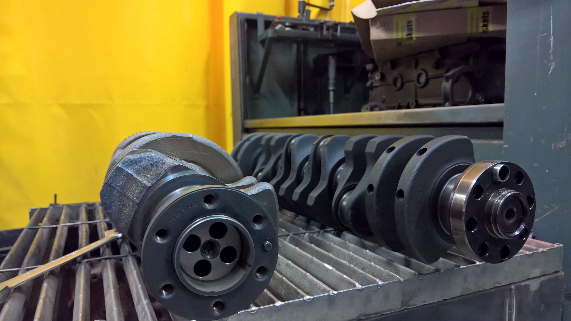

                        Had to remove that booster spacer to gain more clearance
                        Got the crankshaft pulley bored up and re-keyed

                            Modified crankshaft pulley
