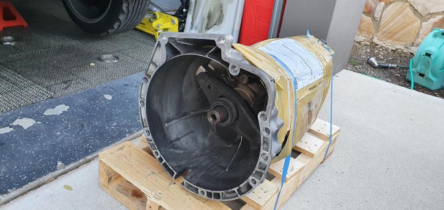

        #198
        New Gearbox has arrived. GS6-53BZ from e82 135i.
        Custom twin disk clutch from adamat will be mated with this.

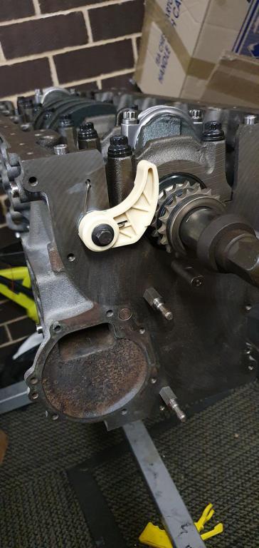

                            #208
                            Fitted the e46 accelerator pedal and the oil pump chain tensioner today.
                            Despite all the evidence out there of different ways to mount the pedal bracket that involve cutting, welding, epoxy etc. I just found that if it notched the metal mounting plate on top of the pedal bracket, that i could just use the stock mounts as is and use a hex head bolt to secure it to the old pedal stop.

                              #209
                              I want to see how this oil pump chain tensioner goes. Which one is that? The VW one or the S54? Something else?
