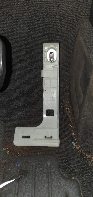

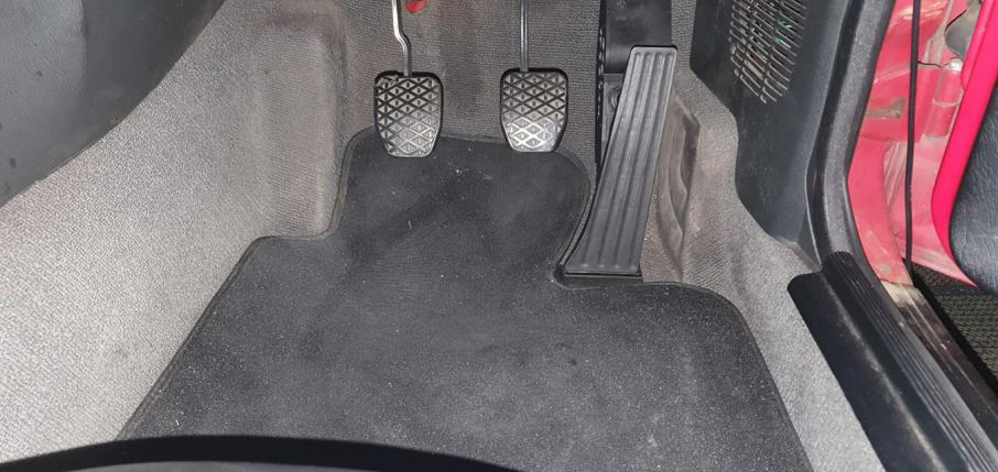

                          • ba114
                            • Sep 2015
                            • 364
                            #208
                            Fitted the e46 accelerator pedal and the oil pump chain tensioner today.
                            Despite all the evidence out there of different ways to mount the pedal bracket that involve cutting, welding, epoxy etc. I just found that if it notched the metal mounting plate on top of the pedal bracket, that i could just use the stock mounts as is and use a hex head bolt to secure it to the old pedal stop.
