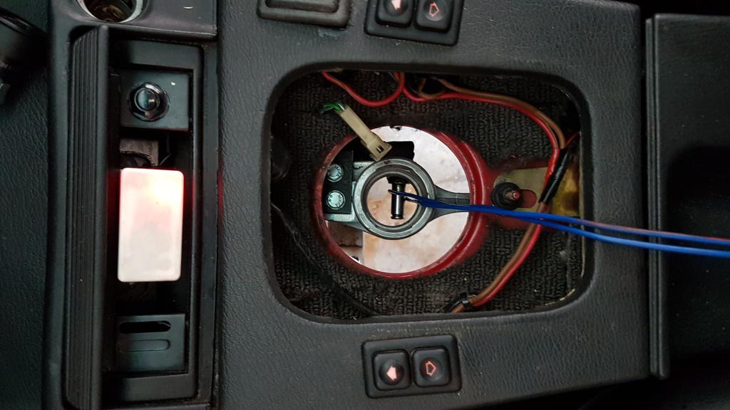

          #94
          Slow but steady progress.

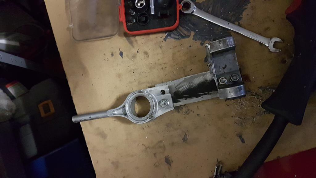

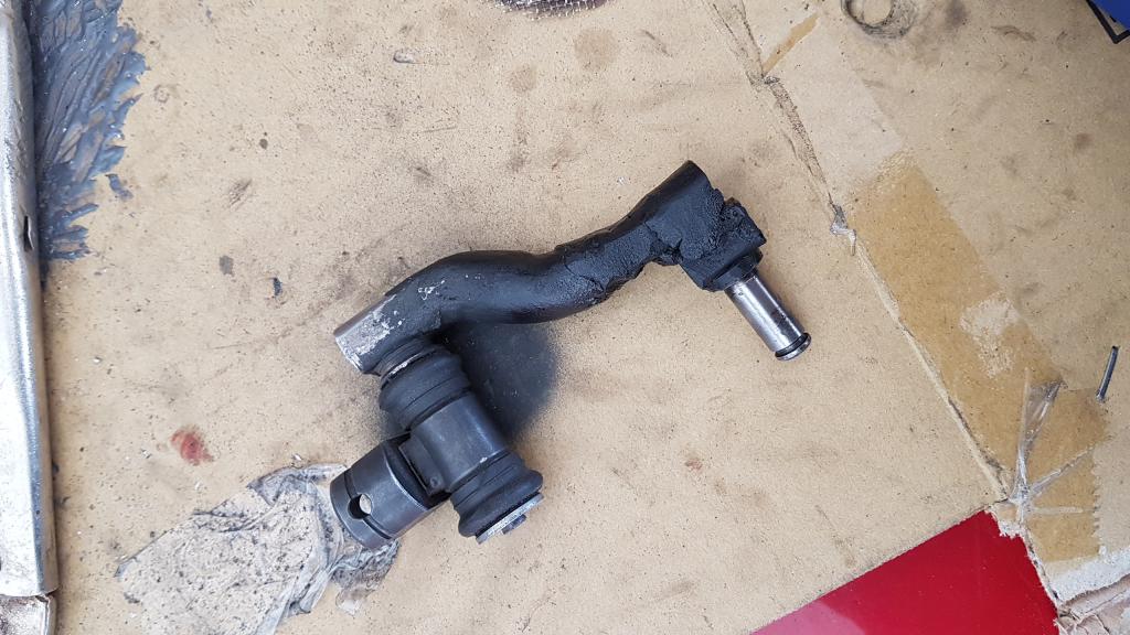

          Fitting the 6 speed diesel box definitely has its "intricacies" with the tilt of the box meaning the shift carrier sat nowhere near where it needed to.
          Eventually after lots of cuts, welds and whatever, the shift carrier and linkage aren't even close to resembling the original items. But finally got the angles and positioning basically spot on.
          Waiting on my shifter to arrive from the UK then I can put it in and bolt up the driveshaft and finally see this car move under its own power!

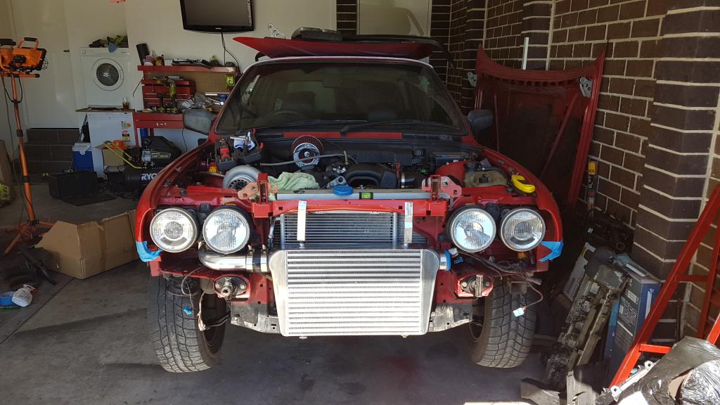

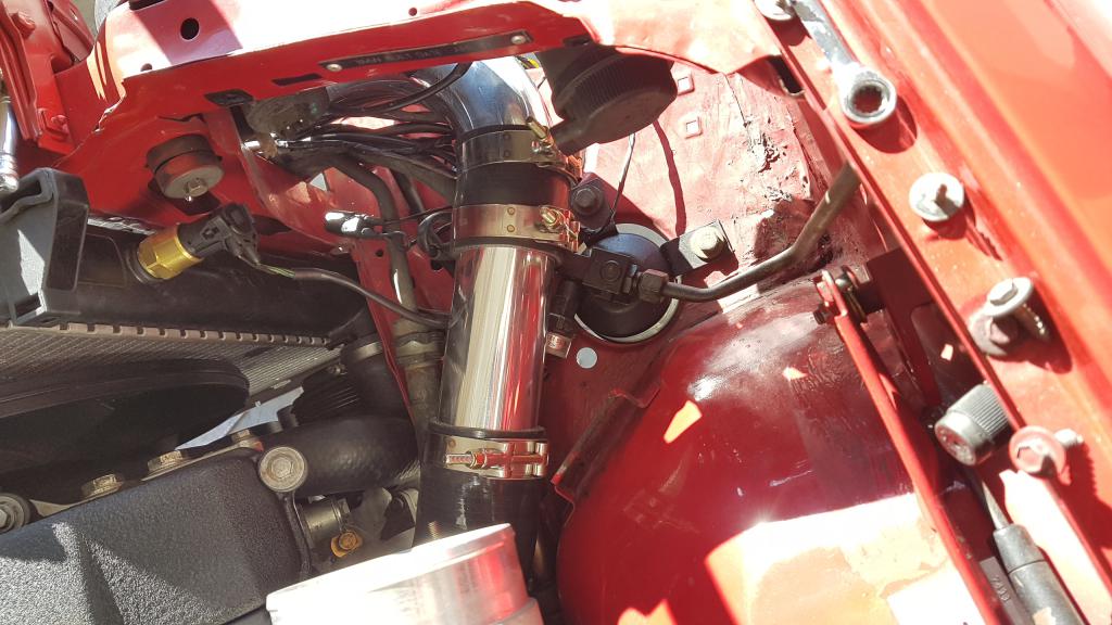

                      #100

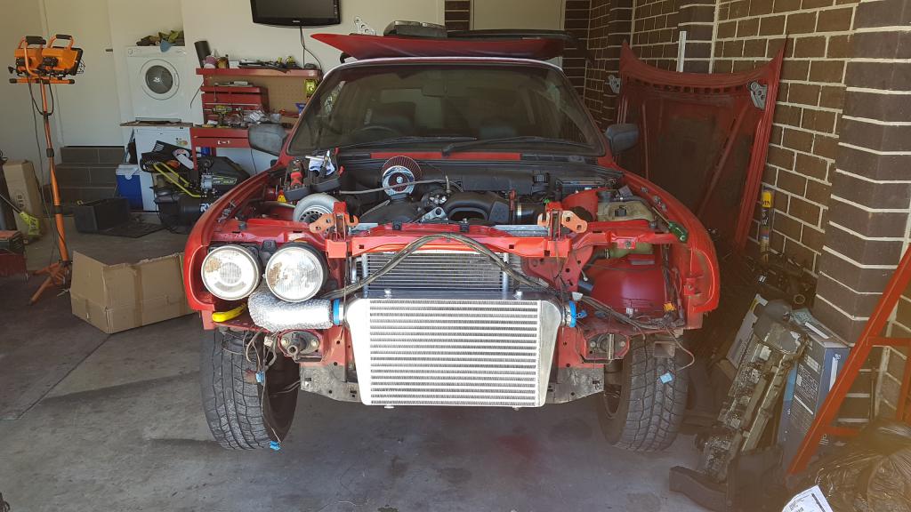

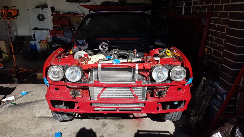

                      Fitted up the FMIC yesterday. Got it pretty much perfect fitment wise.
                      It's a 450x300x76mm core with 2.5" inlet/outlet.
                      Only hiccup is I need a longer 3" to 2.5" 90 degree reducer to connect to my maf tube.
                      Those with a keen eye will spot that I have retained a new parallel core a/c condenser and the stock hose routing made to work. No fan unfortunately but we'll see how good a job the diesel clutch fan does at drawing through air at idle.
                      Also safety wired the radiator into the bottom of the core support and gained about 5mm more clearance from the a/c compressor pulley.

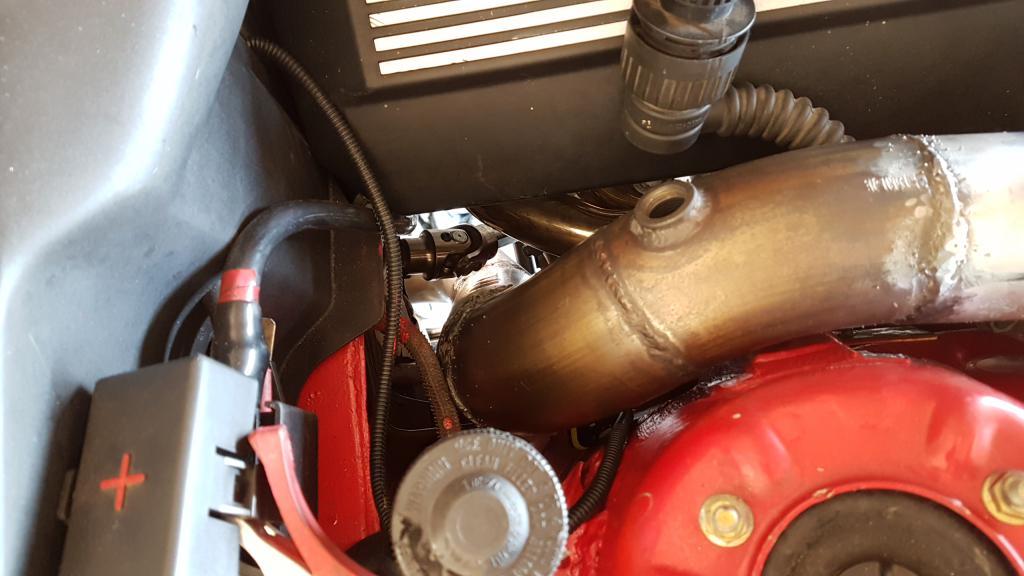

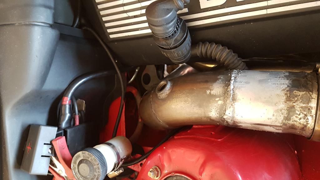

                            #103

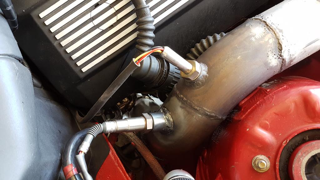

                            Downpipe done! After thinking this was going to be my most difficult job, I was incredibly lucky with getting the angles perfect first try. Yes the welds are horrible again, however I pressure tested the pipe to 20psi and found no leaks so that all that matters really.
                            RHD OBD2 M50b25 turbo build thread:
                            http://www.r3vlimited.com/board/showthread.php?t=384800

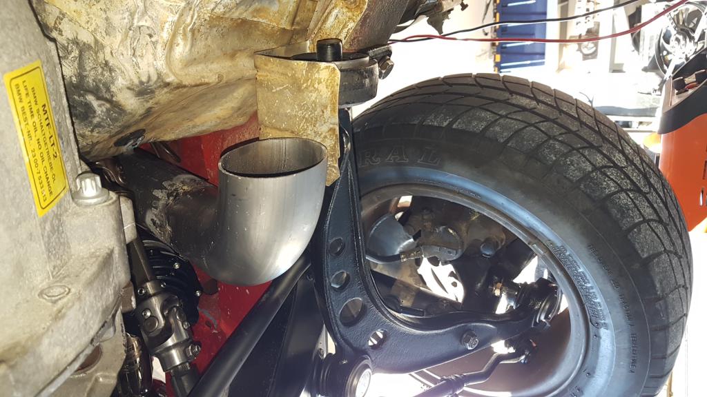

                              #104
                              Welded a bung in the downpipe for my wideband today. I got my argon/co2 gas mix in finally and some solid core wire for the mig. Wow, this is what I've been missing out on by using shitty Flux core. The welds still very average but SO much better than before!
                              Other things I've been working on include re-fitting the deka 80lb injectors. Had issues with the Orings leaking and messing with my idle so swapped them from the 19lb and lubed with oil and all good.

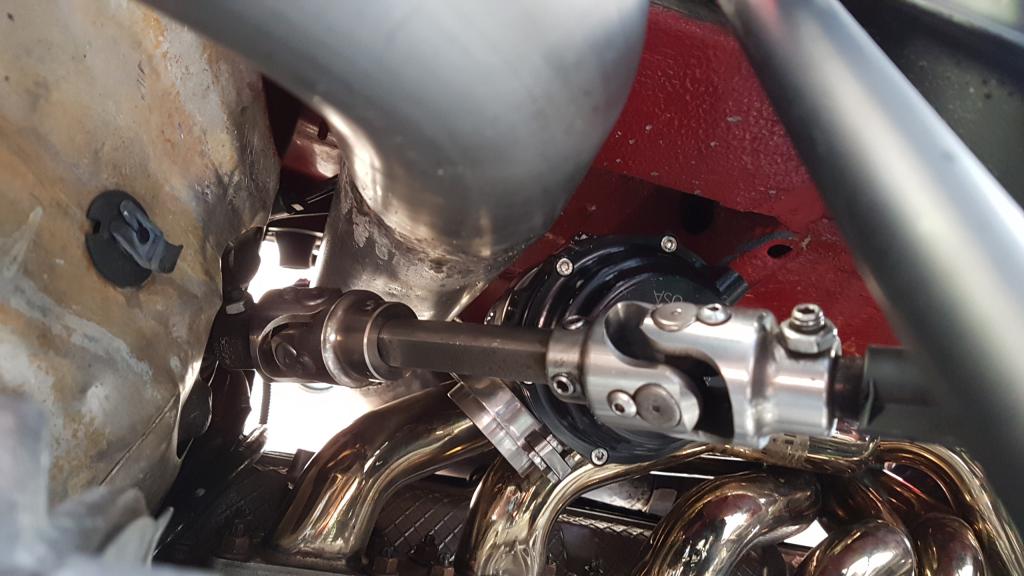

                              Need to find a flange for the downpipe that will fit through the tiny space available between the waste gate and the steering shafts. A normal vband won't fit...

                                #105
                                Build progress is great. You might want to give yourself a little more room on the DP as the engine rocks that direction under load. I found out the hard way.
