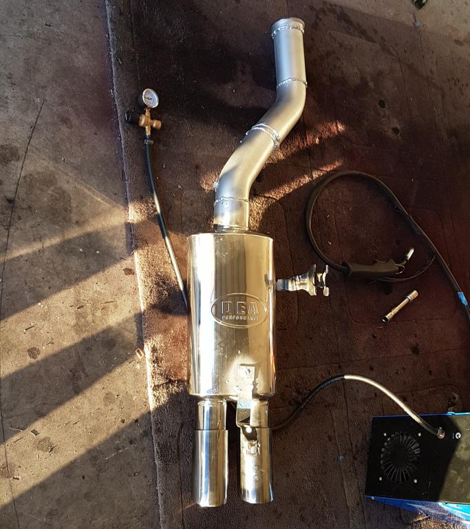

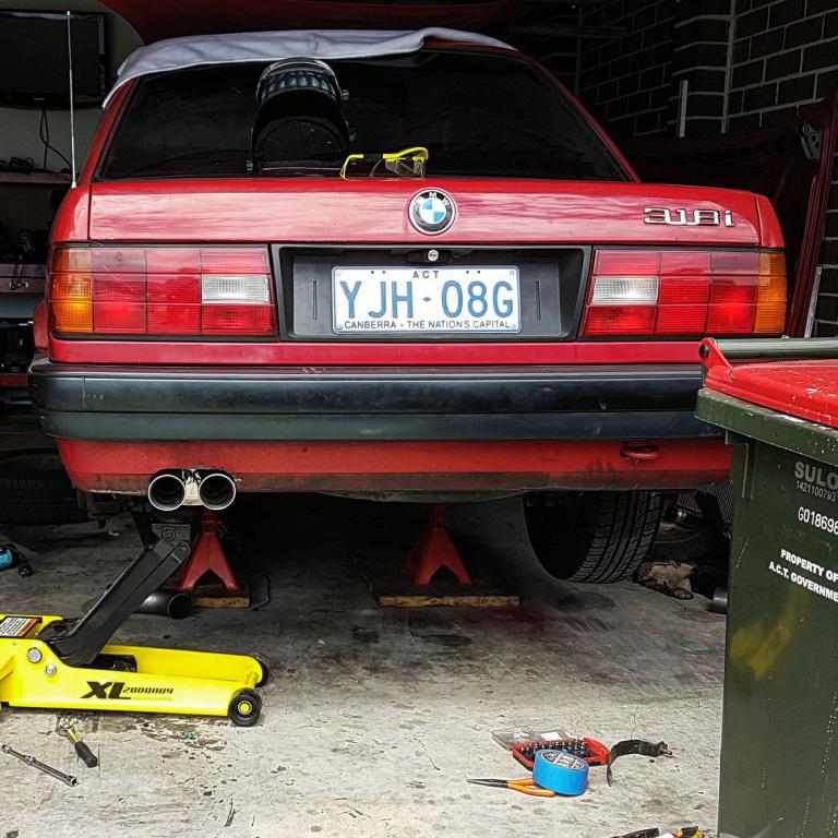

          fitted the muffler yesterday. As this is a 318i shell, it only had the cutout in the rear valance for a single tip. I traced the outline of the curve onto some cardboard and copied it onto to valance before cutting with an angle grinder and tidied up with a grinding bit on the dremel. Turned out pretty close i think! For fitting the muffler, i used the original hanger locations with hacked up stock muffler cages. Also used the rear most headshield stud to keep the tips in position where i wanted it.
          Have welded the pipe work from the muffler up until the hanger location under the rear subframe where i have put a vband clamp so that the centre section of the exhaust can be separated from the rear. I would have liked to have finished it this weekend but i need to get a couple more bends before i can mate it up with the rest of the exhaust but i'm glad its getting closer! My flanges for the downpipe should be here on tuesday/wednesday so hopefully that'll be the last of it.

            Finished the back third of the exhaust and picked up a

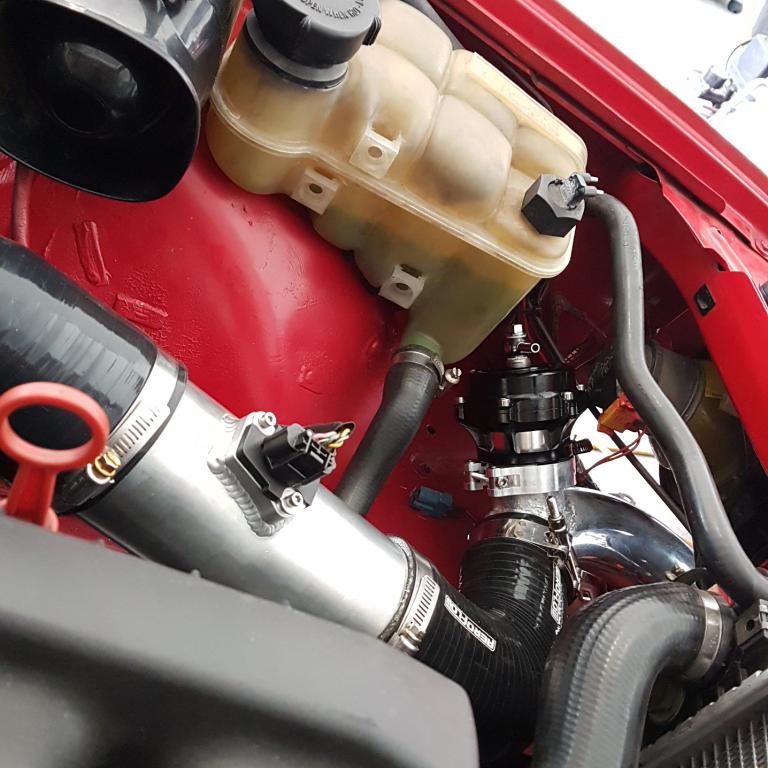

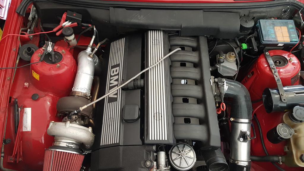

              Nothing major today. Fitted the tialQ BOV.

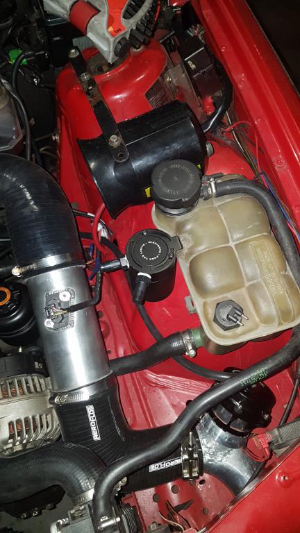

                - Found a place to mount my catch can. The mishimoto bracket slots into the space on the coolant reservoir with only minor mods
                - Welded a new flange to end of my downpipe so i can mate it to the rest of the exhaust

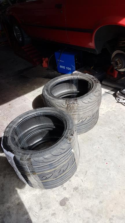

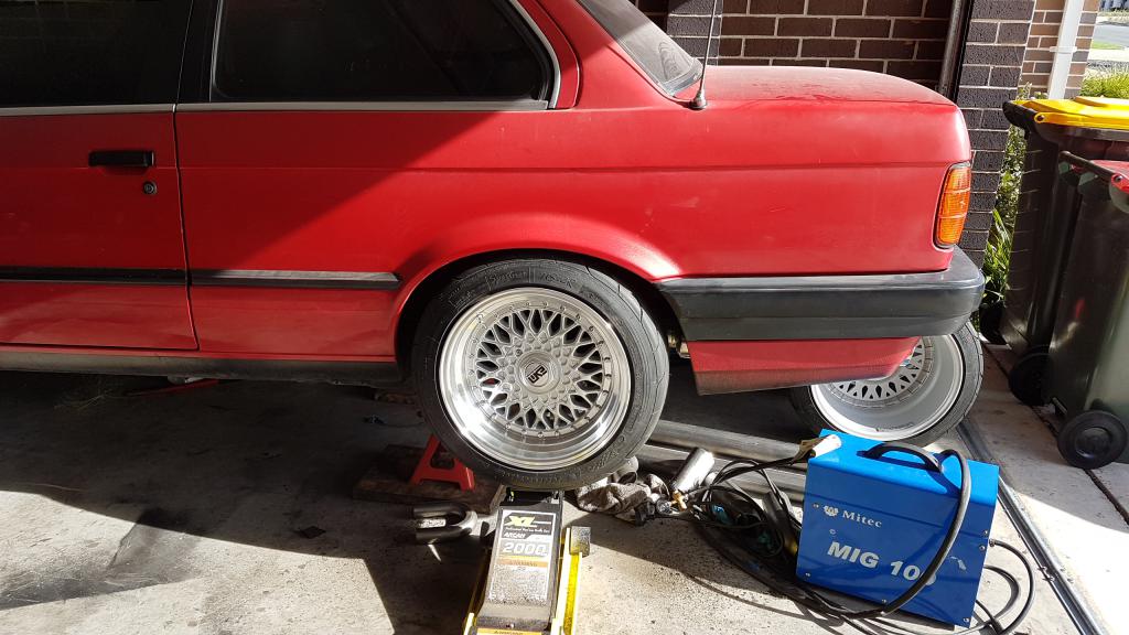

                - New tyres arrived for the ESM-002Rs. I went with Nankang NS2R semi-slicks in 205/45/16 for the front and 225/45/16 for the rears. Will get them mounted next week and see how the fitment is.

                  I modified the coil wiring harness so that it exits out of the beauty cover instead of next to the downpipe. Was pretty simple, just opened the wiring cover, cut a groove directly opposite where the existing plug exit was and put it back together.
                  Then just cut the beauty cover where it exits. Not the cleanest example, but should work well.
                  I also wired up the wideband display i bought from george graves. All went smoothly and easily enough. I used the radio switched 12v, ground and illumination wires and the ground and 5v from the innovate lc-2 controller grounds.

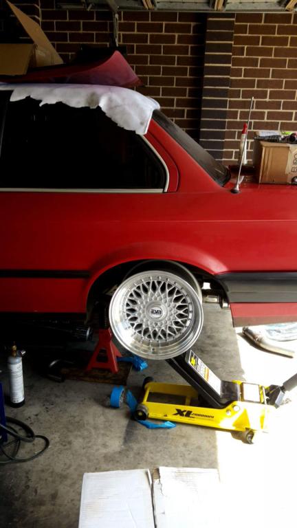

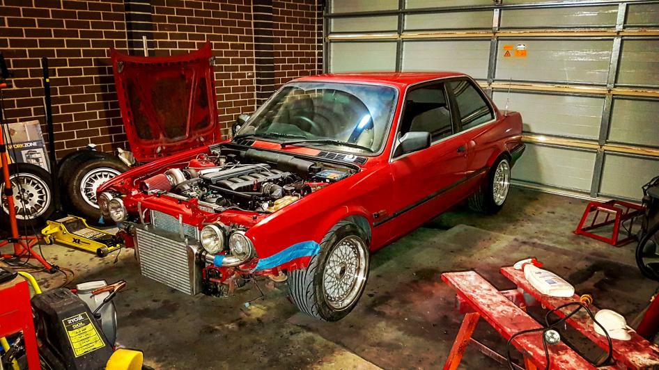

                    Testing fitment.... guards need rolling and minor pumping.

                      #115

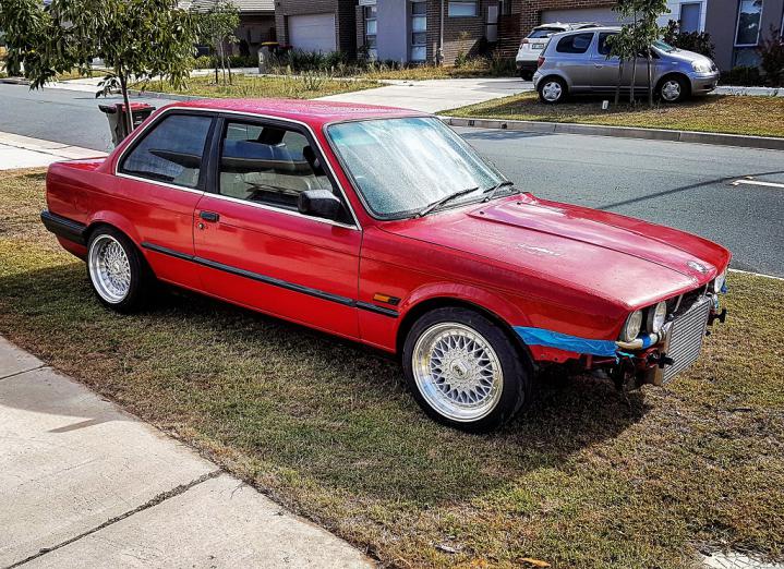

                      And now on the ground. Finished the exhaust today. Not doing that job again. It fits, it works, but it hangs too low. Oh well.
                      Guards being rolled tomorrow
