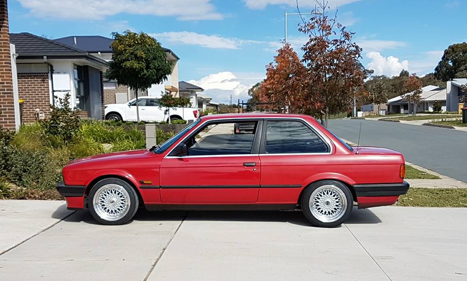

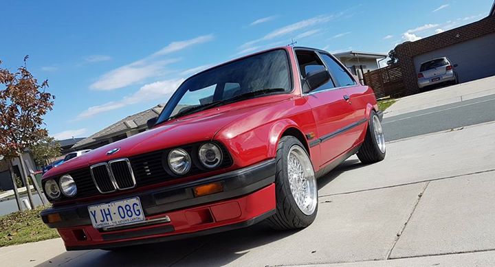

              Couple pics following a bit of a cruise yesterday

              http://www.r3vlimited.com/board/showthread.php?t=384800

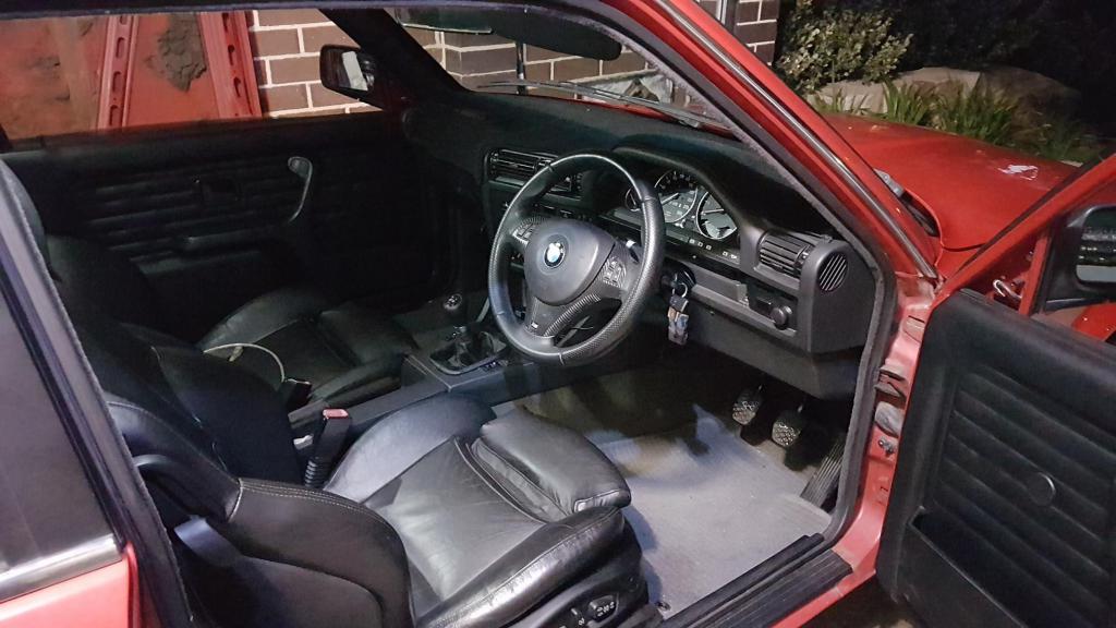

                  Updated interior pic after fitting led interior bulbs.
                  Also hooked up my defi advance clone in the air vent. Only shows boost, rpm and speed in the video but have since wired in oil pressure, oil temp and fuel pressure.

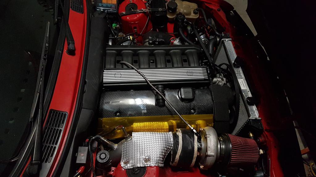

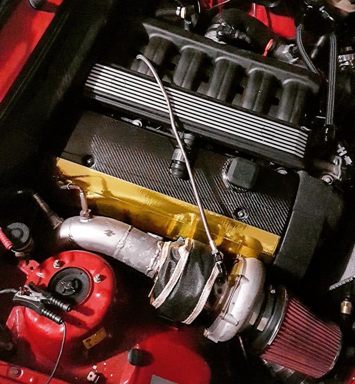

                          Had a little fire due to the beauty cover melting and dripping onto the downpipe. Melted the coil harness under it too.
                          No major damage. Was likely caused due to high EGTs from running too low timing by accident.
                          Anyway bought a new coil harness and a carbon fiber beauty cover that won't melt. Put some gold tape over it to hopefully lower the temps under the cover too.
                          Now I can get back to tuning!

                                Was experiencing a new ticking/flutter noise from the engine that had me concerned maybe i'd caused some damage when i was overboosting. Didn't have much luck on the weekend finding the source of the ticking noise. After a drive i couldn't actually notice it, however it was back again the next time i started it so it may infact just be lifter tick.
                                Did some other work on the weekend including wiring in my MAC solenoid to the TEV (charcoal canister purge) wiring for use as boost control.
                                Also fabricated a heat shield for the downpipe which will hopefully further prevent chances of melting anything else in future.
