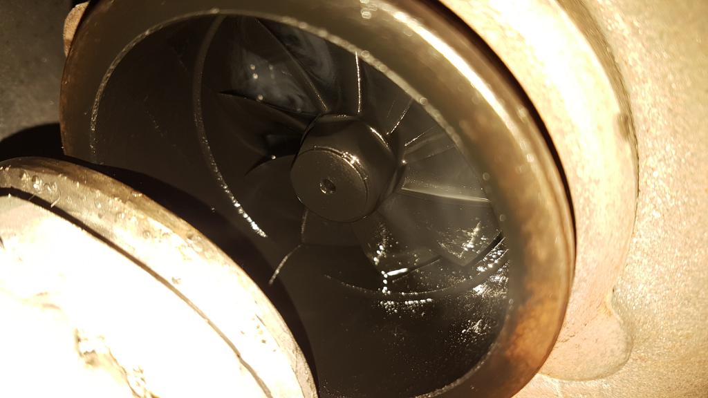

          #124
          Definitely an oil issue... started up today briefly and then shut down due to smoke.
          Pulled the downpipe and was greeted with this
          RHD OBD2 M50b25 turbo build thread:
          http://www.r3vlimited.com/board/showthread.php?t=384800
          • Northern
            I like cupcakes & sh!tboxes
            • 5286
            #125
            Just a little oil, lol

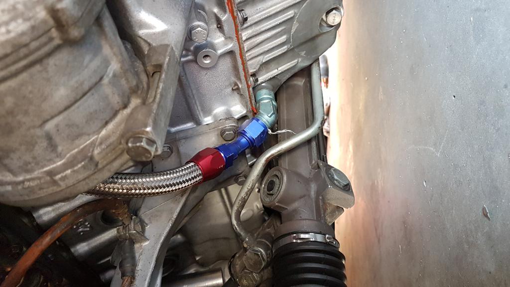

                        #131
                        Ba114 how is your turbo oil return? Where is it located? Is it under the oil level or over?
                        • ba114
                          • Sep 2015
                          • 364
                          #132
                          Oil return is as high up on the pan as I could get it without interference.
                          • pazi88
                            • Sep 2015
                            • 584
                            #133
                            That is clearly under oil level and depending on the turbo that could cause broblems. The front cover is very good place to put the oil return.
                            • Northern
                              • 5286
                              #134
                              That would be under the oil level when the engine is off, but I would find it hard to believe the oil would be anywhere near that height while the engine is running.
                              Any chance the drain is kinked or otherwise collapsed?
                              If that's -10 with a -4 feed, and it is clocked near 0deg as the pictures show, I really don't think it should be a problem.
                              I mean, Pazi and I have our drains higher on the block/timing cover, but there are dozens of people on BF.C draining directly back to the pan as you are.
                              Originally posted by priapism
                              Originally posted by shameson
                              • pazi88
                                • Sep 2015
                                • 584
                                #135
                                Yes there are. But As I said that depends on a what turbo is used.
