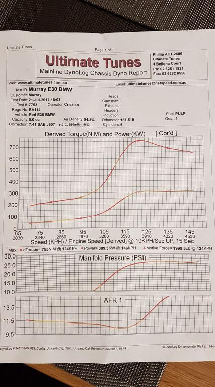

          Fixed some exhaust leaks. Had lost two nuts off the manifold flange and the rest had loosed enough to cause some leaks.
          The turbo flange had also loosened enough to blow out the crappy gasket that came with the manifold so replaced that with a steel one and all is well again.
          Also had a dyno day last friday to see how its running. I'd managed to implement boost control using the evap purge output and a MAC valve thanks to some help from mrf582 at romraider and it worked flawlessly holding boost perfectly!
          End result was 309kw (415hp) on a mainline dyno. We dont have dynojet over here in Australia however it appears that mainline is upto 20% lower than dynojet which *could* mean if i tested in the US, i would be around 500hp.
          Unfortunately i didnt get external video of the power run, only the first complete run however it was still wheelspinning on the dyno. To get the final run in they had to sit a person in the back seat and two people in the boot.
          Dyno Video
          Unfortunately i also maxed the DME load limits once again which resulted in a pretty lean condition at the end of the run. Obviously i could never get to that limit on the road so never expected i'd hit it again.
          I was very pleased that my open loop fueling was pretty much where i wanted it to be (around 11:1) throughout the run prior to this though.
          I've already halved all the load values in the DME once before. Have halved them again now so that issue is addressed.

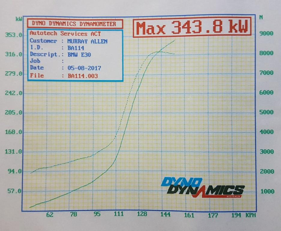

            #155
            New dyno results.
            Still have some work to do up top in the fueling, but the results speak for themselves :)
            Think im out of fuel now too with my 340lph pump. Have ordered a walbro 450 to replace it.
