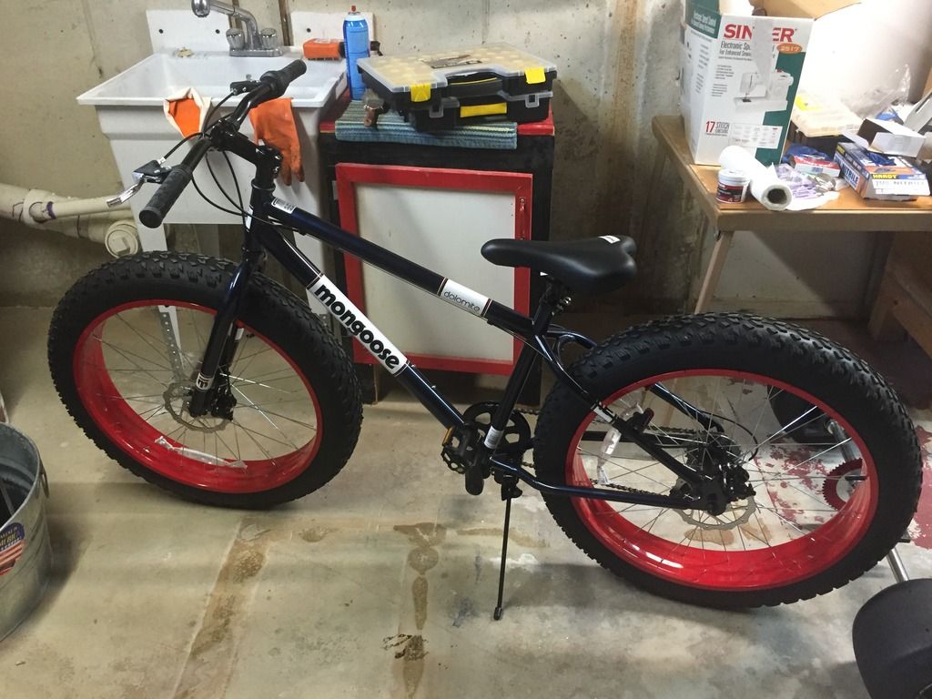

    Source parts was pretty easy. They sell a trike axle kit on ebay. I bought a set of used racing wheels and tires on ebay as well. The front end was tricky. It was cheaper to buy a whole bike and chop it up than buying the forks, rim, disk brakes and inner tube and tire.
    This was $200 on amazon and comes with disk brakes.

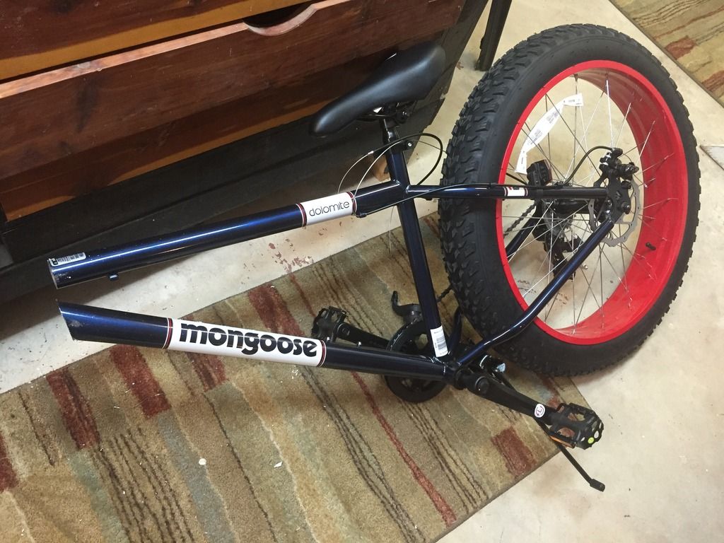

    Took it for a lap and it was pretty fun. It was shame I had to cut it up. Oh well! no turning back

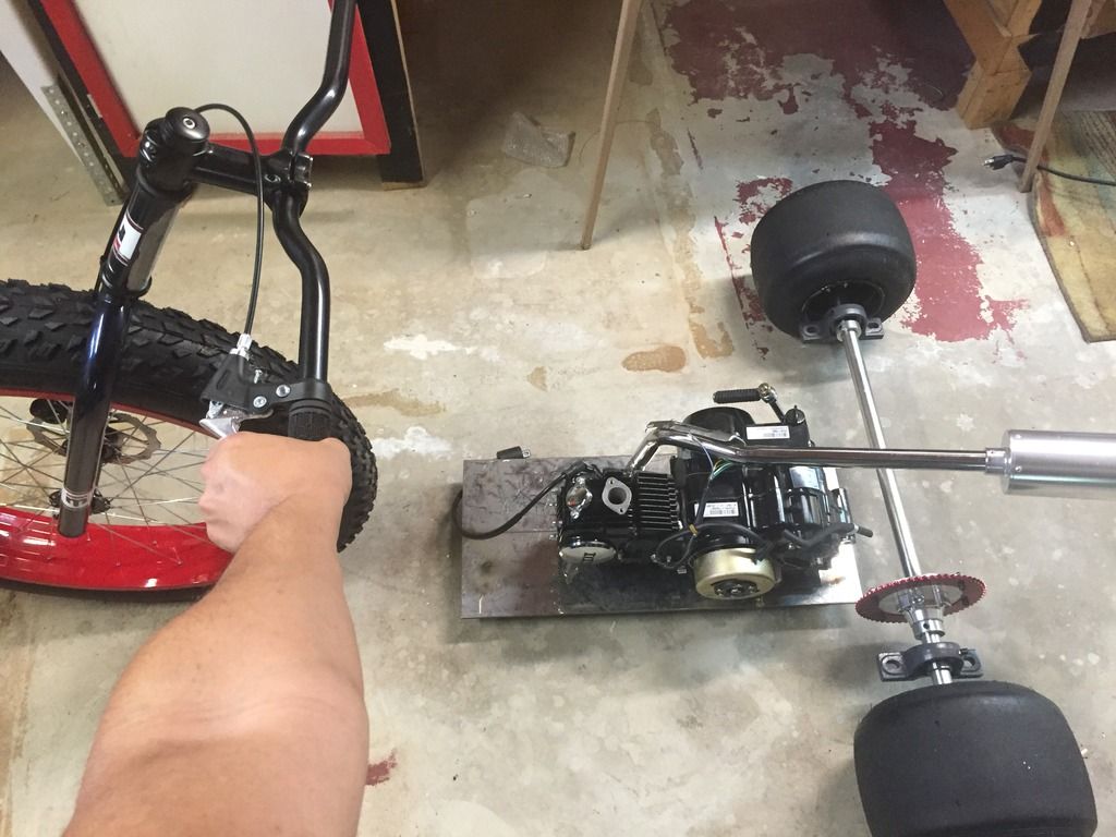

    I got a Lifan 125 on ebay for $300. Its kick start, but lifan 125s with electric start and semi auto trans is a rare find. I didn't want to be messing with clutches.

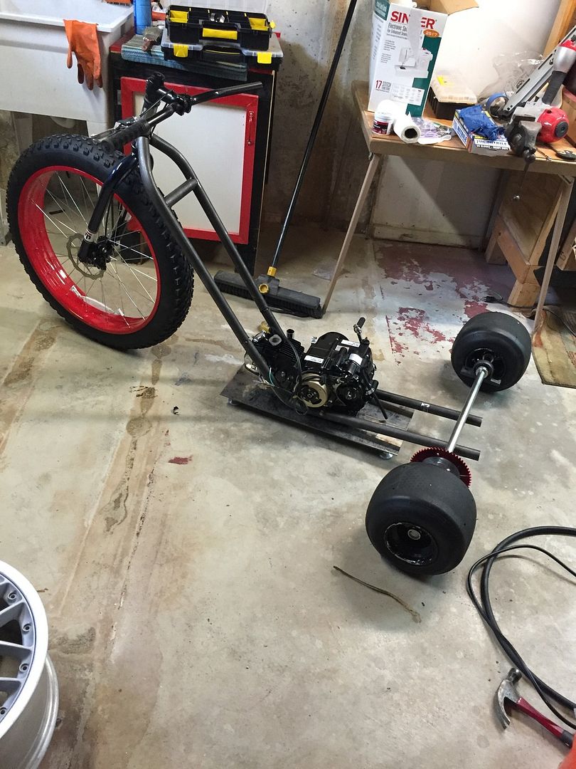

    Here is the bars, axel and engine to get an idea for space.
    I wanted the motor so sit forward as much as possible to distribute the weight as well as make the jockey shifter more accessible. This is about as much engineering I did on this build. I have an engineering background so i did measure and stuff, but as far as design, i had an idea in my head and now i'm just winging it.

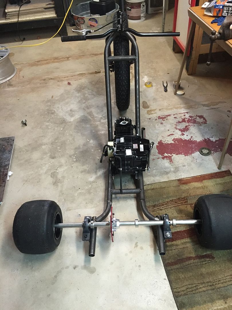

    here is i bent some DOM tubing to do the frame. I was just getting an idea on the angle since i wanted to go around the cylinder head and clear the spark plug and exhaust. I did not like the how steep the angle of the headset was so I had to go for more stretch. Side note - I only had a tig welder, but i decided since i was tacking so many parts I bought a 140 amp mig off amazon. I own a business so the motor, welder, and bike were purchased with points. This is how I got away with keeping this a secret from my wife so far.
    Something like this
    the rear sprocket interfered with the tube so I had to flare the rear end to make room for the sprocket and brake disk. Where I joined two tubes I machined a pipe to fit the ID to give the joint more strength and plug welded it as well as weld the seam
    Piping was notched using a notcher I bought as a garage sale for 10. I had to machine a new bronze sleeve bearing for it, but over all it does a nice job.

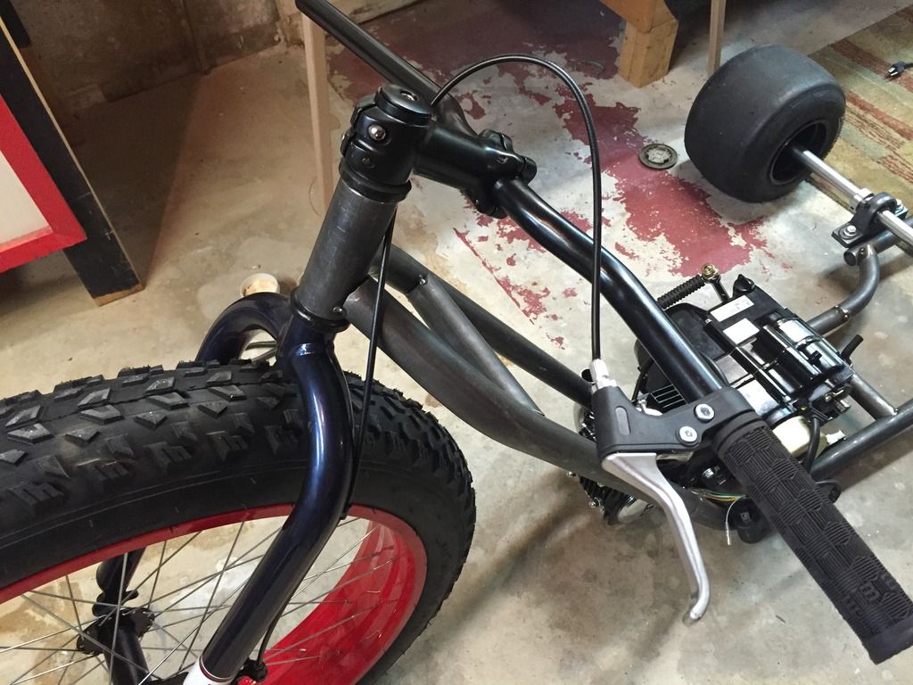

    The headset tube off the bike frame I cut off was was super long and the material was pretty thin. I machined a new one from DOM tubing to accept the bearings and chopped the whole assembly down. Also flipped the bares and headset.

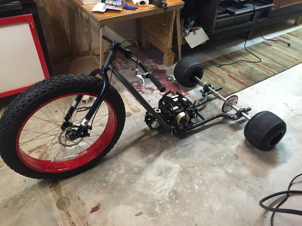

    How it sits now.

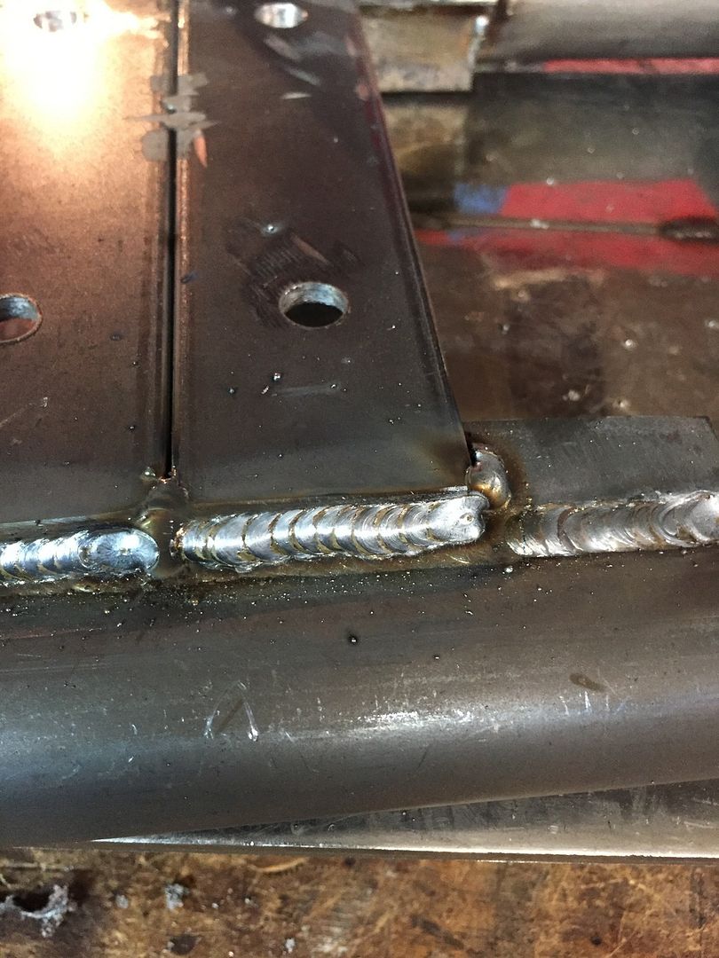

    This is like my 5th string of mig welds I've done in my life. I was going to just tack most of the trike and tig all of it. I've found this triike is given me a good opportunity to play with the welder.

            Yes the trikes build with the lawnmower based engines like the 212cc predator are mounted in the rear. This pit bike engine is air cooled so you do need some decent flow. It's also mounted to a trans so making a linkage from the rear to something reachable in the front would suck. This engine is also kick started so I need to be able to twist the throttle too.
            The 212cc predator engines are rated 6.5hp peak. The lifan 125 is rated 11.5 peak hp and revs to like 7k while the predator revs to like 3.5k. They can modded to removed the governor and put a new carb and jets on them. But at that point they would cost more than the pitbike motor I got. Plus mine is geared to hit 60pm lol plus have tons of torque with the gearing. J

              My question is how are you going to run the chain to the sprocket without having the seat high?
              Edit: I guess it's pretty obvious that the seat will be higher than the chain lol, and it doesn't look really high.

                Seat wil be above the motor slightly behind it
