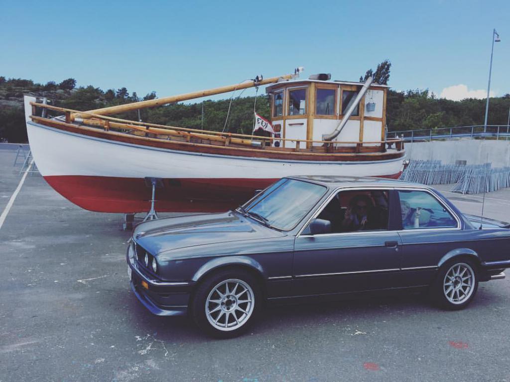

    Hi.
    I´m new on this forum and I have just gone through your thread with great interest! You have a beautiful car!
    Myself i have a dolphin grey 1987 325iS with a M20B30 with RHD ITB's and running on E85.
    I am currently adding the extra vacuum runners and vacuum plenum to my car aswell. Planning to use idle control valve and vacuum for FPR.
    But i am also thinking about using a hybrid map using TPS and MAP-sensor to get better driveability and idle.
    Would be great to see any update in this thread!
    Added a pic of my car, but i only had one of my boat aswell. BTW i'm from Sweden and my car is probably the only E30 running RHD ITB in the whole country.
    Best regards!
