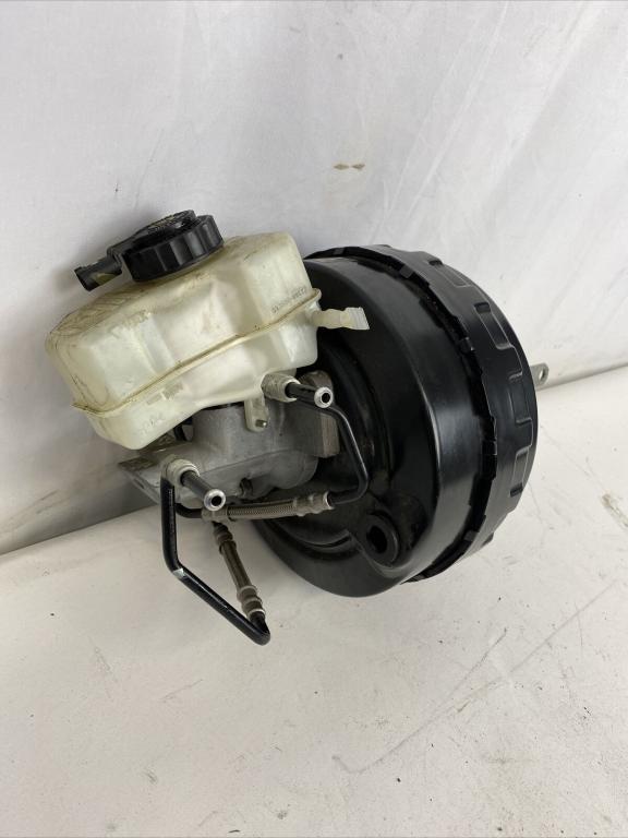

                              I need a booster/master as the car didn't come with one. I purchased an E90 booster/master/res to see how that compares to the ix setup.

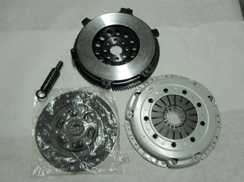

                              Flywheel/clutch/pp: I bought a single mass conversion kit. I should've bought an FX Stage 3 kit like my other car, but they shot up another $150 right before I went to order, so I went with something cheaper. A gamble, but it was cheaper than just the flywheel by itself.
