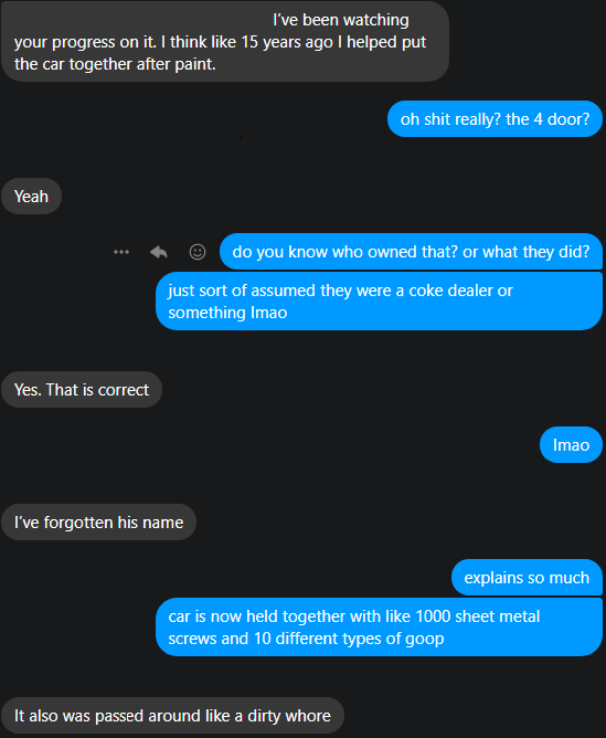

          An old friend gave some insight into this car's history. I find it very fitting really.
Name:	Screenshot 2020-11-10 185727.png
          In light of this new information, a thread title change was required...
