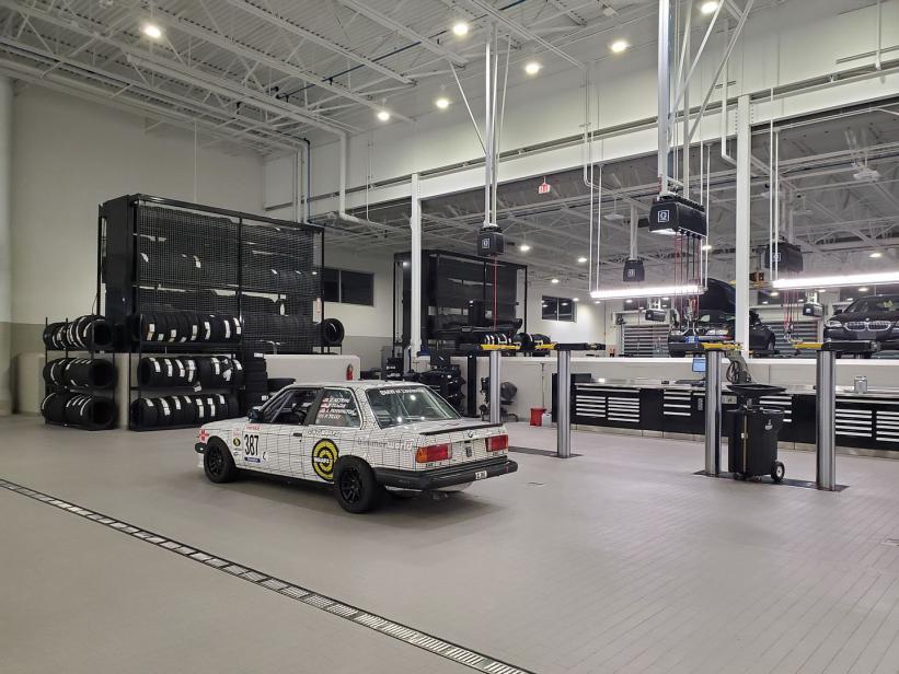

                        Our car at the local BMW Of Louisville Holiday Party

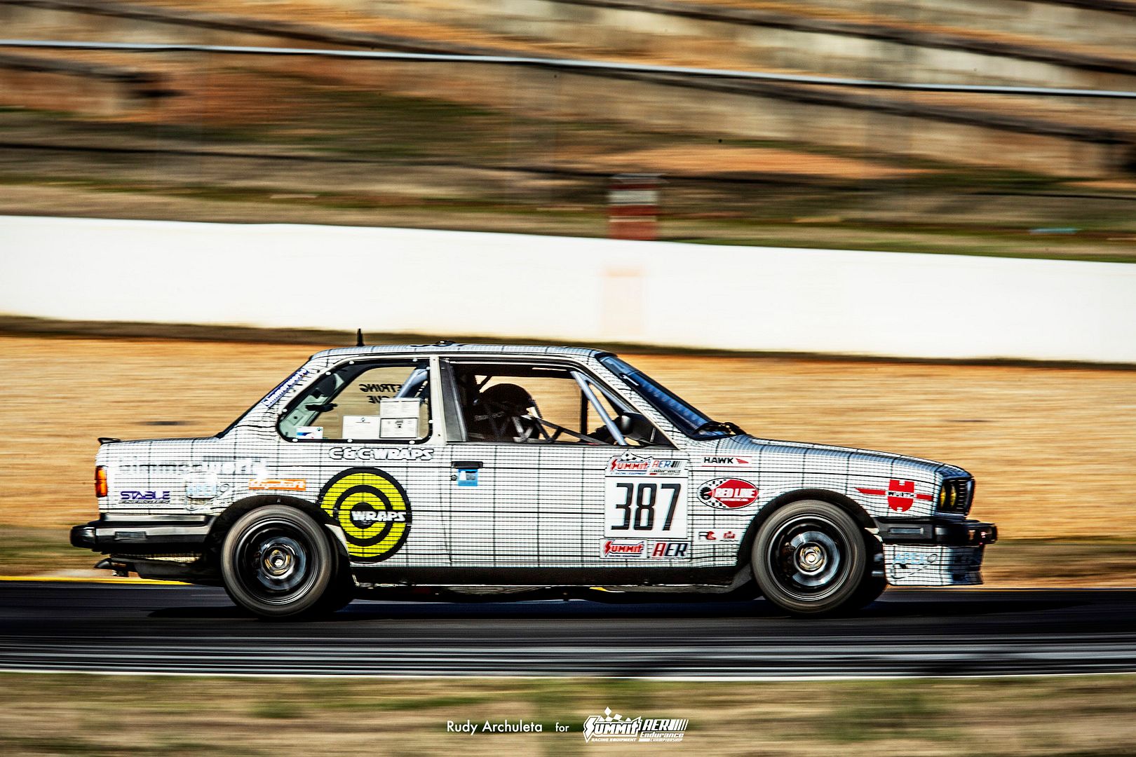

                        Racecar does make its American Endurance Racing debut..
                        American Endurance Racing (AER) is a amateur-focused endurance racing series built around smart classing, clean competition, and real-world affordability. Instead of gimmicks or arbitrary formulas, AER uses a transparent performance-based classing system that rewards thoughtful builds and good driving. The racing is competitive without being chaotic, with an emphasis on respect and racecraft
                        Its really hard to do both Lachs and the Racecar, and sometimes, just one of them... But I think I posted about the car getting wrecked out of its first ever race mid 2019. ChampCar, we were warned... And it happened within the first hour... Anyway our goal was to do a race in Champcar, WRL, and AER to see where we wanted to be.. Poor liability for the car to try out Champcar...

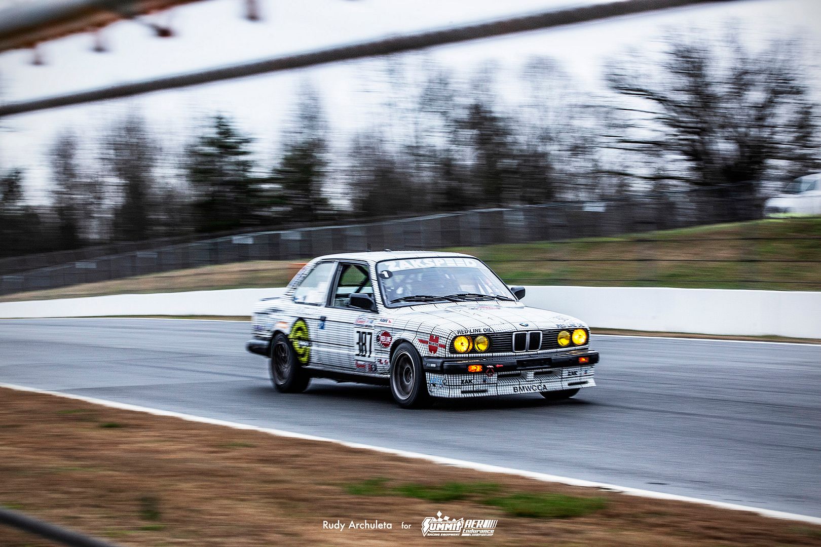

                        Anyways, Here were are prepping for Road Atlanta in February 2020. Getting our bins of parts, gear, and food sorted. We acquired a few sponsors too!
                        And were off!
                        A bit cold, but not bad, chilly nights for camping but we manage.

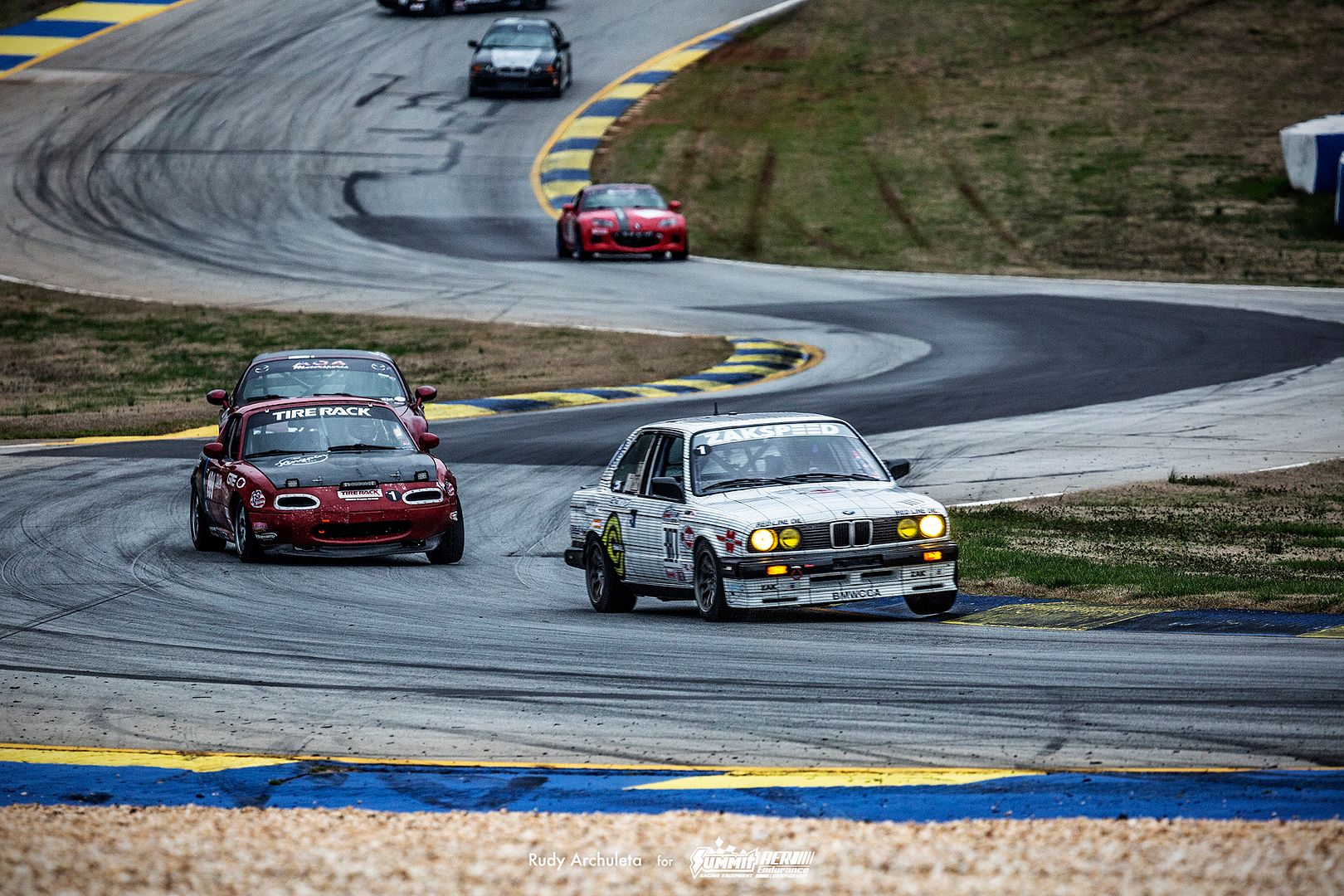

                        These Miatas were quick! Wait, well... they had some fast drivers! Either way we had to work to keep up with them.
