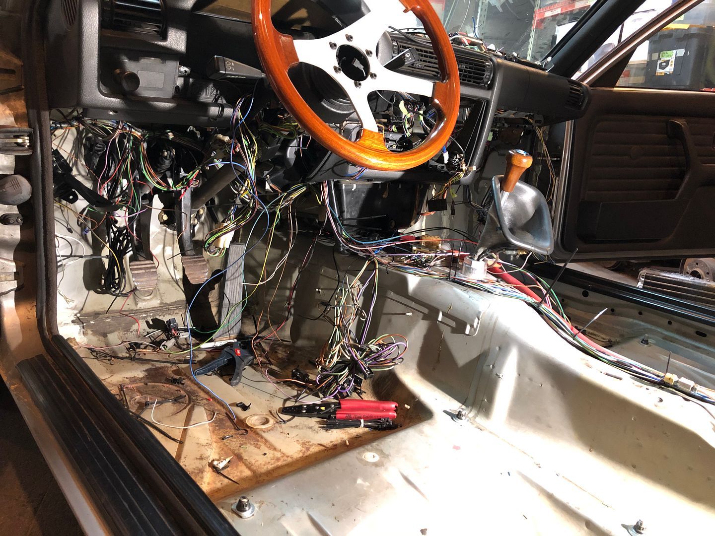

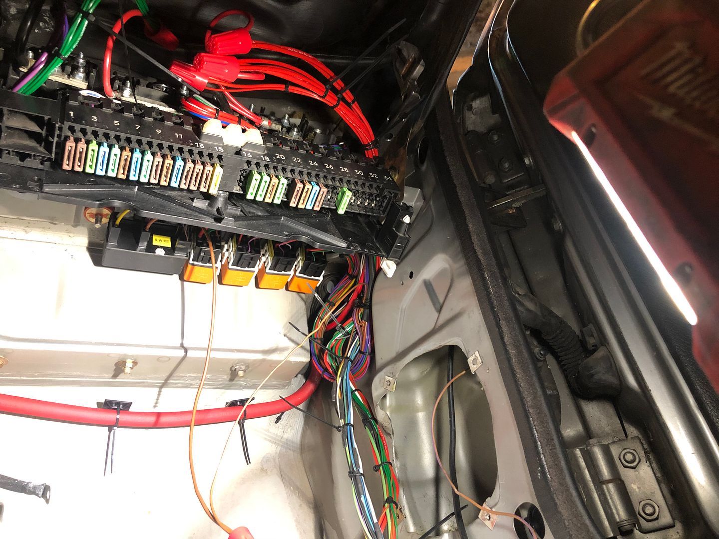

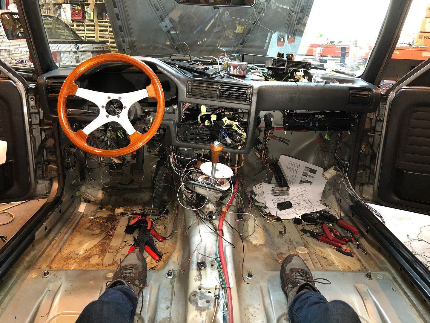

    Wiring is always a big job. Once you can let your mind calm down to all the task involved, I think its pretty relaxing.
    Sorting out how and if this E46 Fuse box idea would even work. But Looking good!

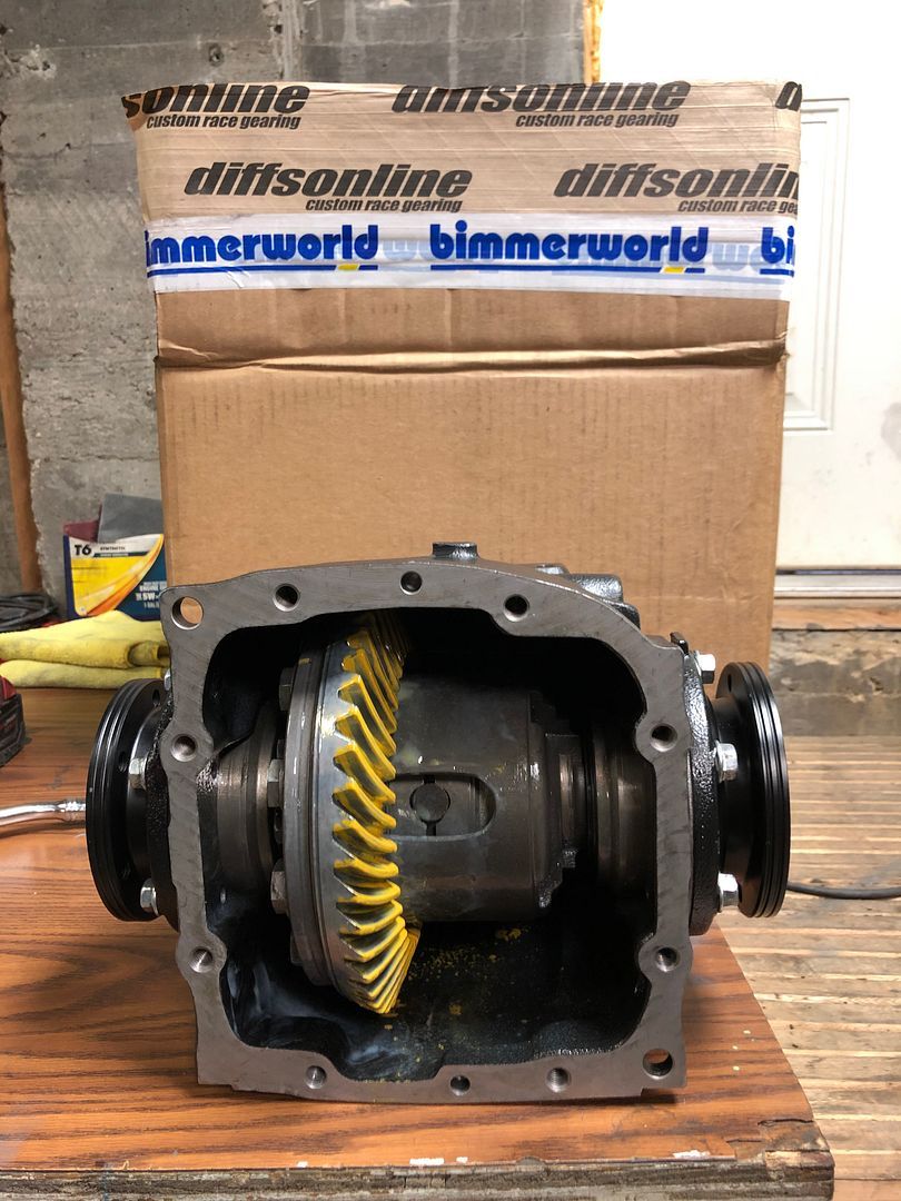

    Meanwhile my 3:25 REM polished 4 clutch setup has arrived, One quirk about having a Ti. I was able to install it in there and break it in easy on the street.

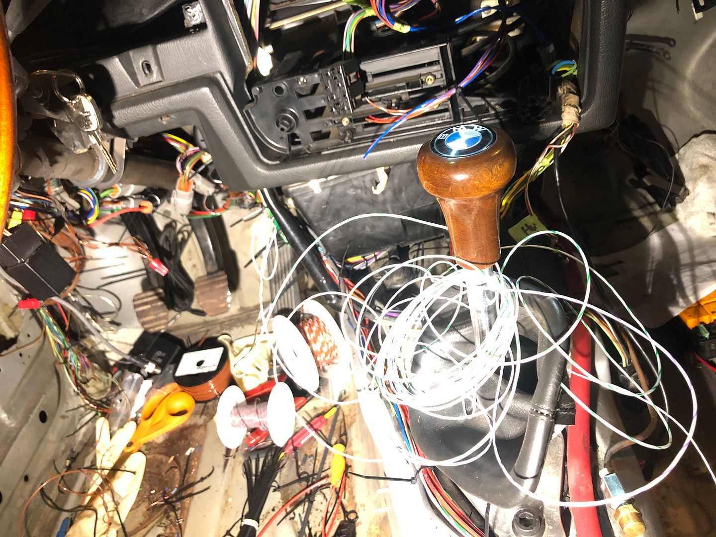

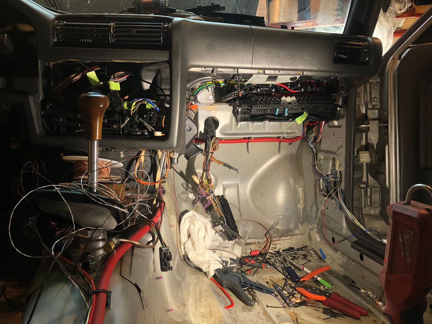

    Sorting wires, The last wire snipped from the E30 fuse box felt almost like when you close your browser of 50 tabs... Then 5 minutes later, everything is better.
    Chugging along, Was quite frustrating to get replacement terminals and housings for most he interior connectors, So, I just starting replacing everything in Deutch DT and DTM connectors..

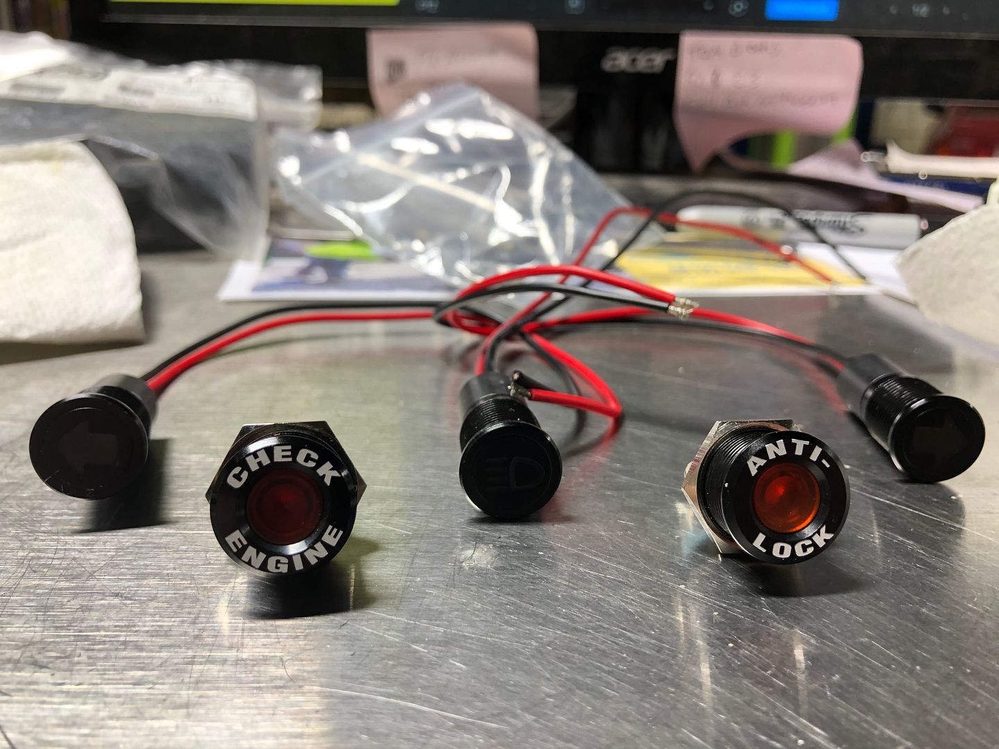

    Replacement Indicators

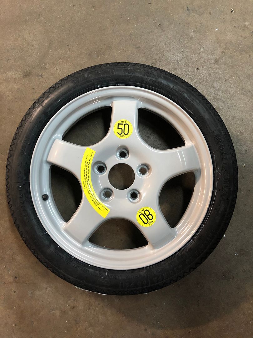

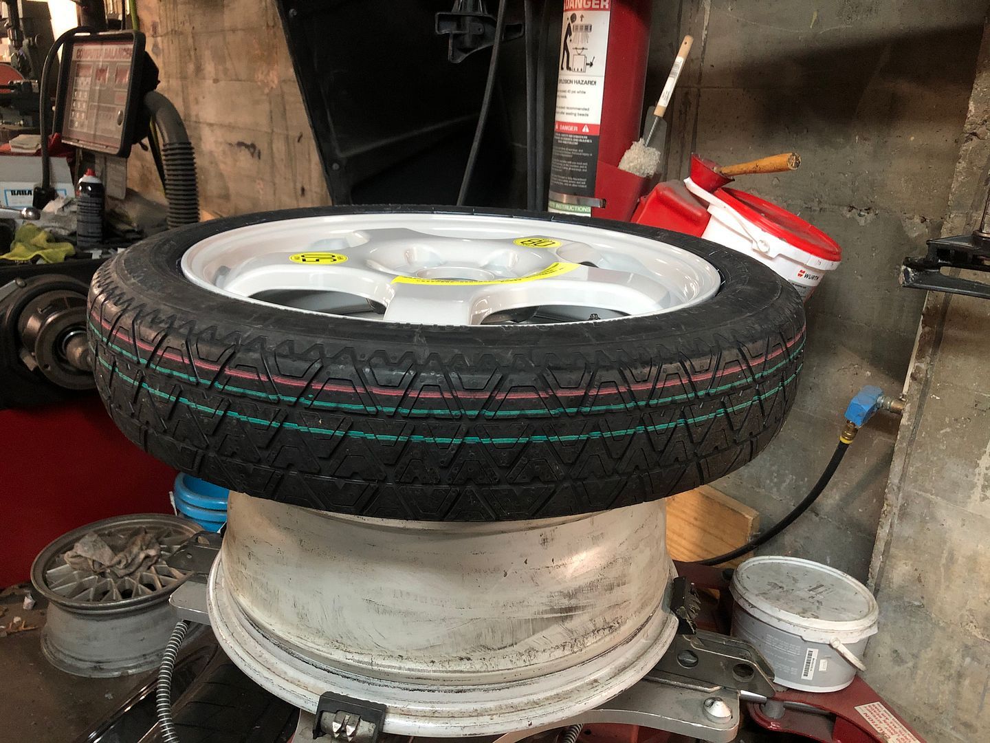

    I got so lucky to sort a Euro Spare Aluminum wheel in the US. Mini spare isn't a big deal, hopefully get me to the next destination, maybe slower. A nice weight saving compromise.
    And a new spare tire, Continental, Made in Germany.
    I can do this...
    Things are starting to make sense again
    Fusebox starting to fill up!

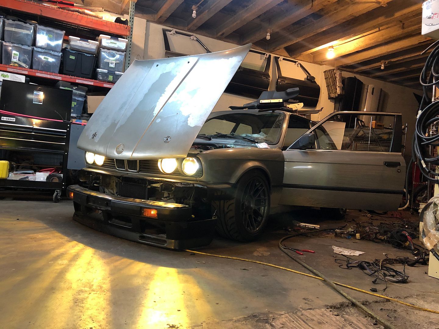

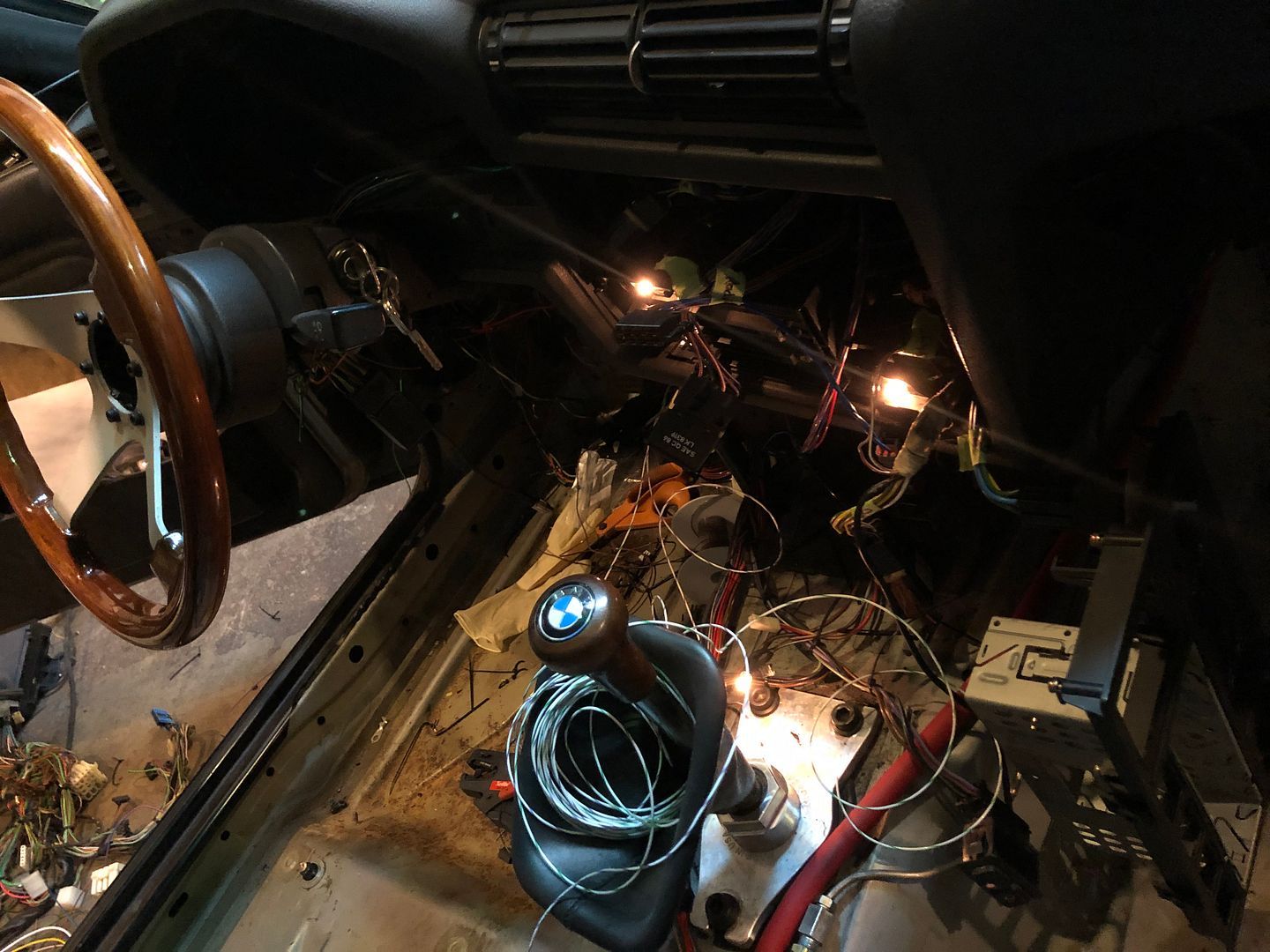

    Houston, We have lights
    Speaker, wiring and sorting

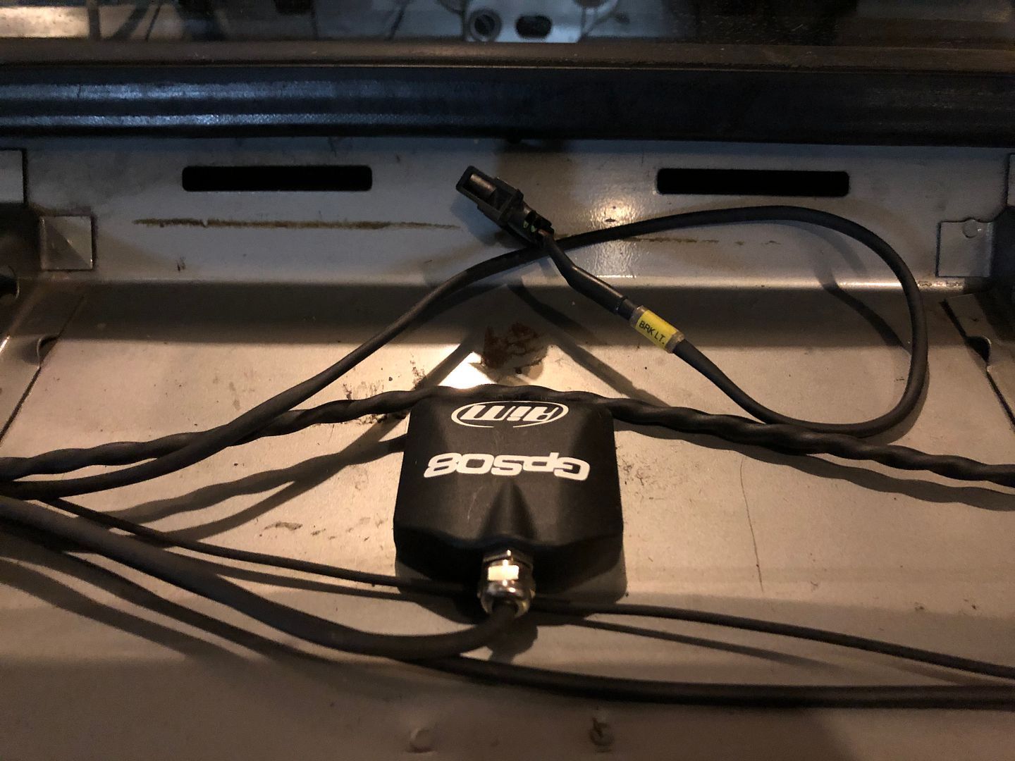

    GPS Speedo

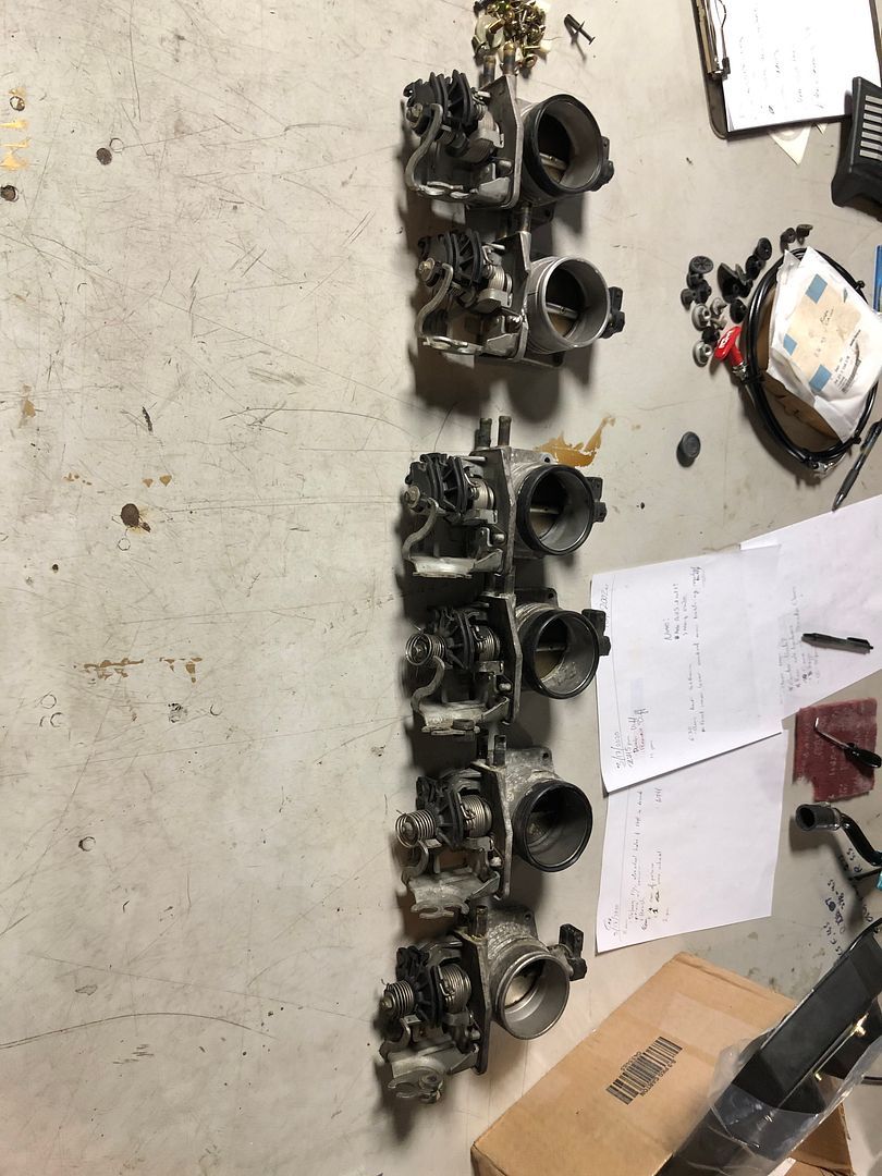

    Years of hoarding motors and crap, I was able to send some core throttles in for a small credit towards my Bigger bored Throttle. Future pics of that.

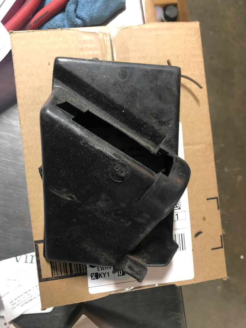

    OH, And the NON AC HVAC box cover will fit the AC HVAC box if you delete your ac, Future pics

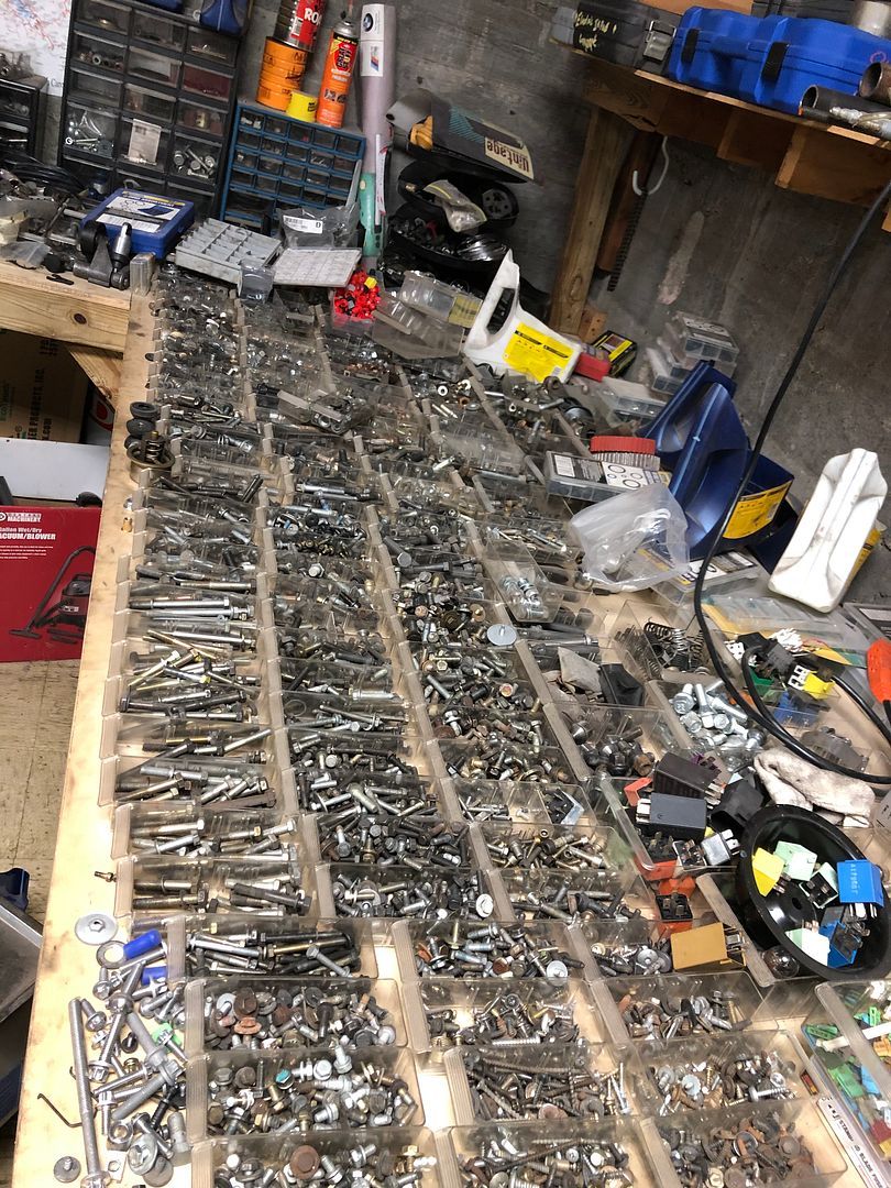

    Bolt bin saves my but so many times, Id like to go through and organize it more

      That wiring job looks intense!

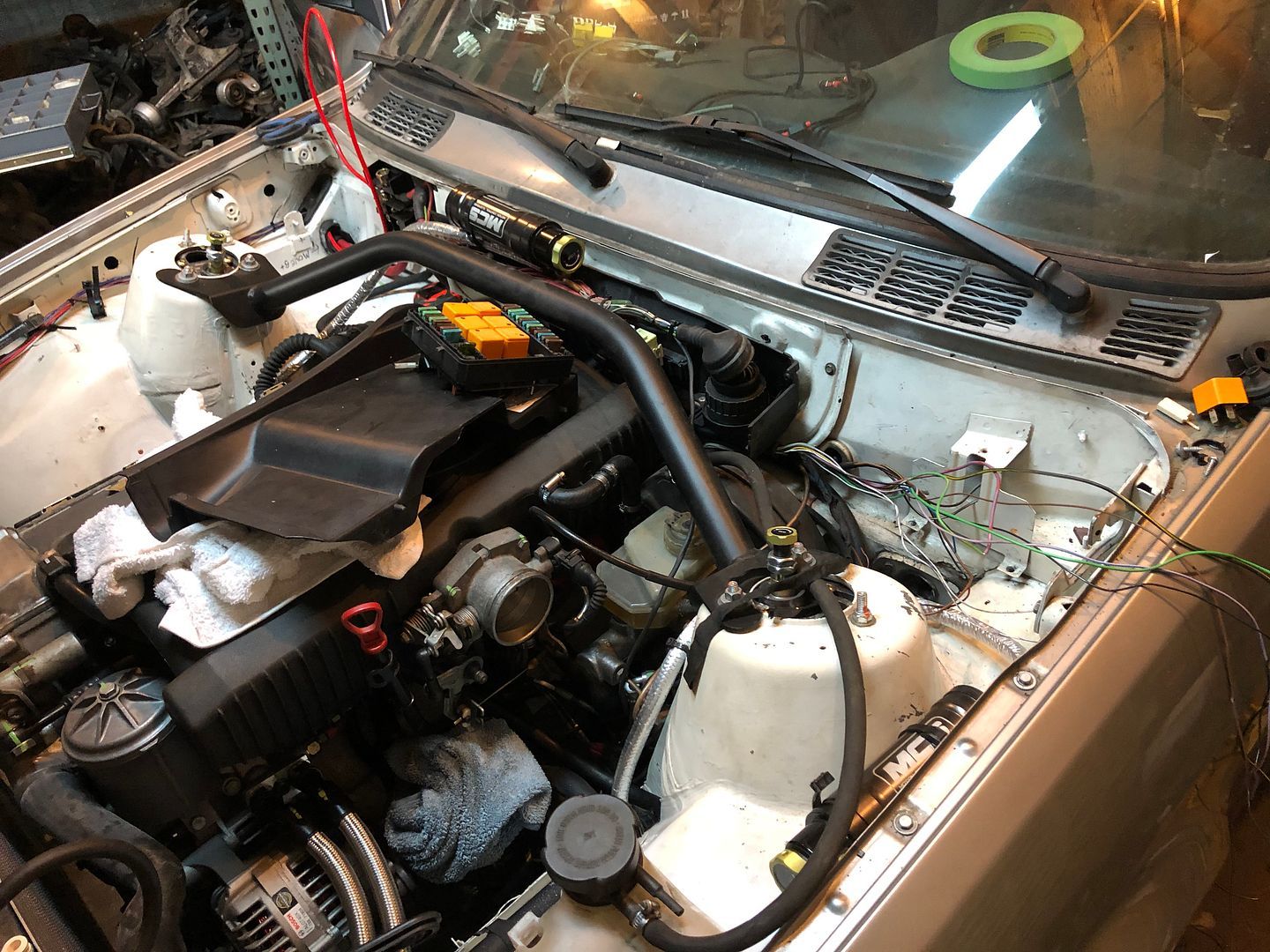

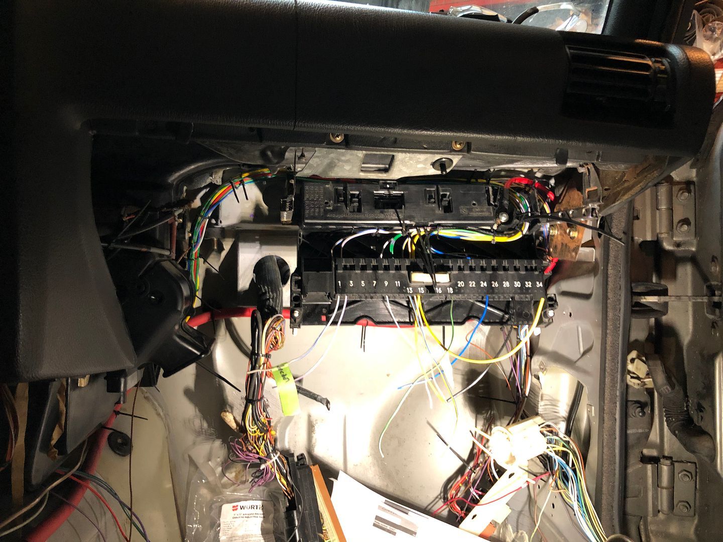

              Fuse box coming together
              Things are starting to tidy up!
              Precision sound

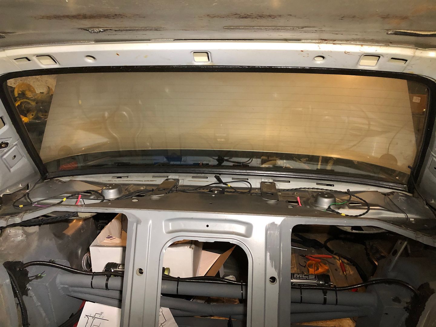

              Shortened up the wiring to the doors, Getting speaker wire ran, Had to rewire all the interior lighting.
              I fought for a while of where to put the ABS unit, I Really wanted to put it on the passenger side... But to get right the engine has to come out to sweep 6 lines over. Also future S54 carbon airbox planning architecture was in mind. So I was like this should work.
              Even fits my front strut tower tie in idea.

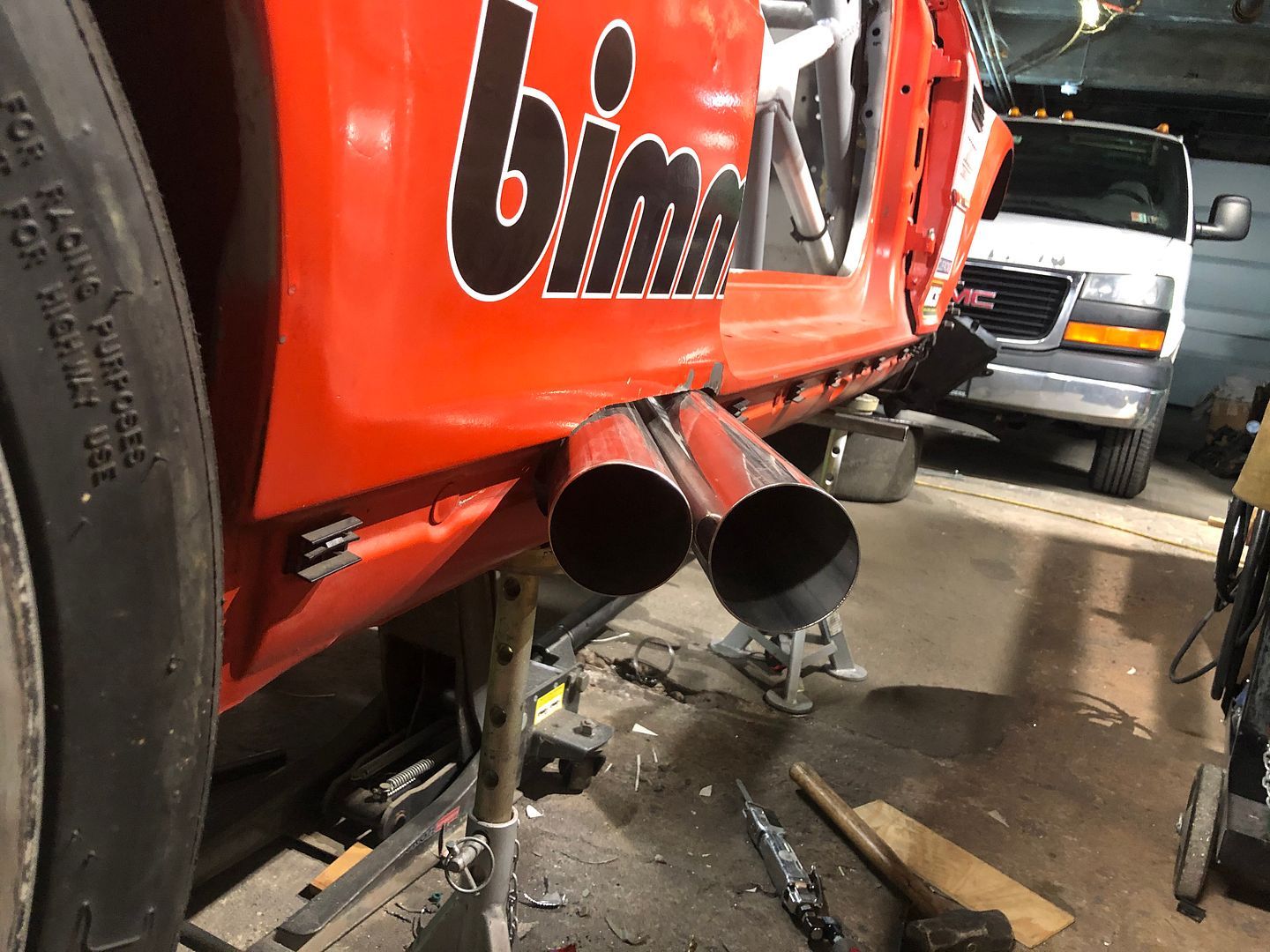

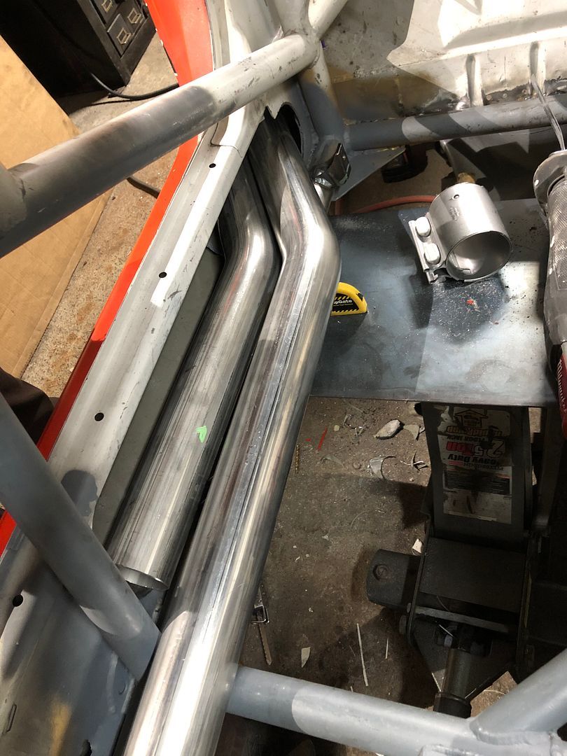

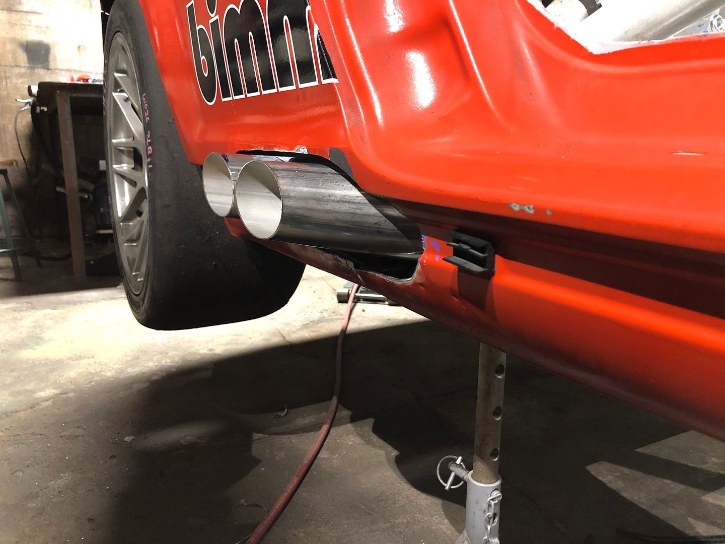

                Some pipes welded and fitted

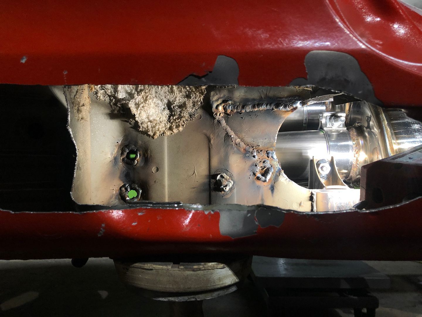

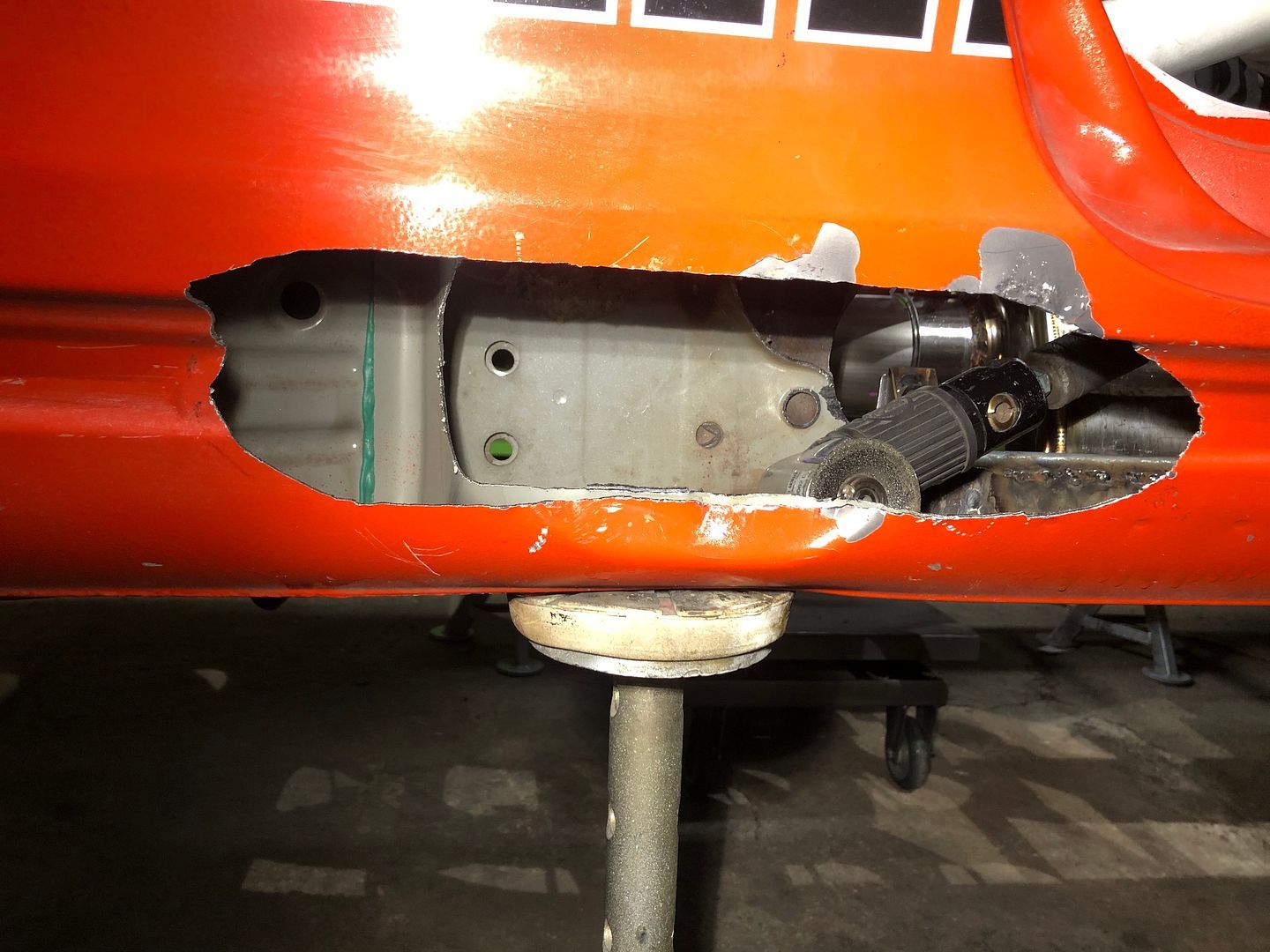

                  No one really post or completes their car with Z3M trailing arms follow up with rear alignment specs...With the IE posi locks and the trailing arms bottomed out in their pockets I ended up with Zero toe. Before with the eccentric rear end I was around 1/8 out. At the time the best I could think in frustration was slotting out the pocket and milling out the posi lock slot to accommodate.
                  So back apart I go.
                  You can see the trialing arm adjusters are not maxed out but the bushing into the pocket is what gets maxed out. I was a bit surprised. Eager and frustrated I decided to just gut the pocket out and reinforce..
                  I had a guy lined up in Tennessee that could bend Z3M trailing arms into spec. I had no idea if mine were actually in spec or not.. But do to heath issues this fell though...
                  So to cutting I went
                  But after thinking it though I realized that I'm just hurting my sweep angle. Any toe in compensation from stock hurts sweep angle.
                  In frustration and more research I hope to found a fellow to bend the trailing arms into spec on car, I get to keep factory sweep and get my toe fixed!
                  The A part of the trailing arm rubs on the gas filler tube.. I have a better reinforcement to come.

                      Wiring:
                      Getting the dash panel sorted
                      Fuse box still coming together
                      Figuring out where things are going

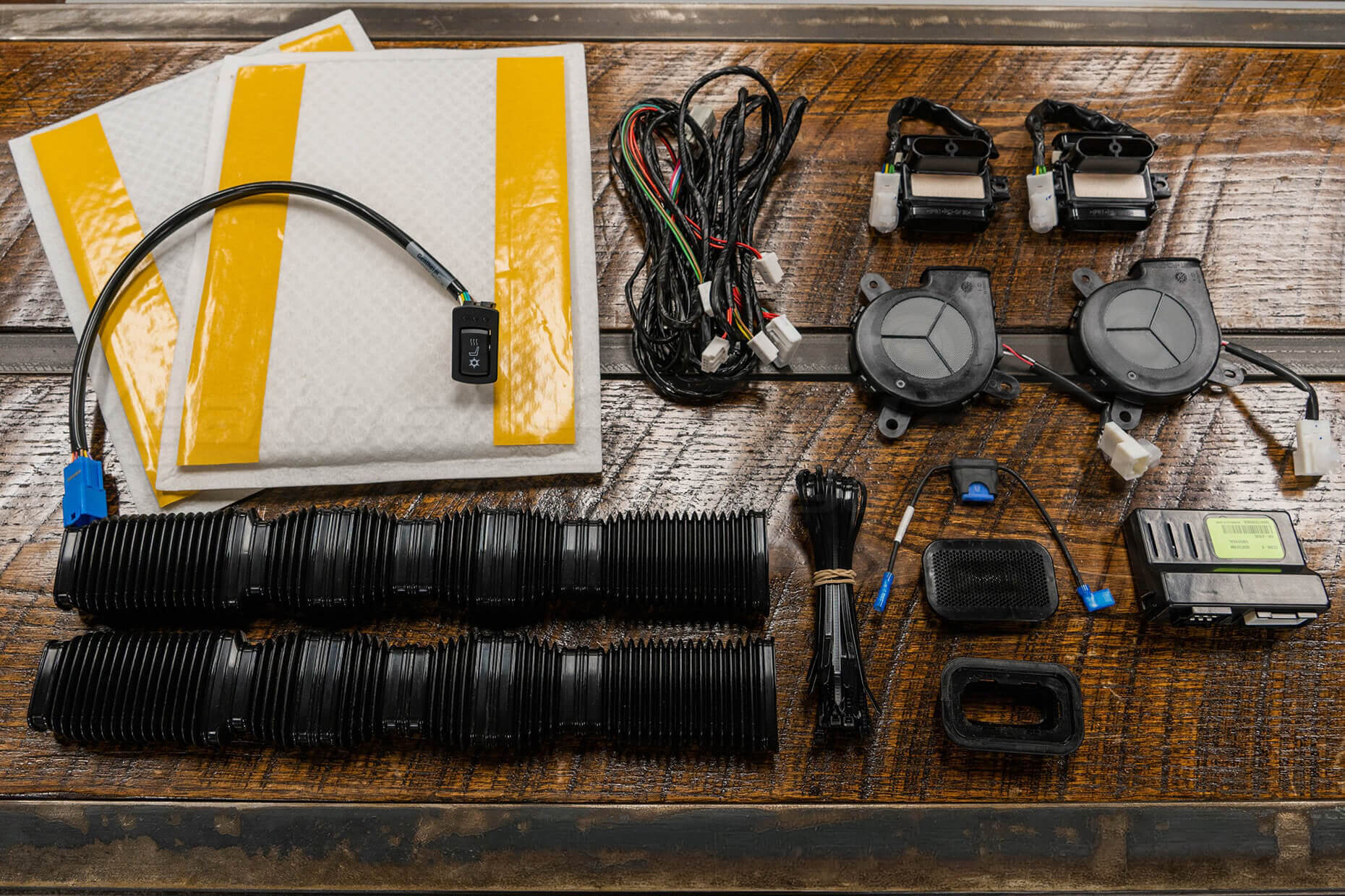

                        Started on my heating and cooling seat setup, This car wont have A.C. which I'm completely ok with. But will be interesting how this keeps down the swamp ass on long hot drives.
                        I got the kit from Leatherseats.com, looks to be a common kit that others re-box
                        If your vehicle did not come with heated and cooled seats and you wish it had then we have what you need! Our SANCTUM Seat Ventilation System will get the job done by keeping you warm in the winter and cool in the summer. This system provides both a heating and cooling function

                          #102
                          Interested to hear how effective that seat cooling is. Especially when wearing Nomex?
                          RISING EDGE
                          • moatilliatta
                            • 6151
                            #103
                            Seems to be quite surprising while testing in casual attire, Single layer suit probably would benefit more.. I'm sure not a nice on track as a racetech vented seat
                            Premium, back-mounted, FIA approved race seats for serious motorsport competition.
                            But for back Roads, HPDE, maybe time attack, It should do well, Especially stuck in the city.
                            I can do 30 min stints no problem, Usually after that is when I start sweating. I forgot cool shirt for a 1:45 stint in 90* weather. Luckily the being young thing is still working..

                              Factory Fresh
                              HVAC box delete cover

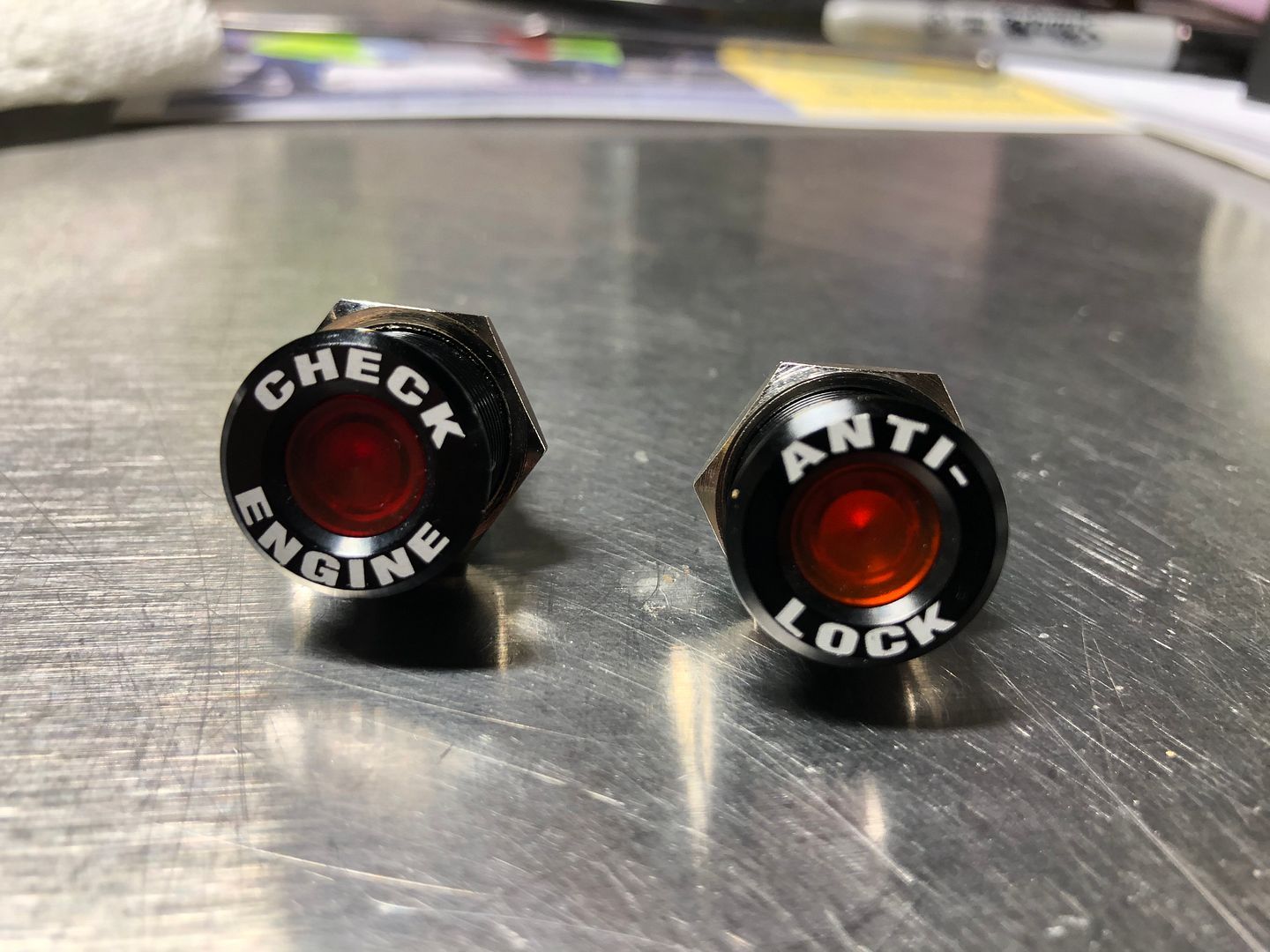

                                Pull up resistor.
                                Had to change the logic to the ABS light on the dash panel
