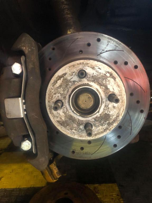

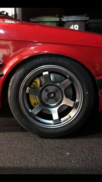

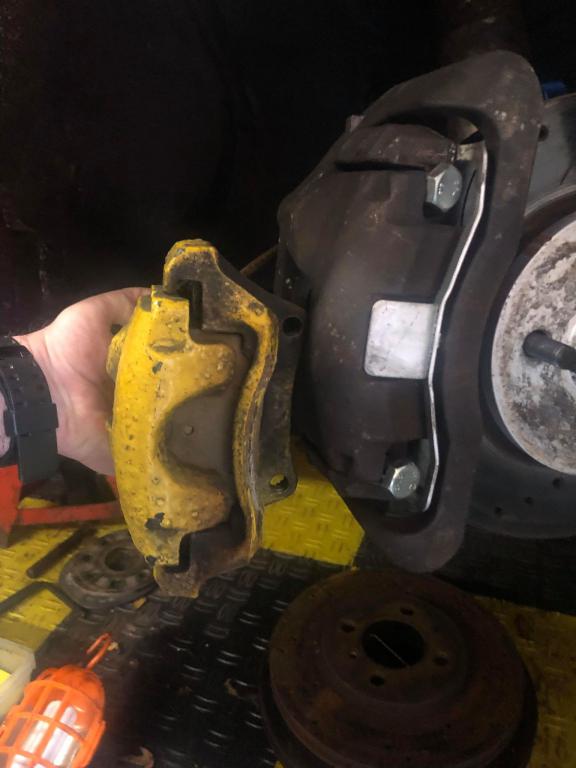

                            I don't know if you can use this information or not, but people in the UK are running Ford Focus ST225 2005-2012 front brake calipers and re-drilled 312 mm VW front discs.
                            I got these pictures from a guy in UK running this setup on his race car. The calipers should be a direct fit with no adapters etc.
                            Yellow caliper is stock 325i stuff. Compared to the ST225 caliper on the right.
                            ST225 caliper vs. stock E30 brake disc.
                            ST225 caliper and 312 mm brake disc.
                            16" wheel.
                            I have absolutely no experience with this setup my self, but it seems like a cheap/easy way to get bigger front brakes.

                              that is VERY interesting, thanks for the info. i know of two friends who will be very interested in this 🙌🙌🙌

                                Cool! The calipers should be the same on following cars:
                                - Ford Focus ST225
                                - Volvo C70, V50, S40
                                - Mazda 3 MPS
                                But, it all depends on engine size etc. so make sure they look like the above pictures. From my "research" (...Google) they are often stamped FoMoCo 975 and FoMoCo 976.
                                The rotors can be found pre-drilled on eBay btw.
