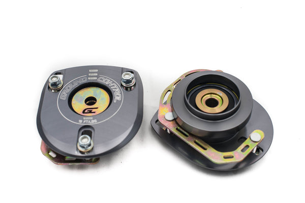

                  In terms of top mounts, have you seen that Garagistic do a 'street' mount - looks like it might potentially have more use of rubber than the traditional top mounts. I'm going to get some, but I wouldn't be able to tell you how much noise they make, since my car is rattling all over the place!

                      Sorry I meant Ground Control - they say "a smooth silent ride" which you could certainly test for them!
                      Does not fit E34 with 16mm pin and stock spring diameter, (Seperate item, CPe34Touring). These plates feature over 23mm of total camber adjustment (16mm negative/7.5mm positive), with the ability to make corrective caster changes to equalize side-to-side caster in the stock position.Other features include replaceable w
                        https://groundcontrolstore.com/colle...-camber-plates
                        I run these plates and they are silent.
                                thanks, I think they are on the list. Will also remove the rear pillowball mounts and go to a poly.
                                Would be GREAT if i could find an OEM mount to suit a 14mm shock shaft.
