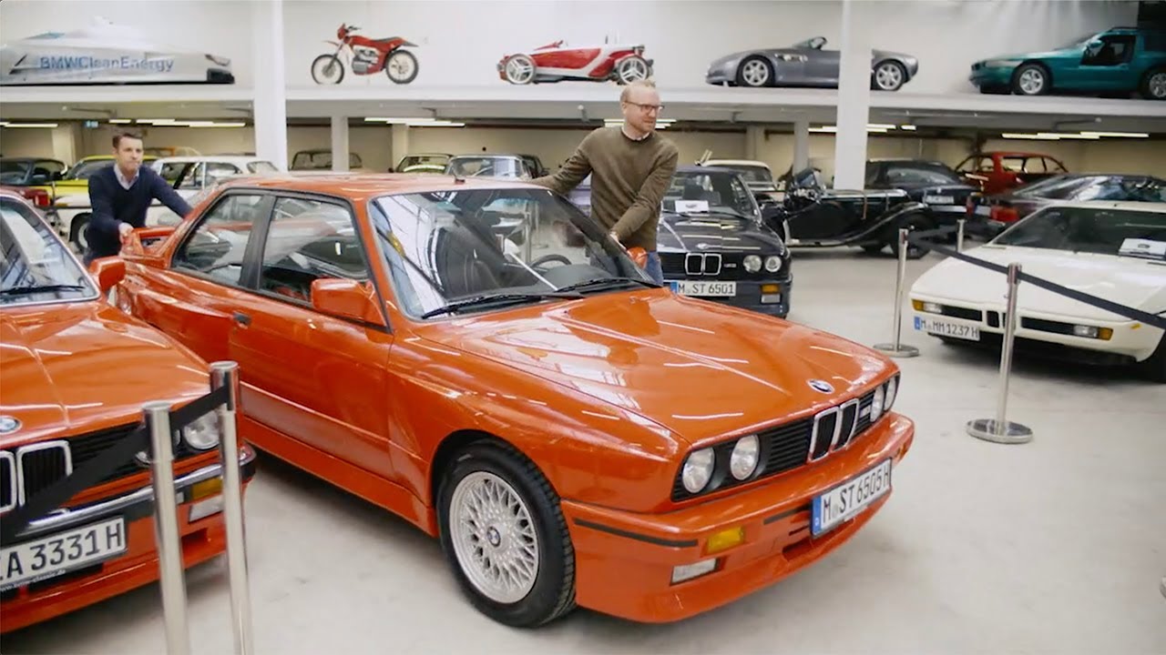

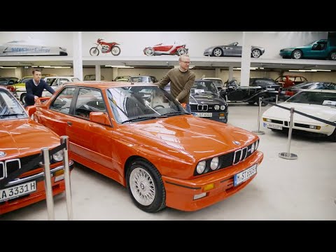

                      Is it the same color?
                      They say that BMW will offer new carpets and M3 panels.

                        That’s interesting, I really hope they do make carpet again. Such a huge oversight, surely they can see the market potential
