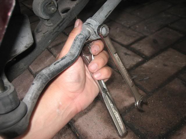

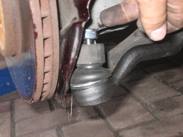

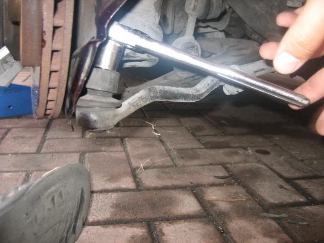

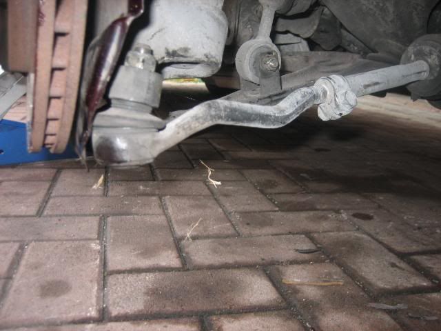

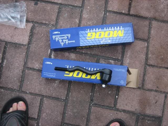

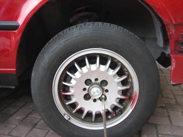

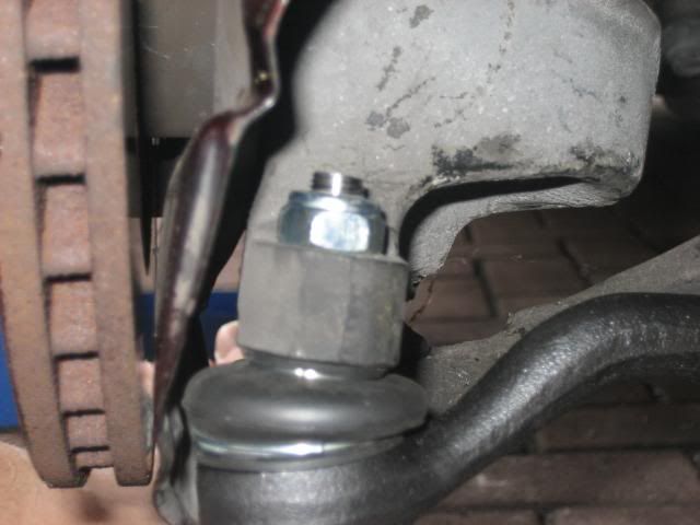

              I didnt have much time today, but i had an oppertunity to chage the tie rod ends
              Jack up the car, and take off the wheel

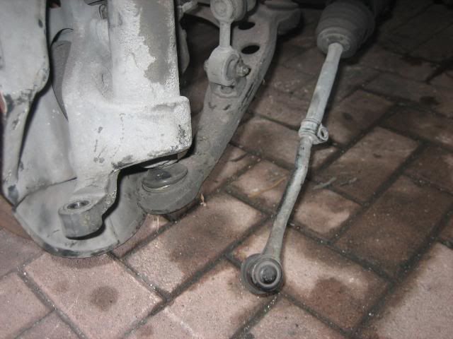

              New tierods
              Old tie rod

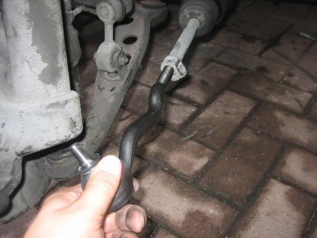

              Loosen the top bolt
              Loosen the bolt in the back
              You can use a hammer, or fork to loosen the tie rod from the strut housing. Mine was easy to take off because i just did the shocks.

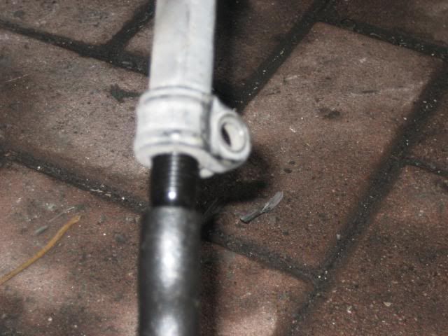

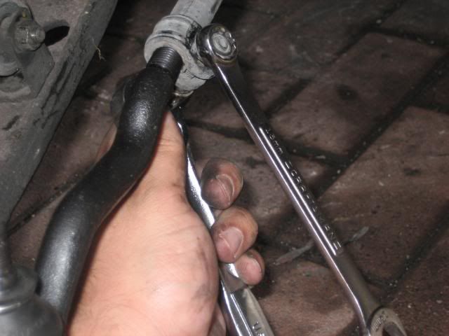

              Screw the new on in. Put it to about to where the old one was.
              Tighten the rear bolts
              Tighten the front one

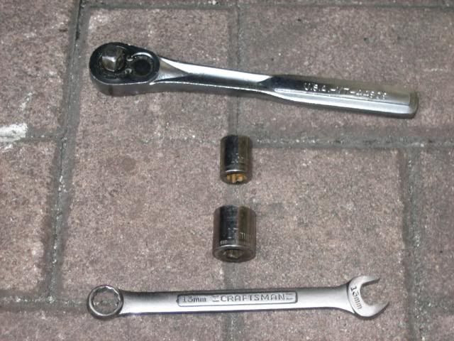

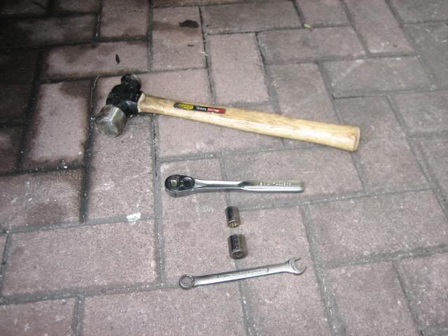

              These are all the tools you need

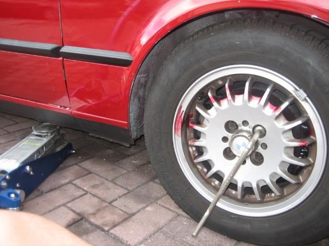

              Tighten the wheel and you are done

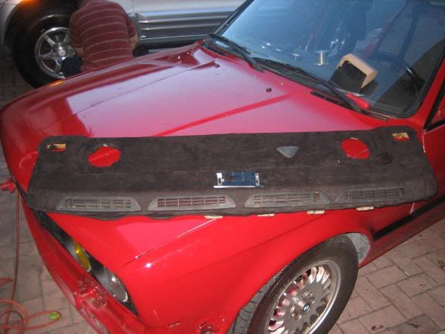

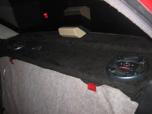

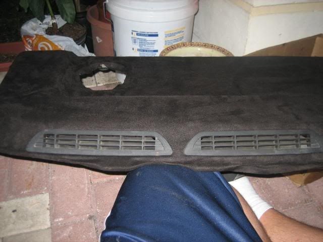

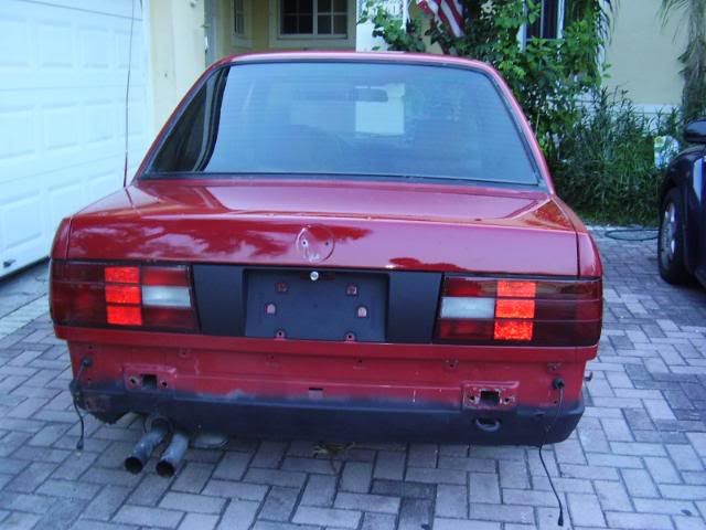

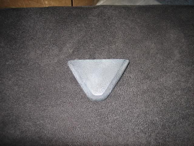

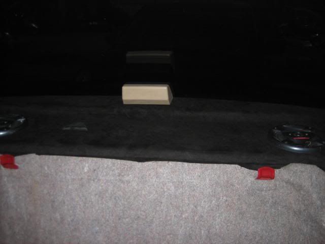

              I finished the rear deck.
              I put in the seat belt holder

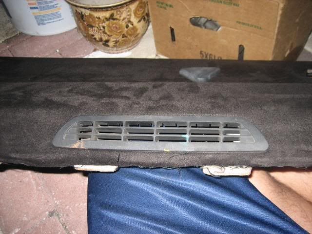

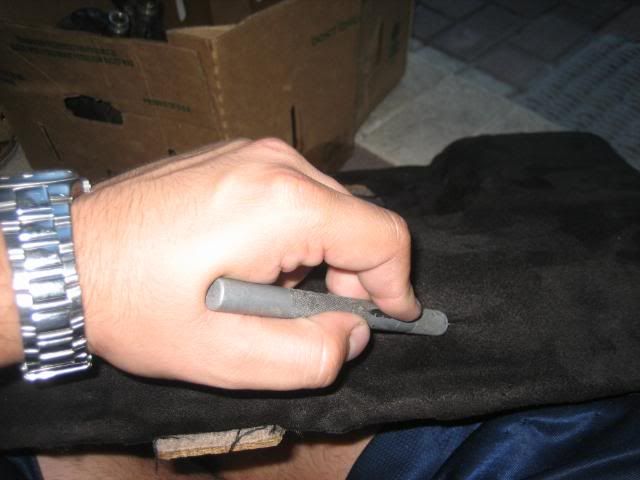

              Cut out the factory holes
              Put in the vents
              Finished

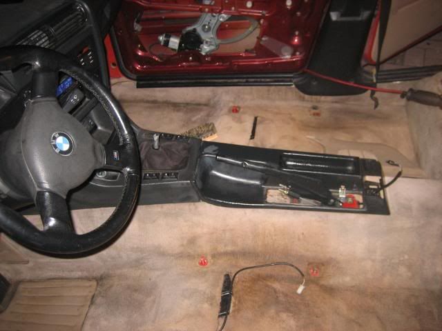

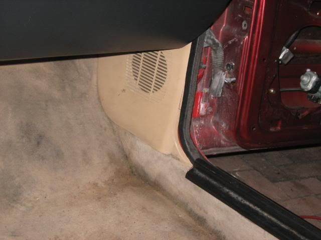

              I put in the center console and speaker cover

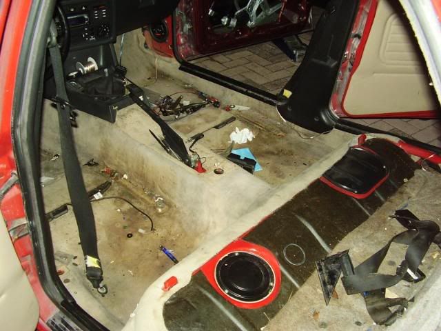

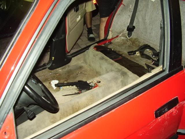

              I cleaned the inerior with Degreaser, carpet cleaner and tide. It did nothing. My friends are telling me to paint the carpet, that dealers do it all the time. What do you guys think?
              Before
              After

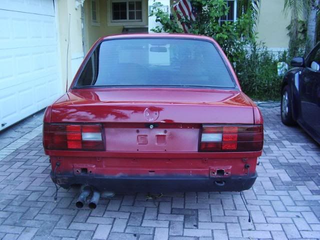

              I got the license plate trim

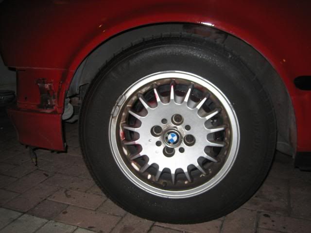

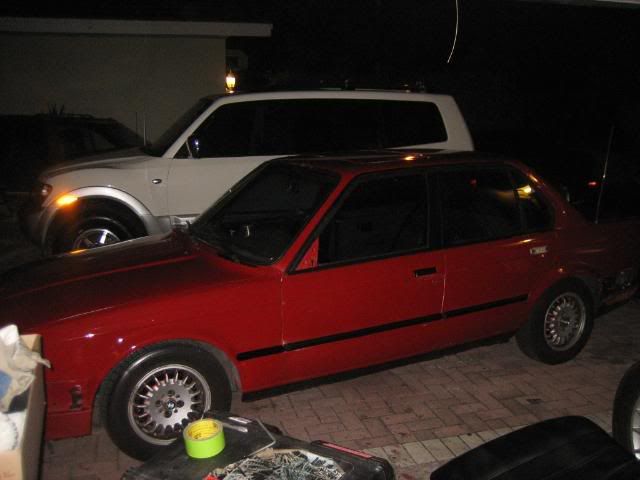

              Here are the lowered pics of the car, it still needs to be settled and i will lower a bit more

                        As far as carpet painting goes, DO IT! Get SEM 'Color Coat' in whatever color fits best and have at it. I did my grey carpets and they look brand-fucking-new. Just spray on a coat, let dry, brush with stiff bristle brush to loosen. Repeat until desired color and finish is reached.
