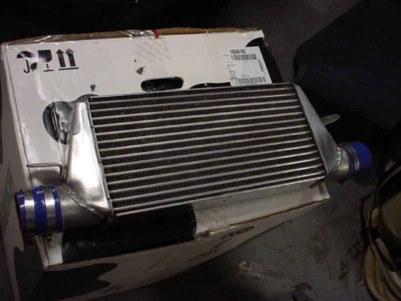

    I believe I need something like 22x8x3 overall or something to that affect for a front mount.
      I've got a starion intercooler with modified end tanks. See sig, it's decent sized and fits easily.
      '88 325is
      VP UT of Austin Autoholics
      BMWCCA 380364
        How exactly did you modify them?
        What is the outlet measurement?
          16.5x8x2.75
          I didn't do the modifying personally, but somebody changed the outlet to 2.5".

            Thats awesome.
            Thanks a bunch!
            Something to look into for sure.
              look into Audi intercoolers too. old stuff like Audi-80/90 and Audi 5000/4000 turbo.
              they are plastic tanked and the in and out are on the same side, but they are bigger and can be found cheap
              i also have a Mercedes Benz inter cooler that i will let go cheap. it has the in and out on opposite sides.

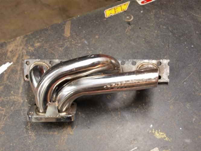

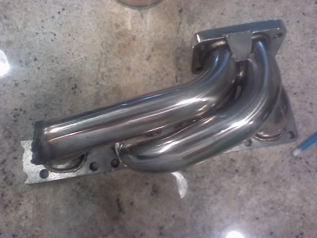

                Ok so here is the modified manifold.
                I know the welds are ugly but they are very strong.
                  Cleaned up a little bit:
                    I'm watching...
                      Haha, you should be Daniel ;)
                        um. if it works, it works.
                          Budget turbo build, oh yeah, nothing can go wrong here.
                          Oh well, we shall soon see.
                            It'll work, alot of M42 guys run this manifold, at least low boost guys.
