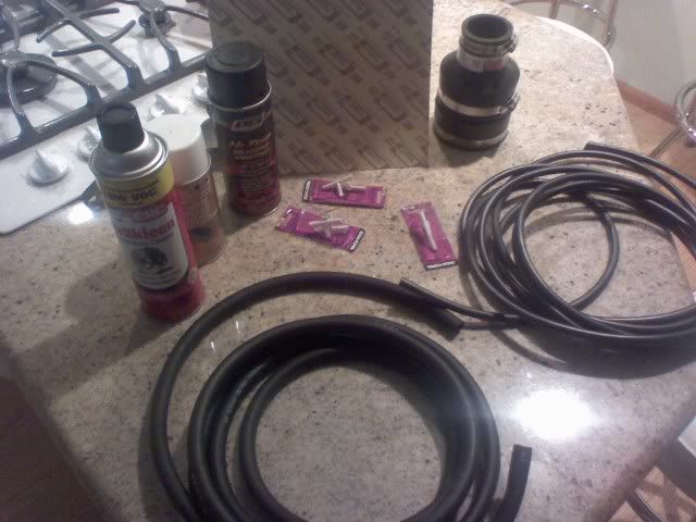

    Coolant lines, vacuum lines, T offs for vacuum lines, gasket maker, adapters for intercooler to piping, various spray things.
    This stuff adds up.

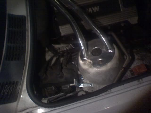

                              Gauge pod in check panel place:
                              Relocated the coilpacks:
