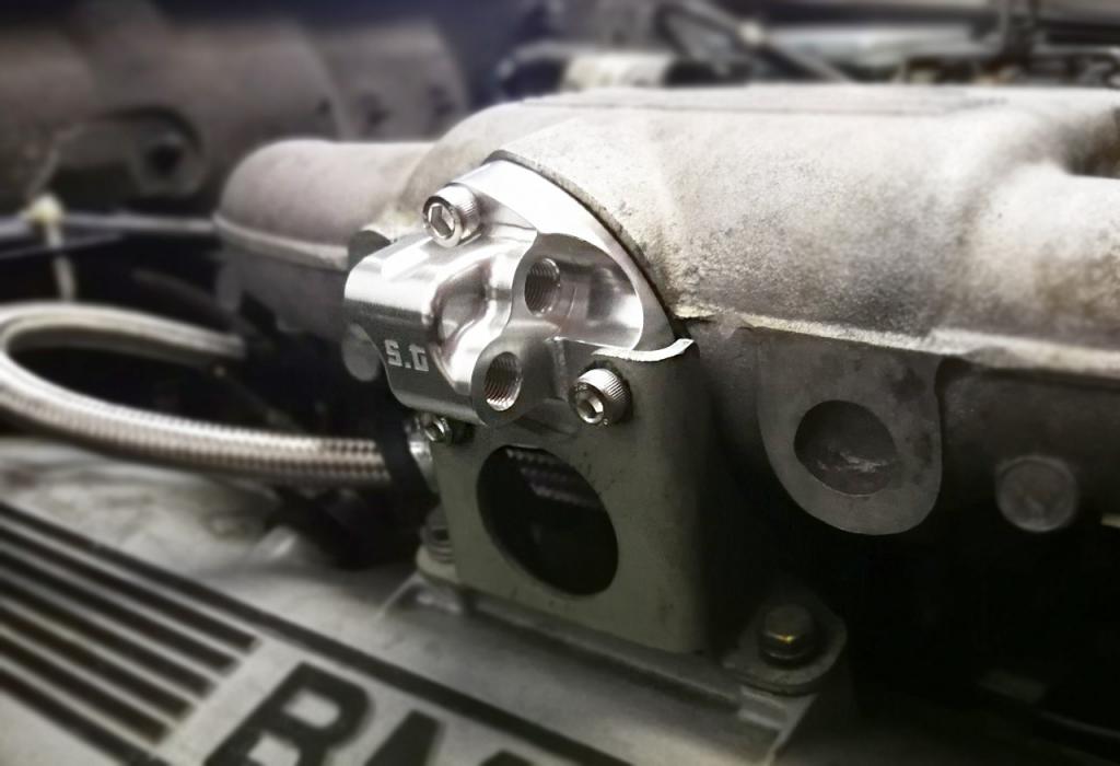

      all sorted, i'm in no way affiliated to these guys but this vacuum manifold seems pretty nice for a turbo set up. https://stim.tech/product/m20-intake-vacuum-manifold/
