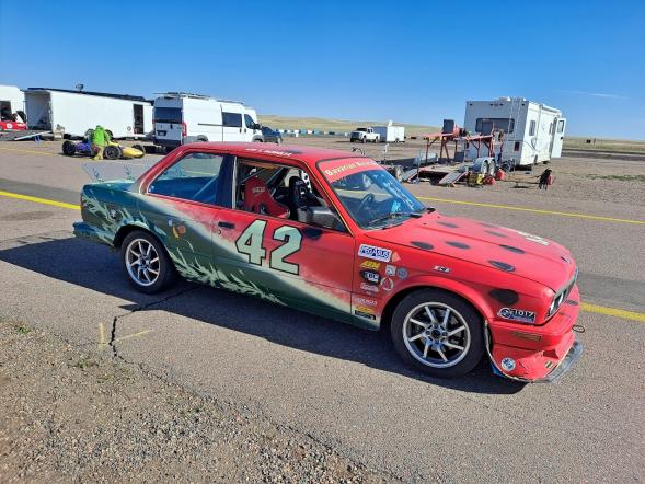

        The car ran great, until it didn't. I swapped the fuel filter when we got to the track and after a couple laps I was getting fuel starve, There was so much crap in the tank it was cycling through the strainer and into the filter clogging it up. The morning sessions were plagued with that problem. We swapped out filters and intermittently 'cleaned' them with gasoline, shaking them to clean out the junk. You can see the fuel on the ground from pulling off the line and the brown mess is what came out of the filters and was left after the fuel evaporated.
        20210425_160224 by t sz, on Flickr
        I have some more photos and some onboard footage to go through but initial driving impressions are pretty good. The brakes worked great with the stock 325ix master. During the bleeding process with a pressure bleeder the reservoir separated in half slightly. The res still help the bottom half of fluid and I ordered the 2002 style remote mount reservoir to replace it. As it turns out the 325ix reservoir costs $250!!! Just the plastic reservoir! So the brakes help up well and the hawk pads and wilwood calipers worked great aside from some excess dust from the HT10 pads. I have been looking into alternative pad options to prepare for the race today and am considering PFC 01/11 for fronts or the Hawk DTC 50/60 compounds. I have PFC 08 with stock e30 discs in the rear and that brake proportioning valve to adjust balance.

        The tires on those SSR wheel were manufactured in 2001 and early 2002 so with them being 20 years old I wasn't sure how they would do, but they held up great all day. The advan yokohams 032R I believe are an 80 treadwear. With a wider 225 width Hankook RS4 with 200 treadwear, maybe they will be similar. Either way the problem with the car is the handling. It oversteers coming out of turns and the front squats a bit too much. With the rear lifted up the back end doesn't have enough weight and seem to be hopping or skipping through the turns as if the tires have too much grip and not enough force pushing them into the ground.
        We believe the rear springs are either too stiff, the fronts are too soft, or the rear is lifted too high. The car also has decent power but seems a bit slow compared to my other 318is with longer gearing and a lightweight flywheel. I brainstormed some options about what could be limiting power and came up with this:
        - Fuel Filter partially clogged/ Fuel Strainer partially clogged
        - Stock ECU without a chip
        - Catback and muffler exhaust could be restrictive
        - Stock heavy dual mass flywheel
        - Fuel System/Injectors could be dirty from the rusty gas tank and need cleaned

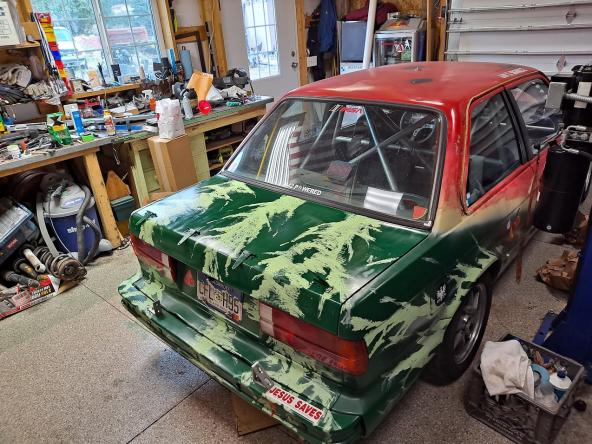

                  Next it was theme time. After discussing it we decided on the #42 which represents our friend's team, the #21 e28 535i (us being double their number) and the lovely M42 engine. It also works with out theme which is the 42 hours of melons. A play on words for our team that sometimes gets things "mixed up." We did a quick sand on the paint to rough it up for primer and hit it leaving some of the more major imperfections under the surface paint.
                  20210609_171350 by t sz, on Flickr
                  20210618_195402 by t sz, on Flickr
                  20210618_213100 by t sz, on Flickr
                  20210618_221850 by t sz, on Flickr
                  20210618_223515 by t sz, on Flickr
                  As cool as the terminator grey car was, we have better themes to provide.
                  20210619_110731 by t sz, on Flickr
                  20210619_110748 by t sz, on Flickr
                  20210619_201403 by t sz, on Flickr
                  20210619_202019 by t sz, on Flickr
                  20210620_094644 by t sz, on Flickr
                  20210620_115003 by t sz, on Flickr
                  20210620_161742 by t sz, on Flickr

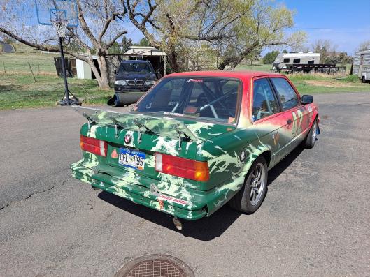

                  No race car is complete without a huge wing. The aluminum bumper flexes some so we have more work to do but it gives a cool effect.
                  20210620_162024 by t sz, on Flickr
                  20210620_190932 by t sz, on Flickr
                  20210620_192111 by t sz, on Flickr

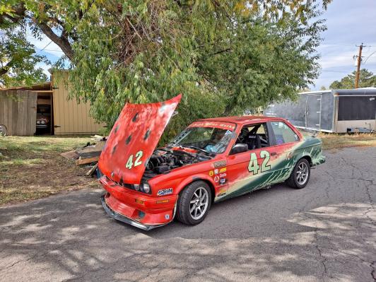

                      With less than one week until our debut race with 4 new Lemons drivers and the unproven car, I'll give an update:
                      After the paint job we believe we have given the car a name, Melony
                      Ted has been busy with commitments since we painted the car in late June and I brought the car to my place to do some additional work. We have been fixing items on and off and putting a few miles on it leading up to our full 24 hour race this weekend. The neighborhood kids rode over on their bikes and commented on the car parked out on the street. They thought it was a cool car! So far a lot of kids have enjoyed the theme and the paint job just because you don't see that sort of thing out driving on the streets.
                      Here's where it has lived the the past two and a half months. Got an in car clock set up and it has GPS, ambient temp and some other variables that may or may not prove useful for the race
                      20210814_130914 by t sz, on Flickr
                      In testing the GPS system out, I took the car up to 80MPH but felt the rear wing was still a bit too wobbly. Mainly, the Aluminum bumper was flexing forward and back, meaning the wing would move an inch or two. Additionally, it wasn't laterally supported enough. So with some scraps, I thought this up for wing support. We can tighten it by twisting the brackets back to pull the cables tight. With the GPS, we have verified it up to 98MPH which is at or close to our top speed on the track we run
                      20210821_122727 by t sz, on Flickr
                      Here was the wing originally with the 'secondary element' (door frame wood scrap) mocked up
                      20210616_165440 by t sz, on Flickr

                                Its been quite a while since an update, so its about time for one.
                                After the race, the rusty gas tank needed to be changed. I got my hands on late model gas tank that didn't have rust. Getting this tank to fit was quite the chore laying on the garage floor.
                                Rear wheel bearings were done late last fall as preventative maintenance on those old trailing arms.
                                Next up was a test day where the car kept shutting off despite driving to the race track under its own power. I determined it to be fuel starve from the left hand corners. it wasn't transferring to the fuel pickup side of the tank.
Name:	qAVjbhnF_ebAHPl03lBqD9cjN47pIQrGgwOVAFtA-n0TpnaPT-QCKlXEghWi1sjlehokukwULgNEWO5BzQgNpM7g_bAPLpjh0cYtNZZmNAddQOrZy9YIIYvfrPGE63hX9fvpqZR0Utlyfp58k0frIcOrhlr0YyYBd9S94ZsTe0WWE37fmeVZkmJUQkRDrlZ8jnmRbdMRYLJ5f5o56CPBNKoCD2efEw4uZ2c5VVUdK7FaC8cOpjXIp1Sked_Kvwe
                                The fuel pump setup needed to change. Since the later tank doesn't have the crossover tube under the driveshaft. The internal siphon system didn't seem to be working right and i read multiple threads about the e30 setups getting fuel starve on long left hand turns. HPR is a right hand turn heavy track. The solution was to use an m42 318i fuel pickup assembly on the passenger side with the main fuel pickup going to the fuel rail. A low pressure pump was added to the driver side where the regular fuel sender goes and that pickup goes to the high pressure pump on the passenger side.
                                Found a homemade adjustable lexan rear spoiler on craigslist. Got that repainted and installed to add some weight and downforce to the rear end.
