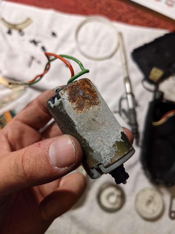

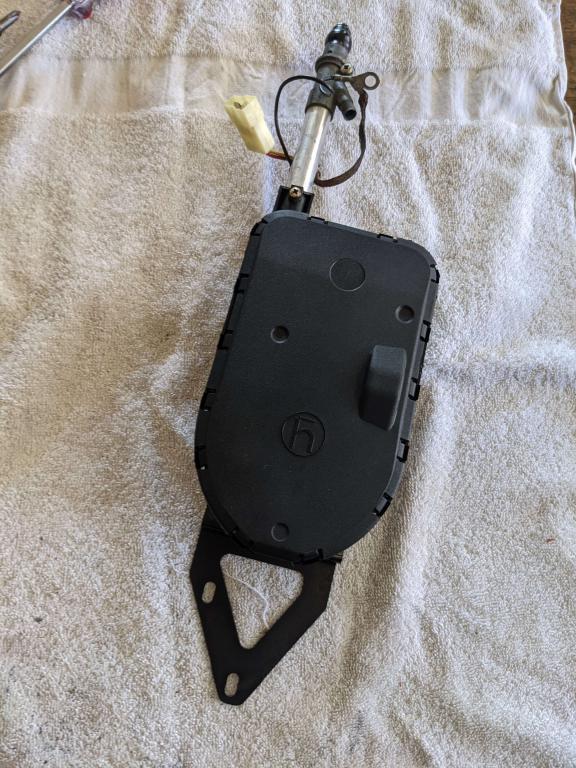

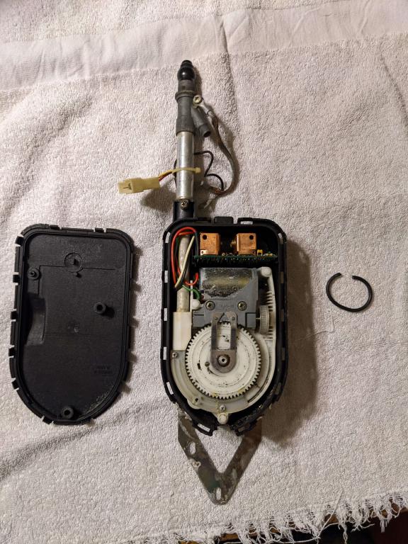

    First fools errand: Refurbing the power antenna:
    Click image for larger version  Name:	PXL_20210403_024638217.MP.jpg Views:	0 Size:	49.4 KB ID:	9981376
    Cleaned all of the parts. Sanded away the rust. And applied a light coat of paint to the bare metal.

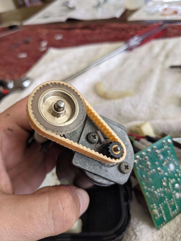

    Problem here is was that the PO had tried to fix the antenna by using an o-ring for the belt. Needless to say this did not last. Another problem is identifying the belt replacement!
    Unfortunately the listings for replacement belts do not identify the belt pitch, length, or tooth profile (information we would need to find a cheap and possibly local replacement!).
    For this model antenna (Hirschmann Auta 6000 I believe?) I found several eBay listings for a replacement belt. From the images I saw the lettering on the side as 158-2GT this indicates to me that the belt uses a very common 2GT tooth profile. Furthermore, it is a 6mm face width belt. The only problem here is that it is not a 158mm length belt the actual belt is smaller. This must have been a stock image... So we need to calculate the appropriate belt length with this belt length calculator. From this I estimate the required belt length to be 116-118mm!
    For anybody searching in the future: the e30 power antenna uses a belt with the following characteristics:
    • 2GT Tooth Profile
    • 2mm Tooth Pitch
    • 6mm Width
    • 116-118mm belt length
    • 59 Teeth
    • Likely part number: GBN1182GT-60
      • Could also be 118-2GT-6
      • 2GT-118-6
      • (these are just guesses based on how belts are usually named)
      • If you can find a 6mm wide 2GT belt with 118mm length you'll be good.
    EDIT: Amazon search you can find these belts easy: 118-2GT-6

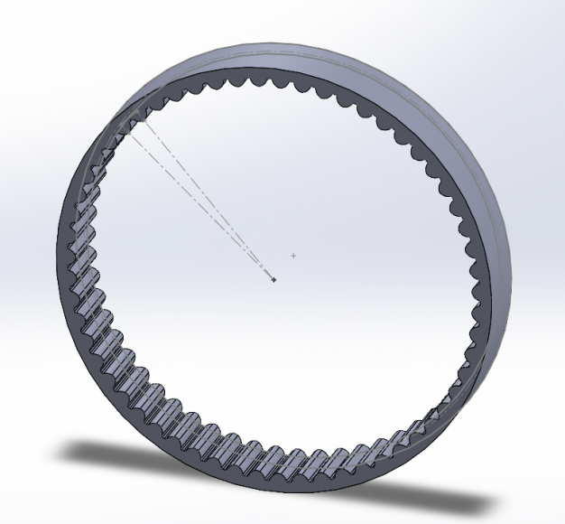

    But ordering a new belt is too easy. I don't thing the torque on this motor will be high enough to load the belt with approximate yield load of 10lbs for my TPU material on this profile; I'll just 3D print one. Using this website I got the geometric specifications for this belt tooth profile and drafted one up.
    EDIT: I've attached CAD and STL files for anybody that want to print one of these out - just change the file extensions from PDF to the appropriate extension I placed in the filename (SLDPRT, STEP, STL)
    Click image for larger version  Name:	belt.PNG Views:	0 Size:	313.4 KB ID:	9981379
    Click image for larger version  Name:	PXL_20210403_201904594.jpg Views:	0 Size:	52.2 KB ID:	9981377
    (note pictured here is a 158mm belt. This was before I realized that the listing I found was a stock image and before I decided to calculate belt length manually. I later printed a 118mm belt that fits perfectly)
    Click image for larger version  Name:	PXL_20210403_155058152.jpg Views:	0 Size:	96.1 KB ID:	9981378
    But it was all for naught because I got it all wired up in the whip and I got a new problem:
    Antenna only goes up when car is turned on. Will not go back down when turned off.
    I thought this was a head unit wiring problem (aftermarket rubbish) but it wasn't.
    Currently theory is that PO may have busted the motor control board when it was repaired last (with o-ring for belt). Also, the motor is running rather slow so it may need a replacement as well. For now, this project is tabled until I can diagnose the issue properly!
    Going to 3D print an antenna plug for the time being!

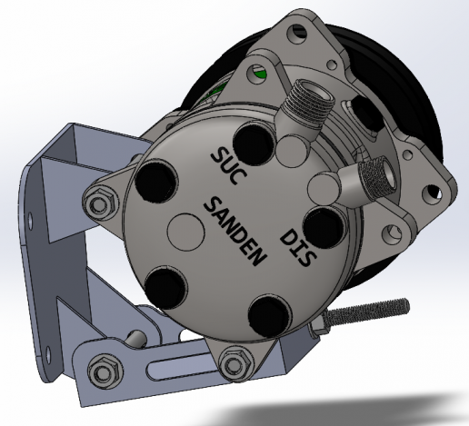

              My ideal mounting bracket is unique to this compressor (SD5H14 or 508). I plan on doing some CAD/design work, 3D print a test bracket to check alignment, then send to my fab shop for manufacturing. If the economics are right, I may fully 3D print the bracket in 17-4 PH stainless steel on the Desktop Metal printer at work. If all goes well I may sell the drawings or the brackets if there is demand!
              To do this I'll first start by modelling the compressor and the mounting area in the engine bay. This will include the position of all the mounting holes in the block and any objects in the area that may interfere with the bracket and/or compressor. I did some digging on the SD5H14 and I couldn't find any 3D models. So I did some further digging and discovered that the Sanden PN for the SD5H14 is 6664 (this comp. has other part numbers as well, but they have all been replaced by the aftermarket variant which is denoted by 6664). Via the Sanden website, you can find this page:
              Sanden SD5H14
              On that page there is a link to an engineering drawing of the compressor. I've attached the drawing to this post in the chance that the link breaks with time, or the sanden website goes caput. I will use this schematic to generate a low fidelity CAD model.
              • ddm-j
                • Mar 2021
                • 20

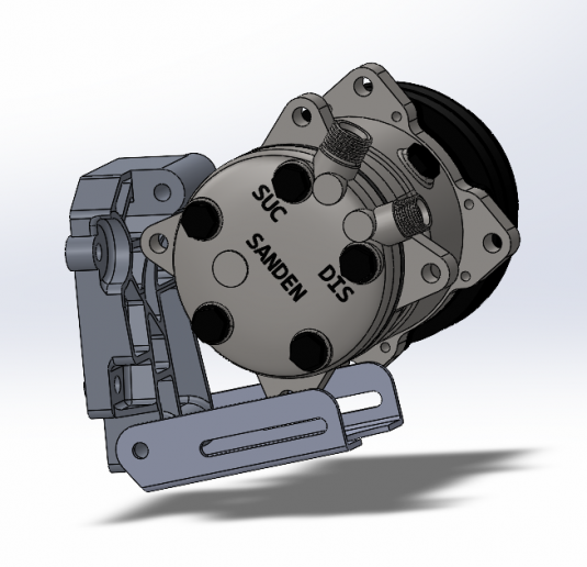

                Drew up the SD5H14 compressor. Here is a link to a repo of the CAD models for this. Note that the model is only exact for mounting holes, belt grooves, belt location, hose threads & interior specs. Everything else is an approximate trace from the manufacturer schematic. Mileage may vary.
                Sanden SD5H14 compressor CAD
                Next is to get up under the car and measure the current pully location relative to the block. Then extract the existing compressor mounting bracket and measure the mounting hole locations. From there it should be a straight shot to design a custom bracket for the new compressor.
                • ddm-j
                  • Mar 2021
                  • 20

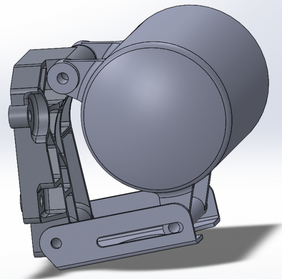

                  Working on new compressor mount and tensioning system... Getting center path trace during tensioning of compressor axis as close to OEM as possible.

                      First prototype design done. Just for fitment here - low detail. Will move to a detailed design once the fit/form is checked with the 3D print running now! New mounting bracket and tensioning bracket in the works.
                      Old Design
                      Low Detail Prototype
                      The new design will feature a simple threaded rod end for tensioning the belt. Because the old compressor mounting ears are further from the compressor center axis than the SD5H14's, the path that they trace out while being tensioned will be slightly different. Without adding material to the top ear of the new compressor this is unavoidable. The path is close enough and I think I'll get the same tension capabilities with the new system as with the old.
                      Next is to throw a cheap plastic prototype in there and see what needs to change, then move to manufacture ready design, then out to fab shop!

                            I actually saw those 508 brackets and I think that would work for the SD5H14 (newer version of the 508 I've come to understand). I think the mounting pitch is the same. I just don't like how the tensioning works on that one and other ones I've seen. There's this one posted on the My e28 forum that is just horrible with a ton of washers and spacers! Hahaha
                            Hopefully my idea of using a threaded rod end to tension it will work out well!
                            • ddm-j
                              • Mar 2021
                              • 20
                              This is actually the second prototype. There were some unforeseen obstructions on the first iteration. I ended up needing to throw some bushings on the back of the bracket so that I can avoid the obstructions on the block. In reality these bushings will probably be welded on to the plate, but These ones are printed. I'm really surprised that the bracket would hold the compressor (its just simple PLA plastic).
                              As you can see it's pretty similar to the OEM tensioning system, just shifted toward the radiator a bit. I did have a little bit of rub on one of the mounting ears but I think it'll be alright.

                              I've got some friends of mine reviewing the design for manufacturability so hopefully I can have one fabbed next week and ready to finish this project up. Today I replaced the expansion valve and that was a major PITA. Also have a rusted, stripped, then broken off (using bolt extractor) about 2" deep into the hole on the front bumper. So I'm waiting on some extended carbide burrs so that I can have another whack using a screw extractor instead (internal). If that doesn't work It'll be a long night of drilling. Until I get that sorted I won't be able to replace the condenser!
