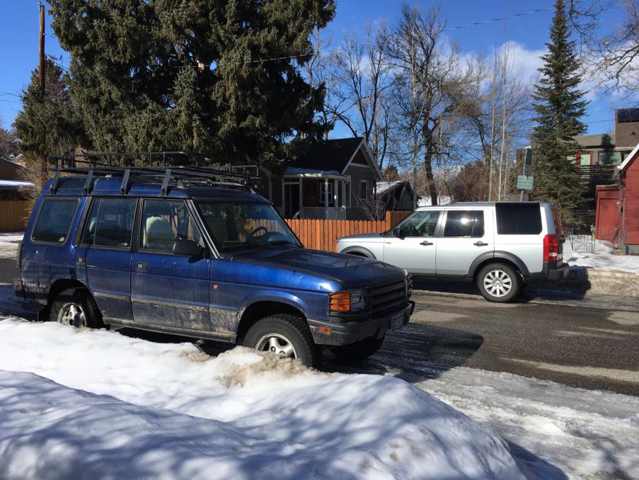

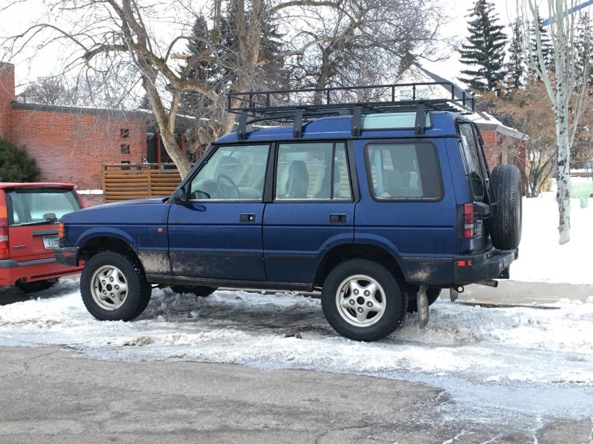

              Winter mode, with skinny little snow tires on newer wheels. He says it sticks really well.

                        So my son's '95 Disco (blue one, post 1641) is developing what sounds to me like a crankshaft knock. He sent a phone video - deep clunk / knock at idle, not every stroke. Doesn't sound like higher pitch rod bearing clatter. Doesn't sound like any accessory noise. Idles at 600-700. Sounds similar to an engine with the timing off, dieseling when it won't shut off, but with a smooth idle.
                        130,000+ mi on the engine now, good transplanted block from a 99 D2 by a LR mechanic. Installed a new cam, lifters, timing chain, all new gaskets. That was with 110k.
                        My son's been religious about oil, uses high zinc oil for the tappets.
                        I'd post the video, but it's a .3gp file from an iphone....?
                        He's up to his eyeballs in grad school, no time, apt with no garage, 2 feet of snow, and I'm hours away. He should have a real mechanic listen to it.

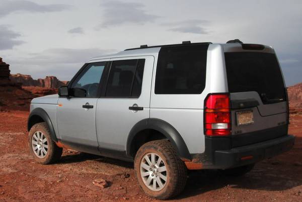

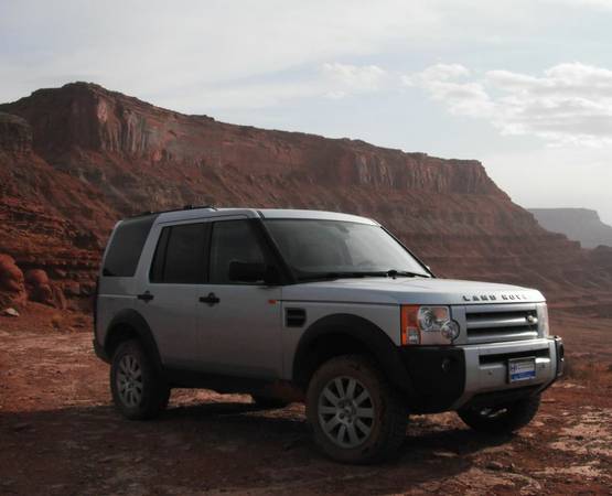

                          2006 HSE, 145k, heavy duty package with locking dif, winter package. Seller is ex-Porsche tech and has done major maintenance himself - alternator, ball joints, new control arms, transmission flush, dif fluids yada yada. Been on long trips recently with no problems. Camped all over the SW. Dry, no rust, everything works, new tires.

                              Old & New...
                              It has WAY too much posh shit in it. But the HD and winter packages are nice to have. Might have an air leak or exhaust leak on bank 1 - there's a lean code but it runs well. Came with a Rover-specific scanner tool.
                              D1 has either a rod knock, a main bearing knock, or maybe loose torque converter bolts...? We heard a very similar noise that was torque converter, not bearings.
