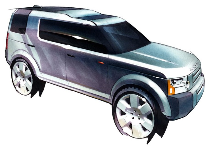

              Andy Wheel designed the LR3 for LR -
Name:	LR3 Andy Wheel.jpg

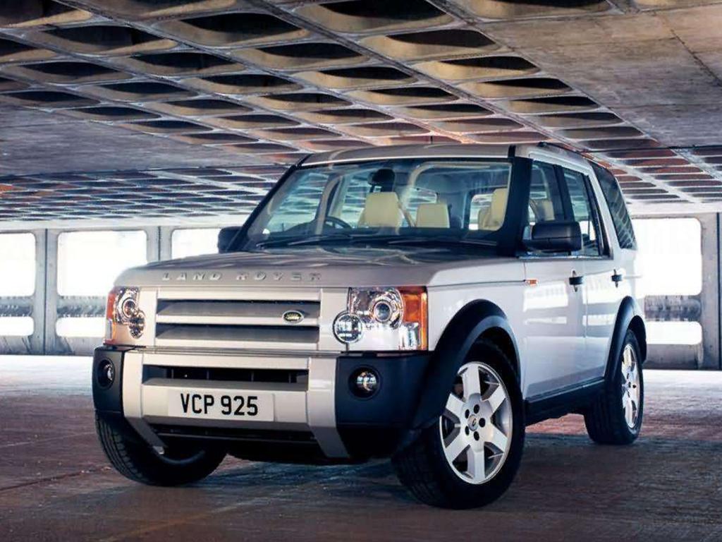

              Not ours, but similar to this..I think these are 19" wheels, ours is swapped to 18" for better tires.
Name:	2005 Land Rover Discovery 3 front view.jpg

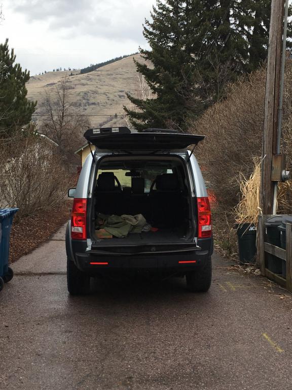

              So we replaced a front air suspension valve block. It's behind the passenger side bumper inside the fender liner. Cool little Voss hose connections on heavy nylon pressure hose. We'll see if we got the very slow air leak. Old one was very dusty inside with mis-matched o-rings. If it sits for a couple of days, the nose drops down too low and the compressor overworks constantly adjusting the height.
              Then we replaced an emissions gas fume pump between the frame and the body, above the rear axle. Some vapor canisters in the way and a ton of gas and vent hoses. No room to work at all. Pain in the ass, but we got it all hooked up. The electric locker rear diff is quite a monster.
              New windshield cowling was fun and easy. Built a little gorilla tape cover over the corner of the fresh air intake box. The corner of it hangs maybe an inch past the base of the windshield, so if you're parked uphill at al, water runs down the windshield and into the box on onto the carpet yay.
              Erased all the codes, we'll see what happens.
