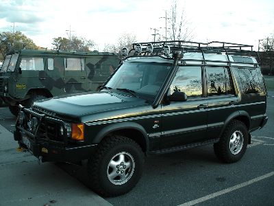

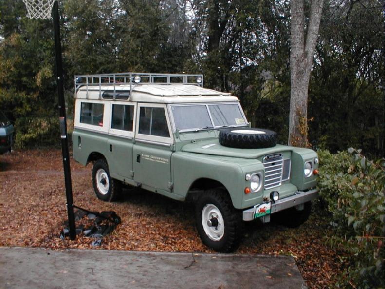

                          IMO, they missed the boat design-wise on this one. Looks like some Nissan or something. Note how the last 10 years of RR looks a LOT like the 1980 RR...classic lines, elegant, lots of glass.
                          The cool thing about the Discovery is they are the link to LR past. The flat shape on the hood is from the shape of the old Series hood. The hump in the roof is from the Series roof. The Alpine windows on the side are right off a Series. The rear door swings out like the old ones did, instead of a hatch.

                          The the LR3 / LR4 does a really clean modern take on the whole idea. They're big, but I like them.
